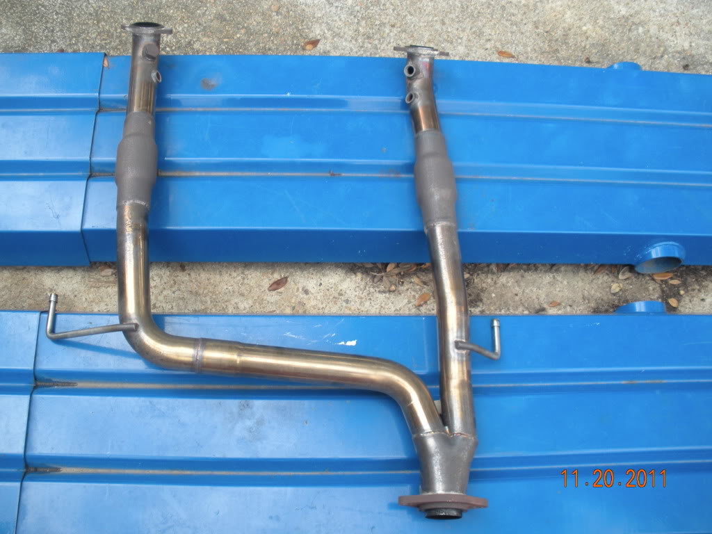

    see, i'm trying to ditch the header cats. one has gone bad, and i would assume the other will follow sooner than later.
    i'll talk to gadget about skid plate compatability, but the one i made a couple years ago routes in a similar fasion. i tucked it up for clearance, and then moved the crossover back to keep from toasting the ujoint and seal at the transfer case.
    i know it's probably punishable by death, but my best solution may be to chop up the urd and fit my original rear cats to it. :crapstorm:

    It has been done before. :thumbsup:
    http://www.xr-underground.com/forum/showthread.php?t=53424
    Factory cats filter the exhaust gasses better than high-flow cats, unless you get the OBDII compliant High-flow cats. Those aren't cheap.
    Just make sure to cut back on the openings of the cats, so that their O.D.'s match that of the URD Y. Which is 2.25" O.D.
