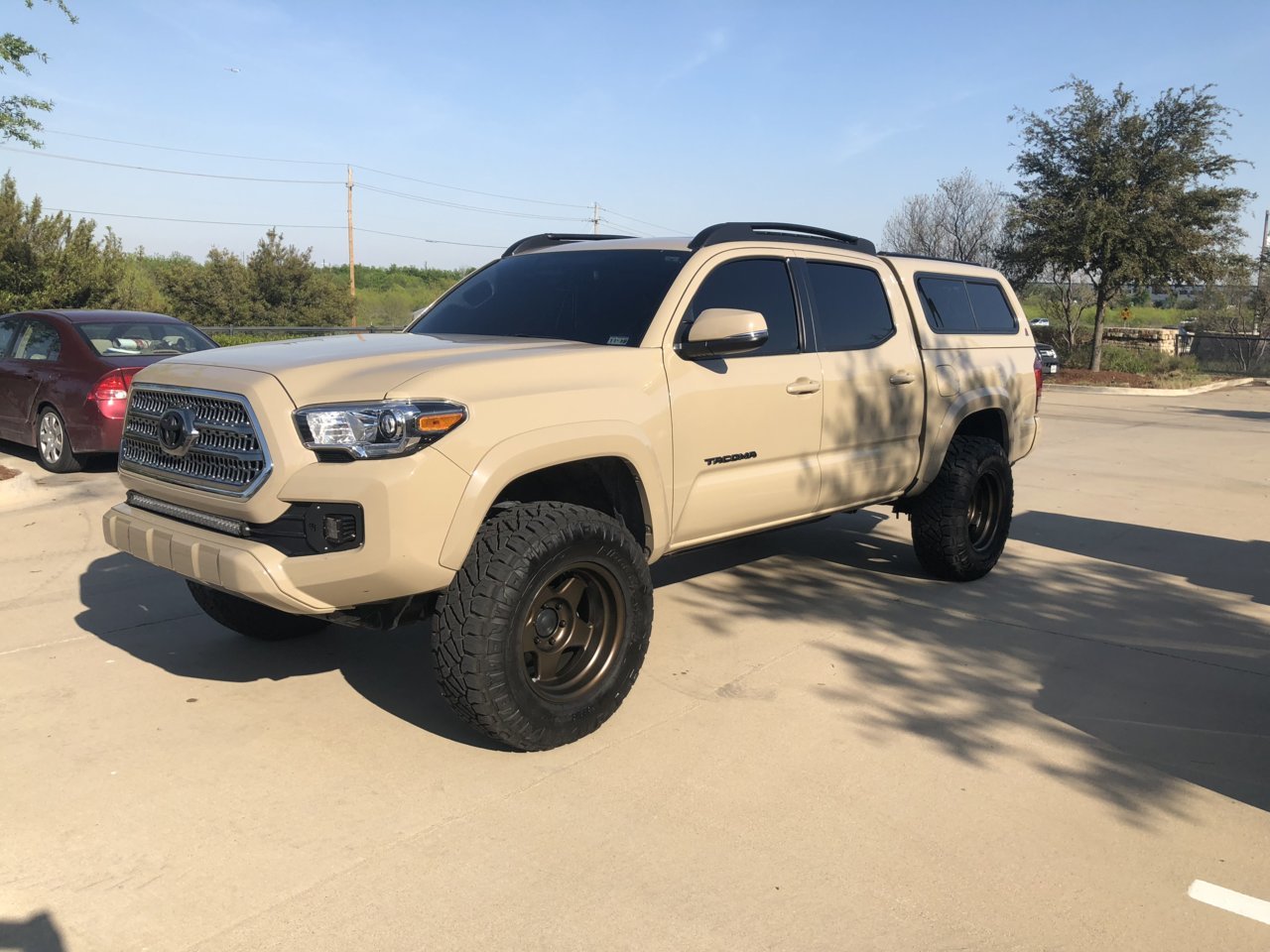

    17x9 -38. 285/60/17. 3” lift. Rubs, bad. Lol

    Only hits the cab mount at full lock. I cut out all the plastic that was causing the loud noises. I also just don’t care lol
