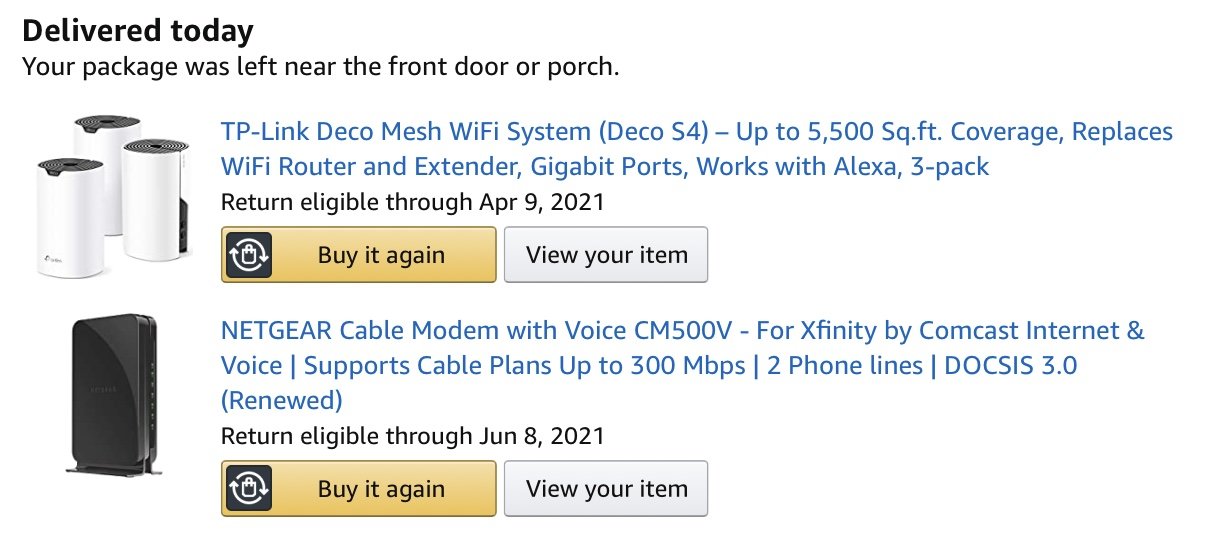

    I made the decision to replace the Comcast router/modem combo and get my own modem, and get the TP link mesh system. We'll see how it goes.
    My current setup is Comcast router/modem combo in the living room... phone base station plugged into that, 8 port switch plugged into the other port. Cat 5 going from that switch to another 8 port switch in my office. Both switches have multiple devices plugged in. In addition, tablets, phones and a laptop work off the wifi. The wifi in our offices is poor, hence the move to the mesh.
    So new modem, and the router will be one of the TP Link stations. The other will go in my office, connected to the switch and configured as an Access Point, connected via the ethernet to provide a backhaul to the router.
    I'll install this weekend. It will involve calling Comcast customer service to activate the new modem. Pray for me.
