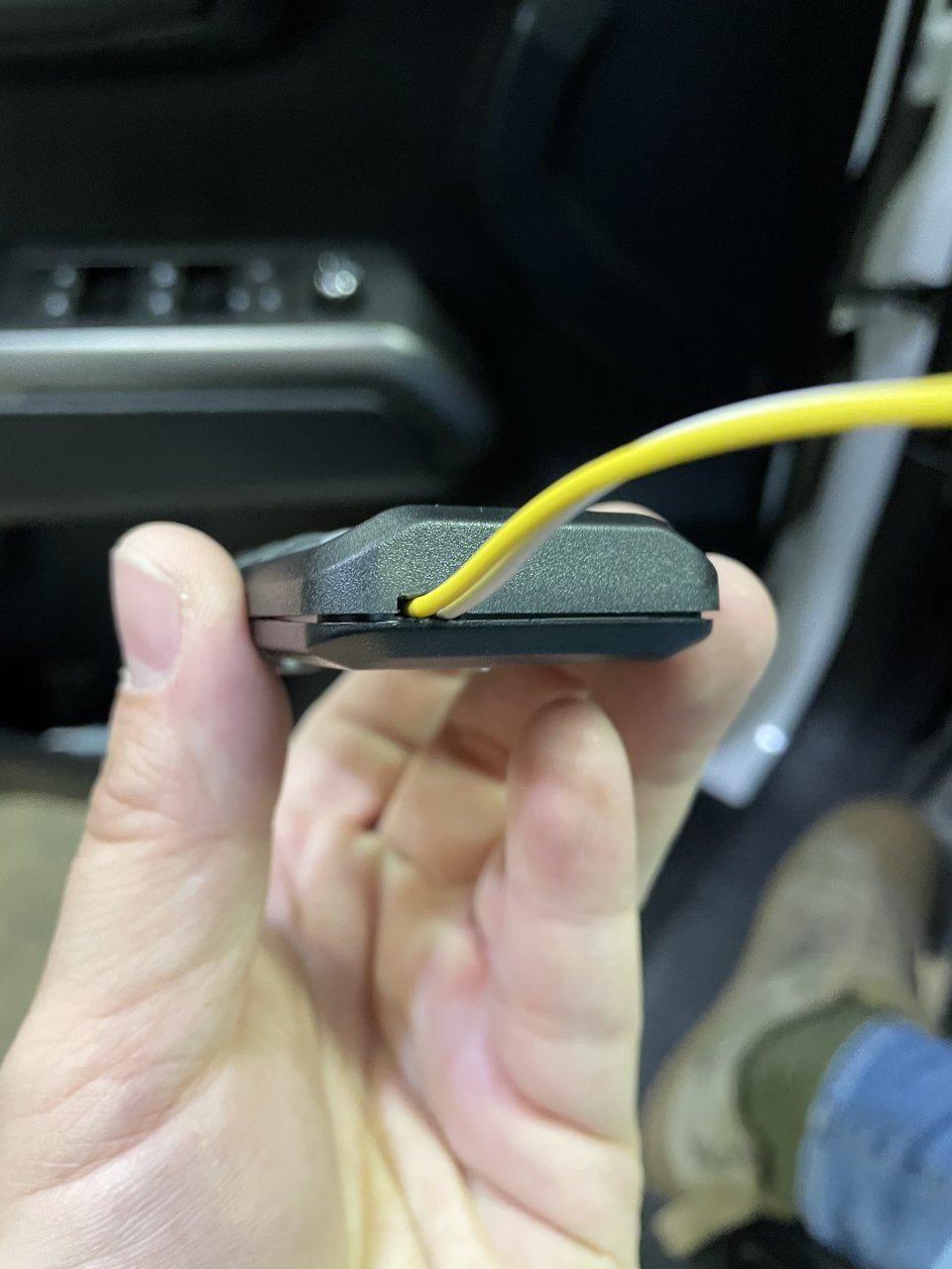

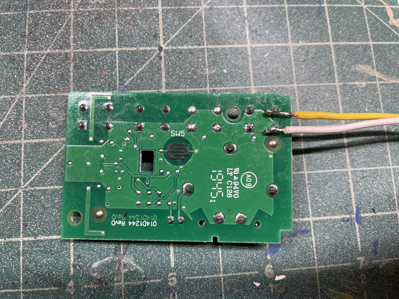

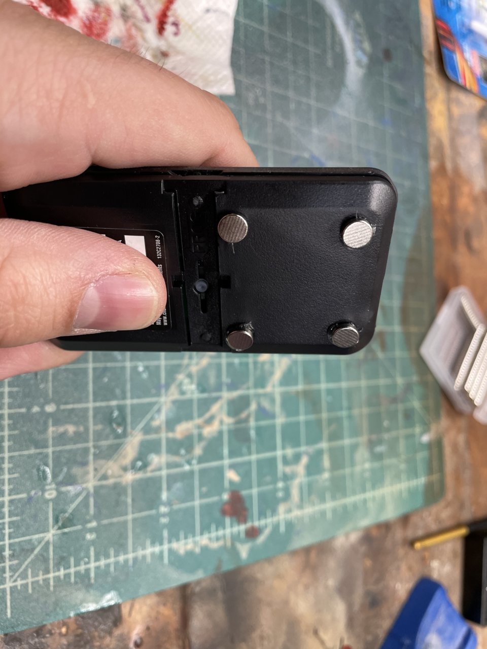

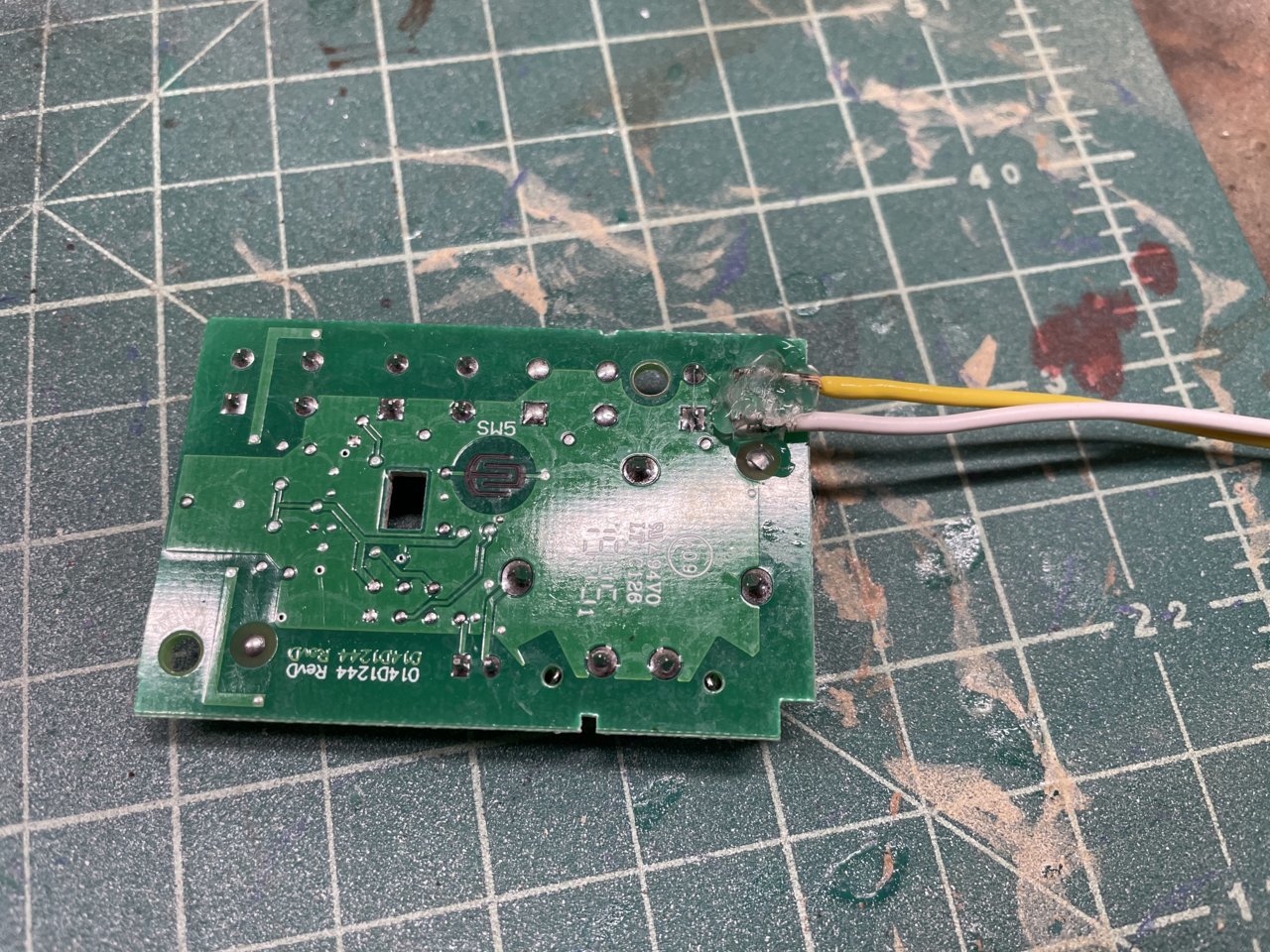

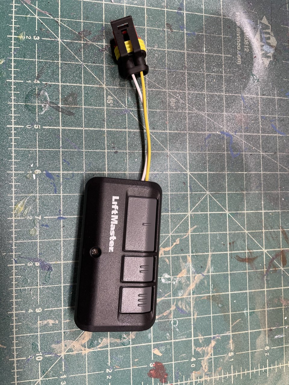

    So I installed my shift knob and everything turned out great. Left button triggers ECT of course, right button triggers garage door opener. I have the garage door opener stashed behind the climate controls and it’s magnetized to the bottom of the stereo mount.
    soldered
    hot glued
    case filed down
    Magnetized (added a 5th magnet since I only had this small ones)

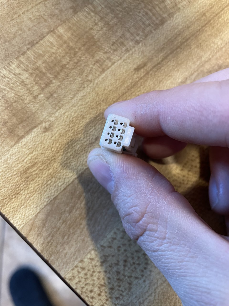

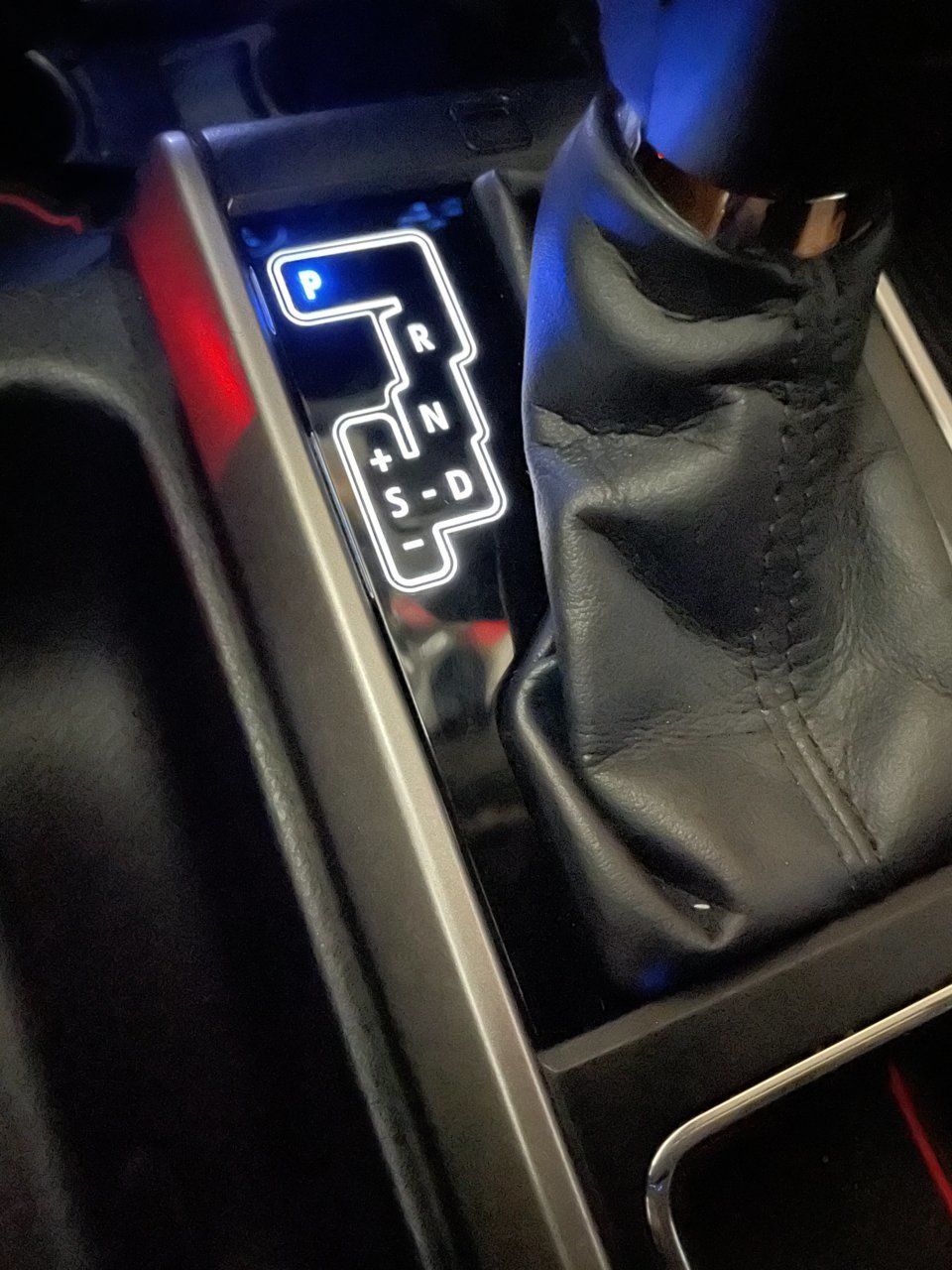

    So that all went smooth, pretty quick install, great results. The only negative thing (or positive depending on your perspective) was that I found this plug under the center console that was unplugged and also had 6 out of 8 wires cut.
    I was surprised to see this because ever since I bought the truck (used) I never had any inclination that something wasn’t working. After talking to the awesome engineer at Meso, he told me that this plug was supposed to light up a gear shift indicator and after searching YouTube I was shocked to see that this is even a thing
    I’ve never seen this light up and didn’t know it was supposed to. I’m still unsure if every Tacoma is supposed to light up or if it’s only for certain trim levels but I’m still going to try to replace this plug and find out lol.
    Here comes the worst part. This plug and pins, to the best of my knowledge, are extremely difficult to find. After tons of research the best I could find was this set online alibaba that takes 30-50 days to get after bought.

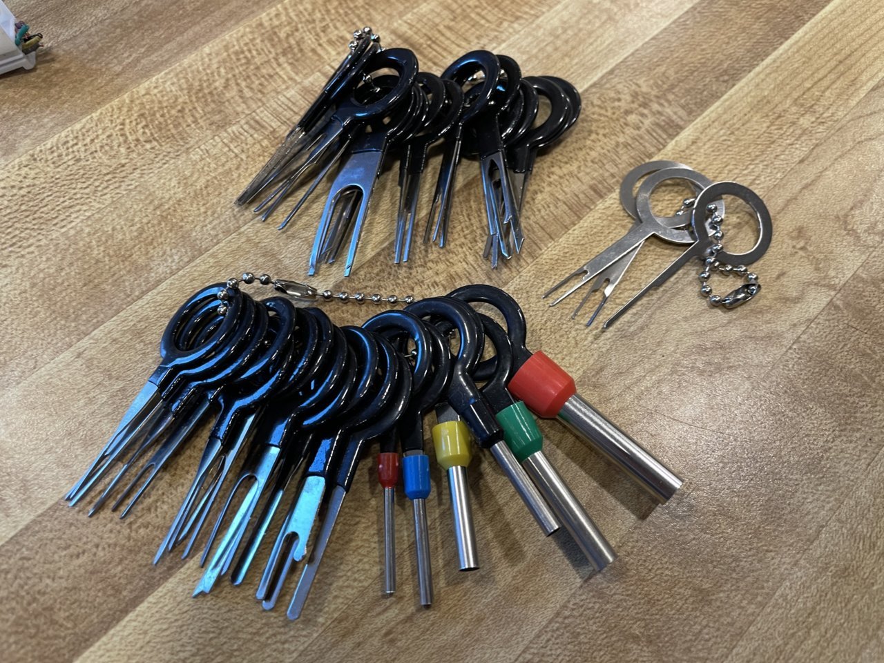

    So the alibaba kit (above) worked perfectly, it came super quick too - it took only 16 days. You'll only need the "female" set, get at least two sets so you have plenty of extras.
    I would recommend anyone who tries to do this fix to take your time and use the right tools. The pins are 0.7mm which is very close to 22 gauge so I would get a crimper that can crimp that small. I'll attach links to all the tools I used.
    https://www.amazon.com/IRWIN-VISE-GRIP-2078300-Self-Adjusting-Stripper/dp/B000OQ21CA/ref=sr_1_1?crid=2C0CHGT7L5N5K&dchild=1&keywords=irwin+vise-grip+wire+stripper&qid=1619283177&sprefix=irwin+vise-grip+wire%2Caps%2C190&sr=8-1
    https://www.amazon.com/IWISS-Barrel...d=1&keywords=b07476c1ld&qid=1619283289&sr=8-1
    With these two tools and parts I ended up spending as much as I would have for a new harness from Toyota but now I have the tools for life and I'll use the wire strippers all the time on house projects so I think for me it was better to go this route. If you're less capable or don't want to mess around just try to order the harness (above) for $35-$45 and hope it's what you need.

    If you’re stuck, looks like you could easily dep-pin the plug and solder the wire back, since there is more than enough “meat” left on the pin side to get a good connection. That’s assuming it connects to a pcb, if it simply connects to another plug with wires, cut both ends off and use any connector you like. (Preferably not the style you used for the garage door opener)

    Yes I was thinking about saying that, @xLOGREx I have a full set for depinning computer plugs, do you have a pic of the other side of the plug? I would send you my tools to use if you wanted to try it.

    And here’s a picture of the other side of the pins A34018EC-D4CC-44BA-B418-1DE8F72D2837.jpg I’ve tried depinning them with this and have struggled so far. I’m sure that once of these tools should work.. maybe I gotta keep trying. Have any pointers?

    They should be something like this, and it would also help to push the wire side of the pin in tight as you push the depinning tool in the other side, and when you think it might be hitting the tab then try to pull on the wire side

    for Automotive connector, search “DT Series Connectors”, they are the best. There are plenty of quality licensed (and probably unlicensed) knockoffs, so you don’t need to buy DEUTSCH, but they are really not expensive. Something like below will probably be all you need for you next 10 projects. (You’ll also need a set of crimps, but they are also cheap)
