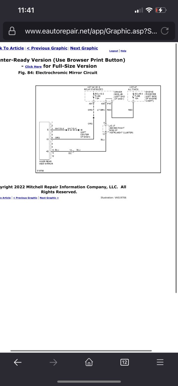

    My rear view recently stopped working as well. If it’s not these fuses *, I’ll be curious what the fix is as well. Whoever fixes it, please take good notes!

    Yeah all these fuses seem to be OK. The ECU IG2 and the other. Very interesting. Although those were the ones to fry initially.
