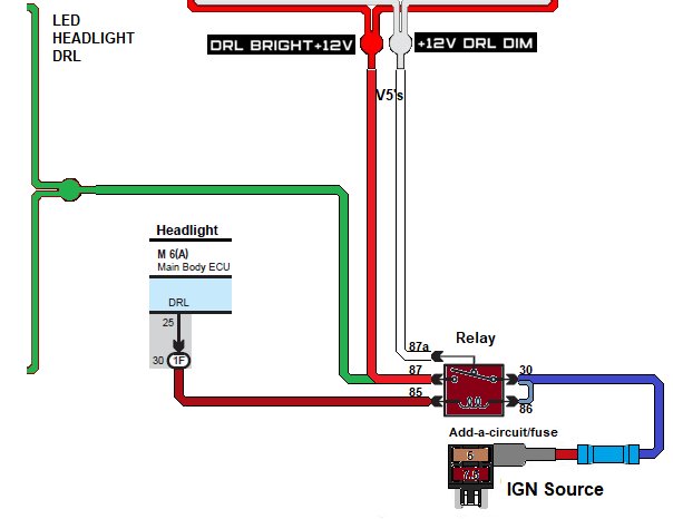

MESO V5 DRL incab "connection"

    So is this right? Just DRL on, headlights and v5 bright with both solutions. Turn the parking lights on, v5’s will then dim via headlight T and stay bright with in-cab? The low beams on, v5 will be dim with both?
    I always have DRL on and auto headlights, so I guess I’m not sure if my parking lights are ever on by themselves. Haven’t paid that much attention to how it all acts.

    Correct

    Ok got it. That will bother me less than the timing being off between the headlights and mirrors, so I guess I can deal with it lol

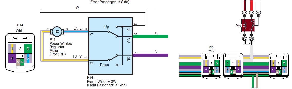

    For SR/SR5 that want to change to 2020 LED headlights and have the MESO V5's

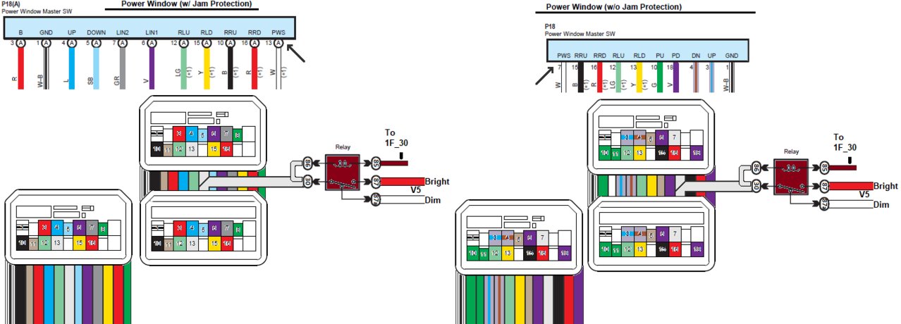

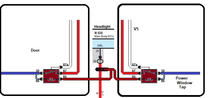

  15. Dec 4, 2021 at 1:32 PM
    #35
    caribe makaira
    caribe makaira [OP] Well-Known Member
    Feb 13, 2011
    #51121
    11,817
    Caribbean, Puerto Rico
    05 PreRunner TRD Offroad AutoTrans
    Hood Struts, My version Fogs always ON, Map & Overhead Light Mod,
    Another option:
    Place a mini relay at each door (under door switch panel) and run only one wire per door to connector 1F_30.
    Tap power window fuse for juice. (There are options for a intercept harness so as not to cut the vehicle harness at the door. Passenger's side.
    Driver's side
    Posi-tap at 1F though...
