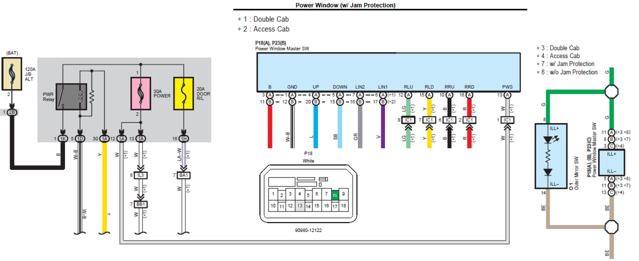

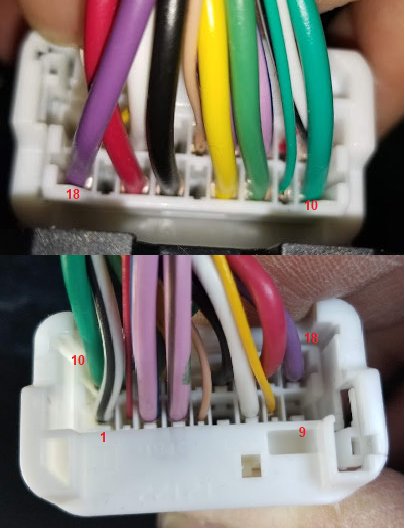

    Another location tap option at Driver's door for PRO/OR with Jam_Protection Windows.
    P18_13 WHITE to V5 RED
    P18_8 GREEN to V5 WHITE

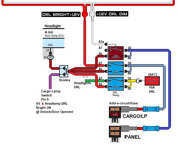

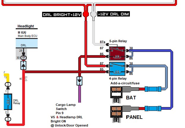

    Over built iteration:
    V5 BRIGHT RED to 4 pin relay-Parallel to Headlight DRL Relay. Fused to battery.
    V5 DIM WHITE to 5 pin relay- Fused to PANEL circuit fuse.
    At IGN V5 are in parallel with Headlamp DRL. Dim relay has no power to actuate the coil.
    At TAIL/PANEL select DIM relay is actuated, but NO pin not connected to Dim wire, so DIM is OFF.
    When Low Beam selected, Main Body releases ground trigger to all relays here. DIM relay switches to NC and energizes via PANEL circuit tap.
    All this is as OEM DRL functions on Headlights.
    BAT add-a-fuse is "blank"-choose your source, I recommend Cargo 7.5A circuit.

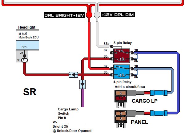

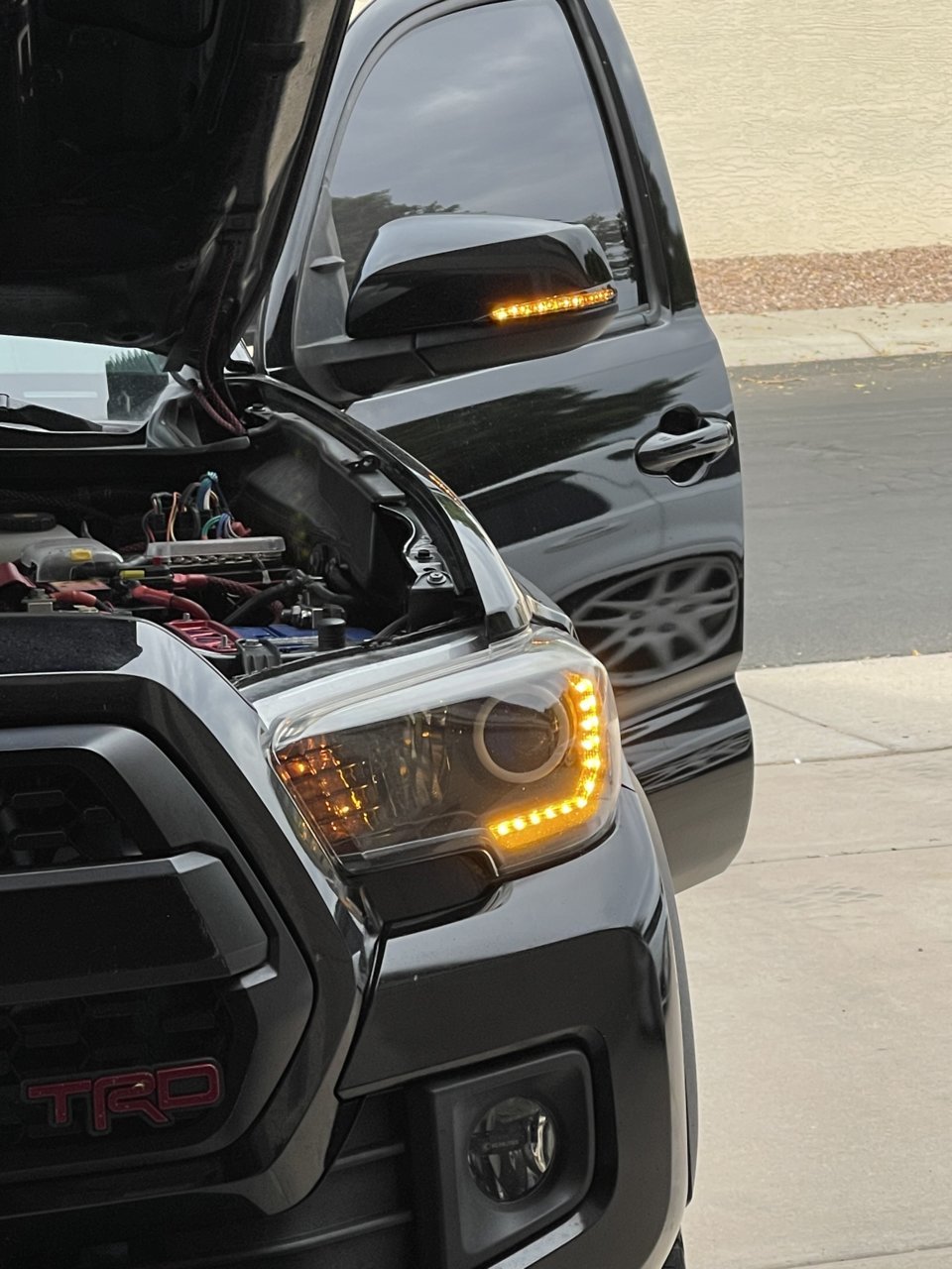

    Mall Crawler:

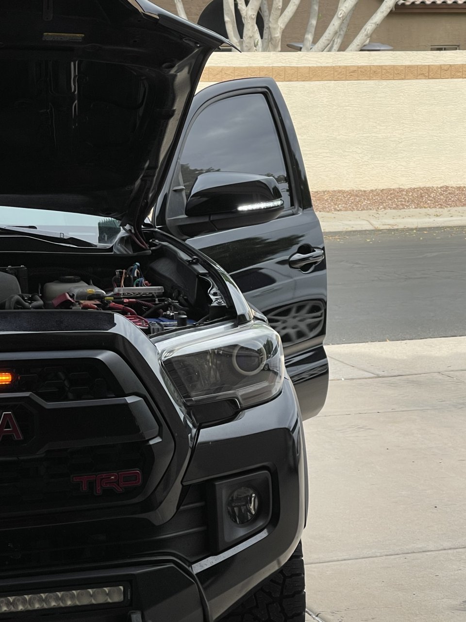

    SR with Halogen DRL's (and added Door Mirror Turns Signals)

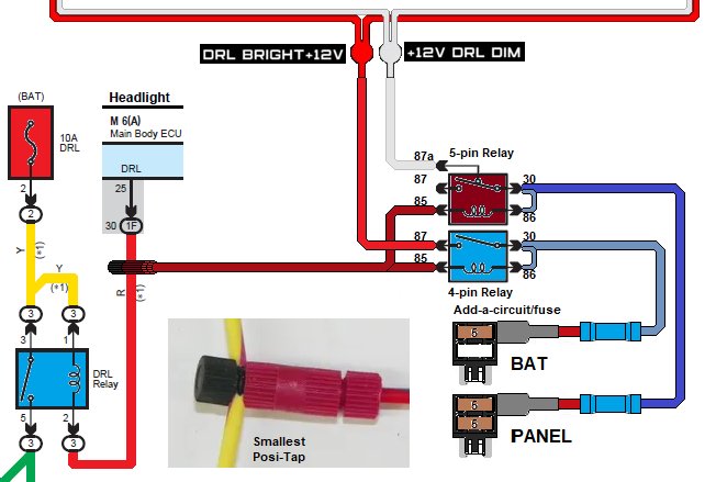

    Visually Revised-Mall Crawler:

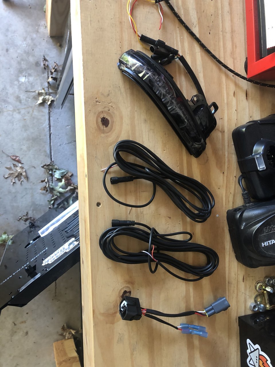

    Did you order the pigtails to connect the V5's to the puddles?

    2017 - MGM - Sport - 4x4
    Whoa. Where did those come from? Haha
    I only got the pnp harness
