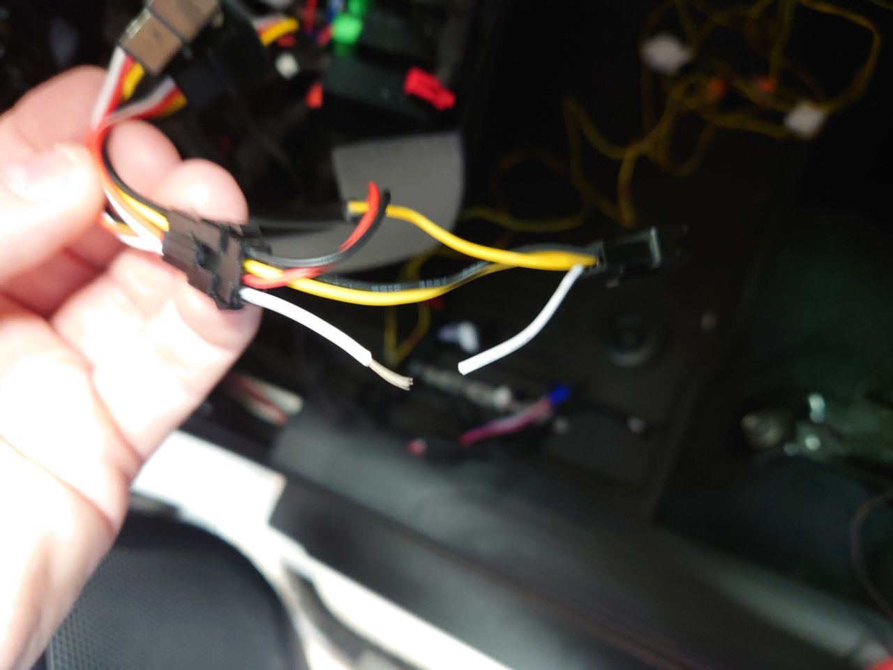

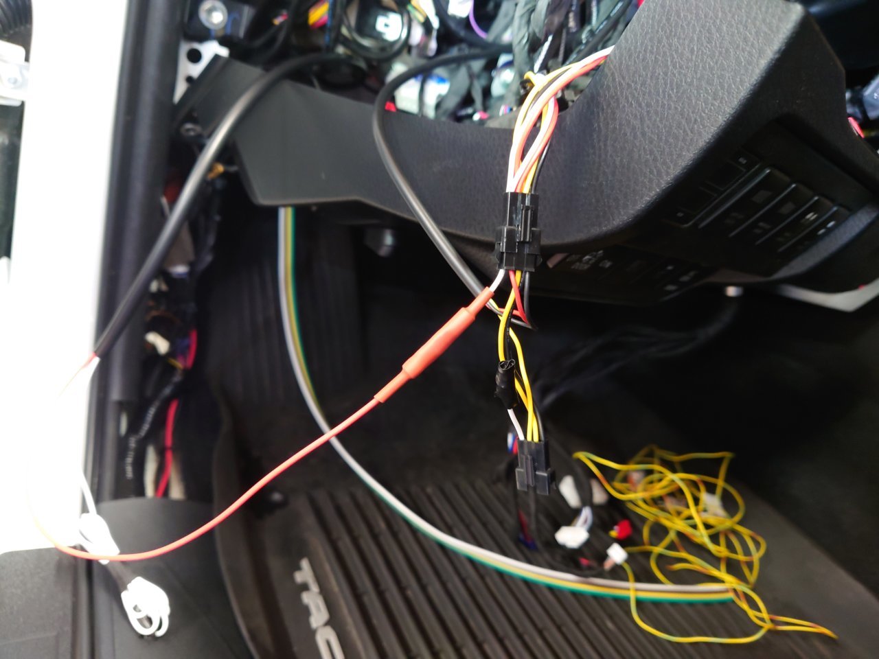

    Finally got mine installed today. For those who have V2 puddle pods but want the DRLs to mimic the headlight functionality (instead of always being on when the ignition is on), you can simply "convert" the ignition signal within your puddle pod harness to a DRL signal instead.
    Start by using any one of the available headlight t-tap harnesses that grab the DRL signal from the headlight plug (you can use the Meso one that is available with the V5s. I used the one that @daveeasa makes). Connect that between the headlight plug and then pull the wires up through the firewall and into the cab. You really only need the "red" wire, which feeds the "bright" portion of the DRL signal, because the puddle harness already has the "white" (illumination, or "dim") circuit built into it. However, I pulled both of the wires from the headlight tap through the firewall and just capped the white one off, because you never know when you'll need another illumination circuit inside the cab. :)
    Then, you need to access the puddle pod harness right before the "Y" connector that splits off the two separate runs to each door. If you have the puddle pod switch, you can do this within the short plug/harness that connects to the "Y" connector and runs off toward the switch. Otherwise, you'll need to tap into the portion of the puddle harness that comes down from the plug in the a-pillar. The white wire within the puddle harness is the circuit from the ignition, and this is the one that you need to intercept and "convert." Simply cut the white wire and connect the red wire from your headlight tap to the side that feeds into the "Y" splitter. Don't forget to cap off the other side of the white wire that you just cut, because it's a live "ignition" circuit, and you don't want it to ground out against something metal and blow a fuse.
    And just like that that, you can use the wires that are already inside your mirrors (that you ran when you installed your puddle pods), because those wires now bring the correct DRL signal into the mirrors instead of an ignition signal. Sorry for the poor quality photos, but here's the wire that you tap into (don't mind all the other wires in the background, as I was wiring up some other projects at the same time):
    Here you can see the white wire that I cut (sorry the focus is so bad):
    Here you can see how I connected the red wire from the headlight to it, and you can see the other side of the white wire capped off with a good deal of electrical tape. I just used a crimp-style butt connector, and secured/protected it with some heat shrink tubing:

    You should've/could've followed post #203. No running wires to n fro the engine n cab.

    I thought about going that direction, but I was already pulling a few other wires through my firewall (for some roof lighting) and I had the t-harness harness sitting on my desk from @daveeasa. I didn't have a spare relay lying around, and this method only required one butt connector and some heat shrink tubing. I'm just happy that the DRLs aren't "on" all the time, and that I didn't have to pull new wires through the door boots!
