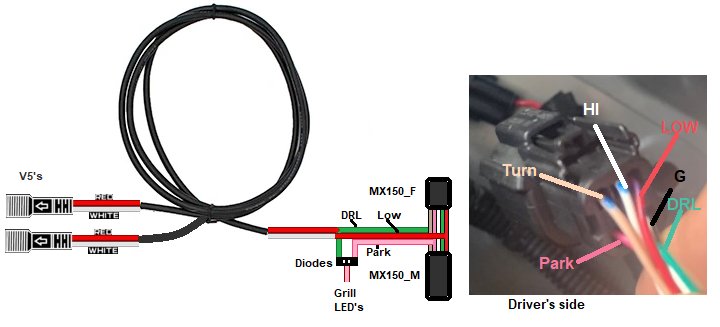

    V5's Stay Bright until Signal tap from Low beam, then Dim. Grill Lights On with DRL, when Low is selected they continue to get juice from PARK. Diode separates DRL from PARK.
    @mokeiko "style":
    V5 are DIM at ignition. Bright with HIGH Beams.

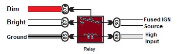

  12. Jan 19, 2022 at 8:16 AM

    Adding a wire to the DRL circuit on the stalk to activate the added 5 pin relay makes mute your DRL stalk selection issue.:burp:

    Once DRL input (Bright) is gone, HIGH Beams tap switch relay to juice the BRIGHT wire of V5. Diode to prevent backfeed to HEADLIGHT DRL's. (Bright)
    daveeasa[QUOTED] likes this.

    Nice little diode there, gets it done! Very cool.
    ETA: Oh, but just FYI, the red is DRL and white is parking light on the v5's, so red bright and white dim. At least as far as I know and as far as I've been building them based on the one I bought.
