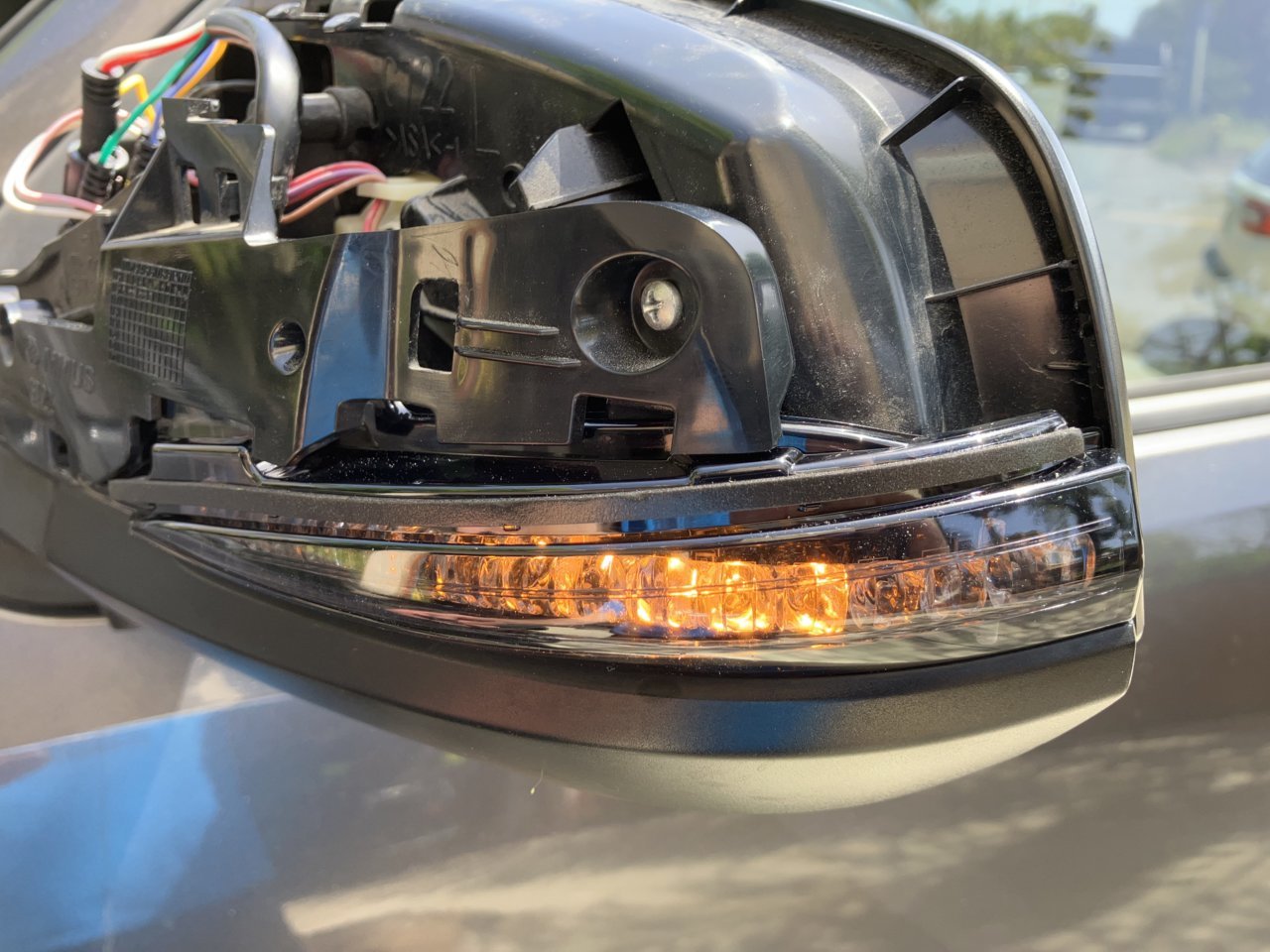

    Anyone know if this is “expected”? Or is the amber supposed to wrap to the side edge like my cheapo sequential do?
  3. Apr 9, 2022 at 2:07 PM
    #383
    Tacospike
    Nov 19, 2018
    #273198
    14,419
    512
    Two Trucks
    Faulty light. Should wrap all the way across

    ‘21 Army Green Tacoma TRD Off-road DCSB
    That is how my initial ones showed up. It was a known fault in some of the boards being pinched in the sealing process. Meso was good about sending me a replacement

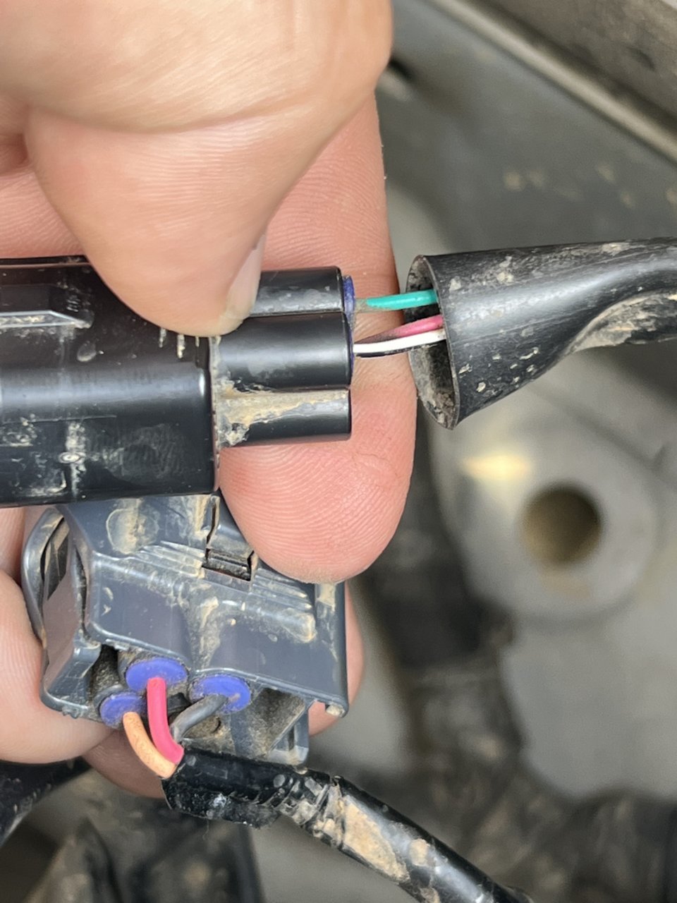

    Greetings all! New to the forum I just wanted to thank everyone for all their insightful info on this mod! I’m receiving my pair later today and decided to hook them up to direct power. My question for you guys is can I tap directly into the harness that powers my DRLs? It’s a three wire harness. Pink, green, and a white/black wire.

    I installed just one light on my passenger side using single t taps and wired the red to pink and white to green they are running at all times but I don’t notice a bright or dim change when I’m switching my headlights on or off

    Yes if you like doing that sort of thing. MESO sells a $15 T harness to avoid having to cut. I sell more expensive stuff to do roughly the same thing but also other things too.

    There should be two wires each to tap. One is bright and the other is DIM. If you only tap one wire you only get one mode, only bright or only DIM

    The red and white wire that go to the MESO adapter at the headlight, if I hook them both up, my DRL‘s are dim …however, if I disconnect them and then I take my red wires and connect them to the white wire at the MESO adapter at the headlight they are nice and bright. Can I just leave the red wire connected to the white wire? Seems to be working fine
