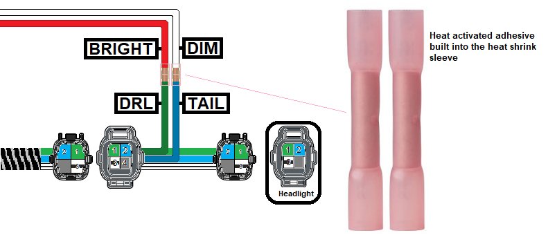

    This diagram does me no justice, I’m using the MESO adapter at the headlight,

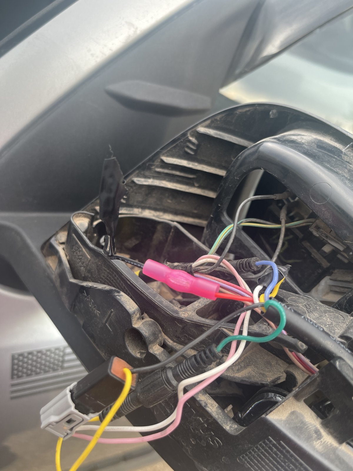

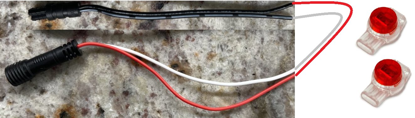

    This is how I have them. Striped black wire to red and solid black to white

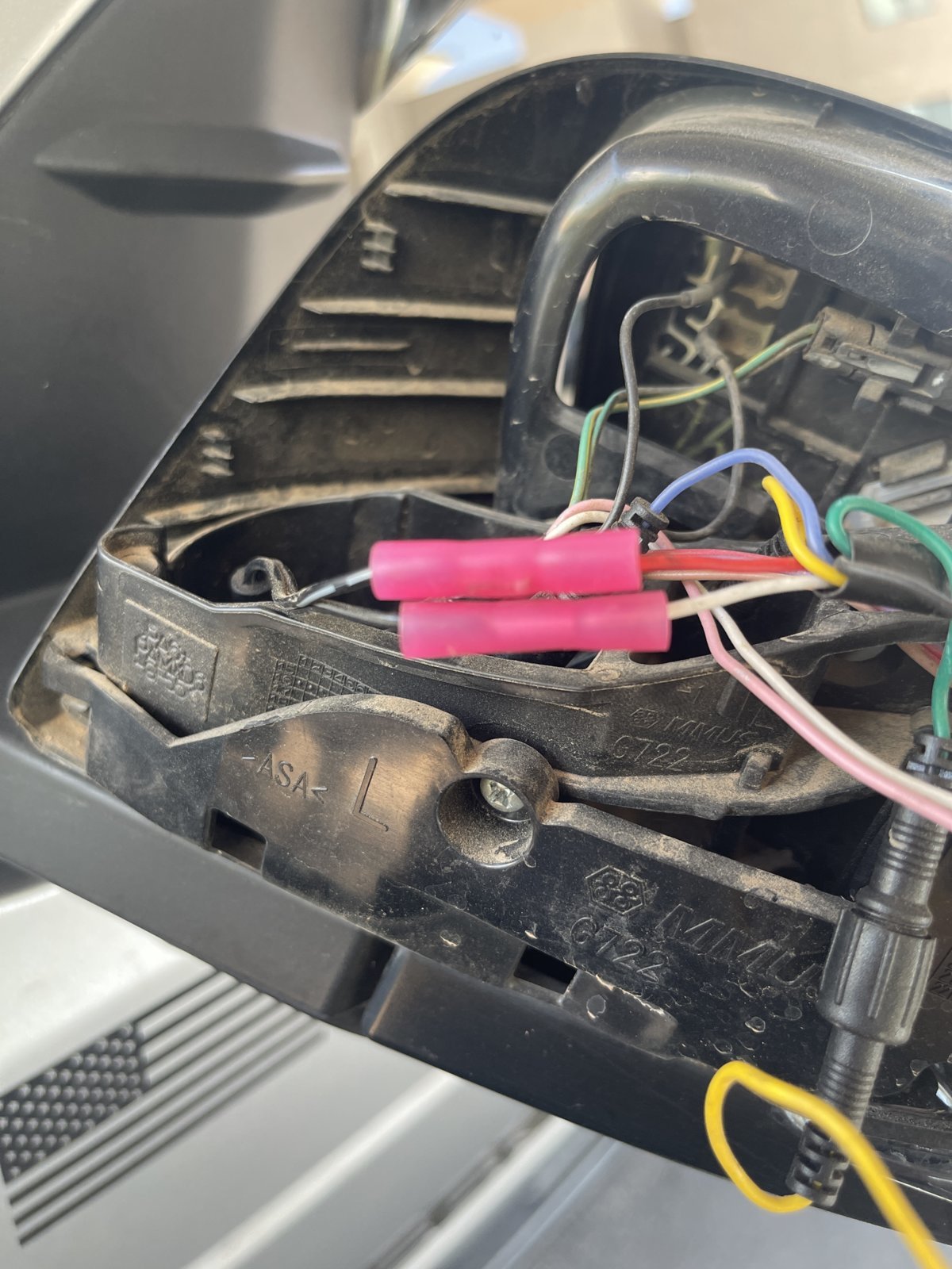

    I posted a picture. Does it look inverted ?

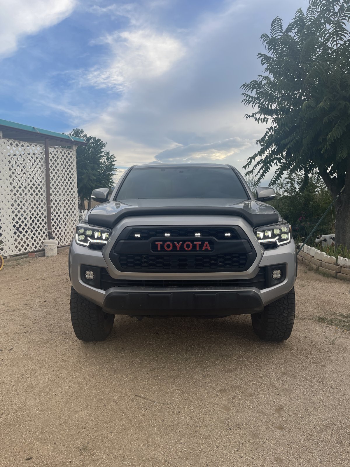

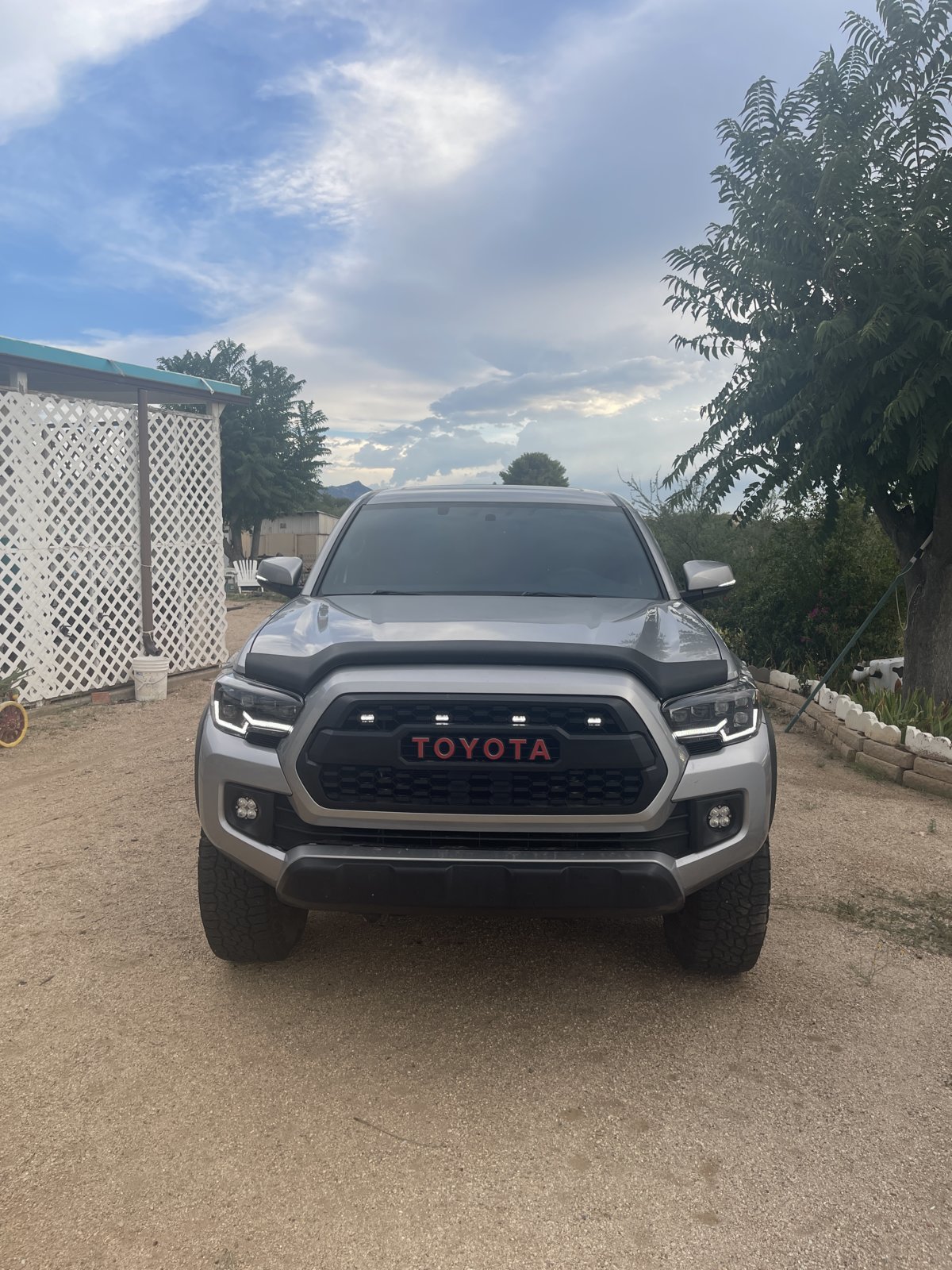

    Finally got around to it and not only did I have the wires backwards, hence why it was bright with headlights on but dim with DRL. I then saw posts saying connecting only one pair of the wires together and not both have them stay bright all the time so I just messed with them and they stay bright now. :) Pictures show driver being bright and passenger dim, then both being bright with DRL and headlights on. I connected only the solid black wire to red (I have the puddle pods pigtails)
