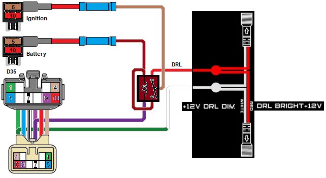

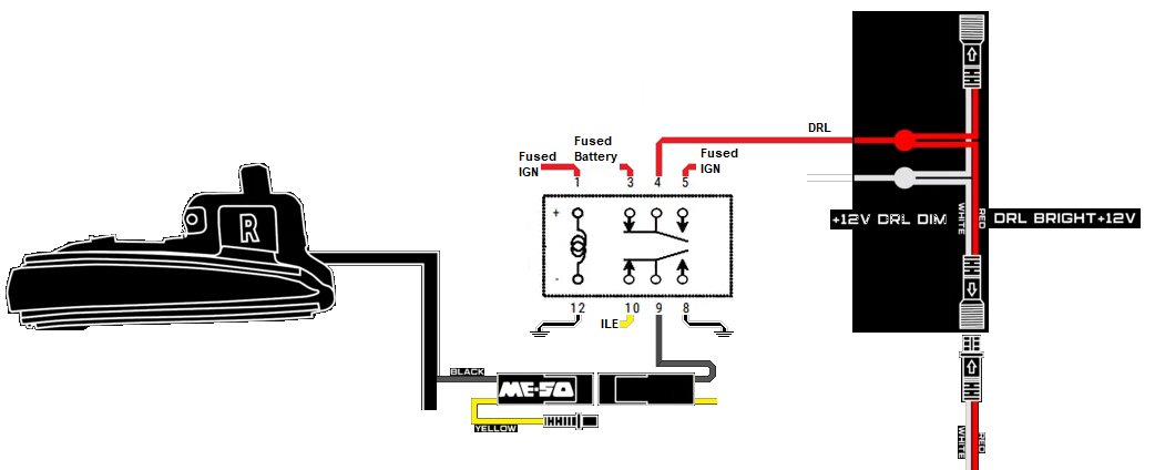

    This would accomplish what you want:
    But you would loose the Hazards and Unlock Blink when vehicle is OFF. Don't know if vehicle inspection requires/includes the mirror turns.

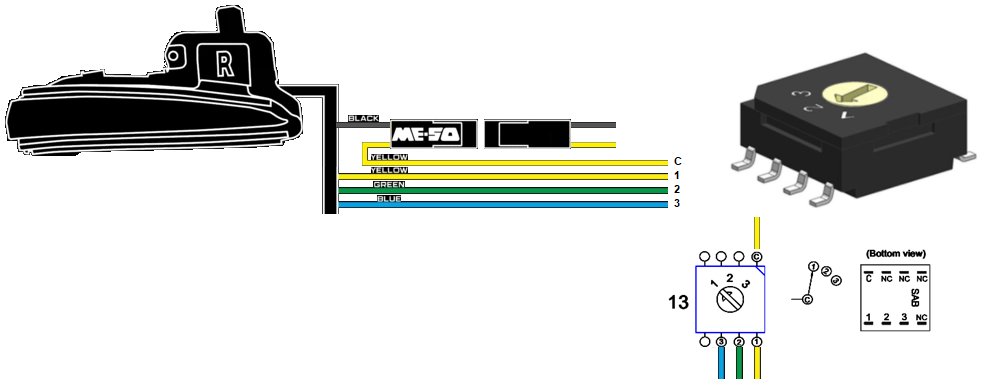

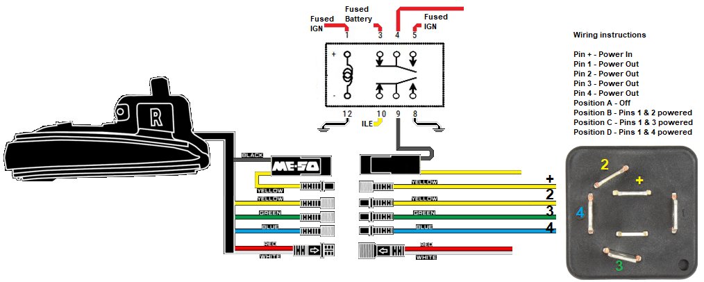

    Doodle...Rotary switch for feature select. One per side.
    Too many wires to exit the mirror housing into the cable orifice of the door...
    22/4 cable to Driver's & Passenger's door controls...to rotary micro switch...

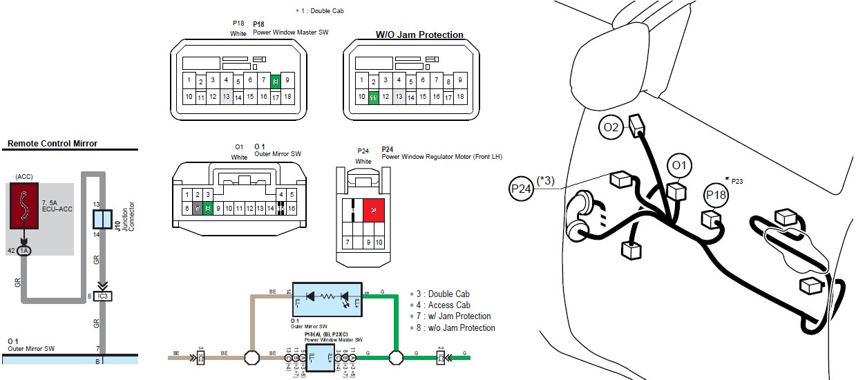

    Fused IGN at the various door connectors for the DRL High & Low inputs.(switch illumination)
    Edit:
    On P18 with Jam Protection feature the IGN source is pin 13. Pin 3 is Battery Hot always.

    So us no puddle guys, could tap into one of these wires for the drl versus to the engine bay?

    For your setup you could've just tapped the illumination wire on each the door switches.

    Hmm, I like the thought of not having to go through the door boots!:cool: How would one find this magical illumination wire?
