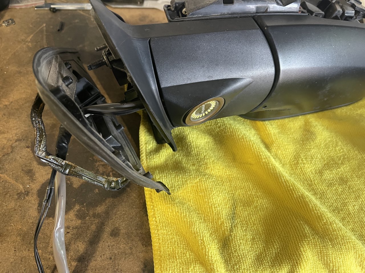

    Nick
    YMH
    Black '17 OR
    One side done. Apparently I have V2 puddles.

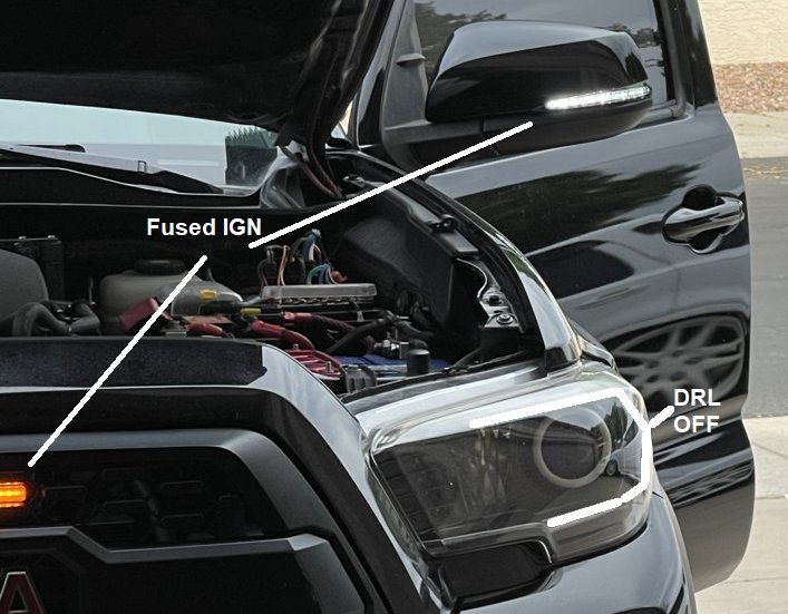

    Zee izzue iz the TAIL input...I zink you have ze Bright n Dim wirez inverted

    IGN iz not = azz DRL...:boink:

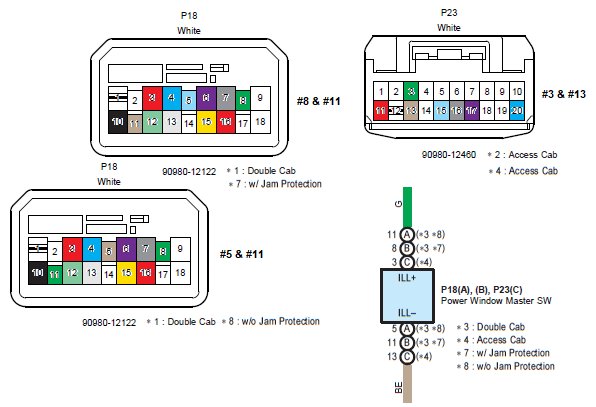

    My illumination isn't working for some reason. I opted for IGN to bright until I can pull the A pillar apart and trouble shoot

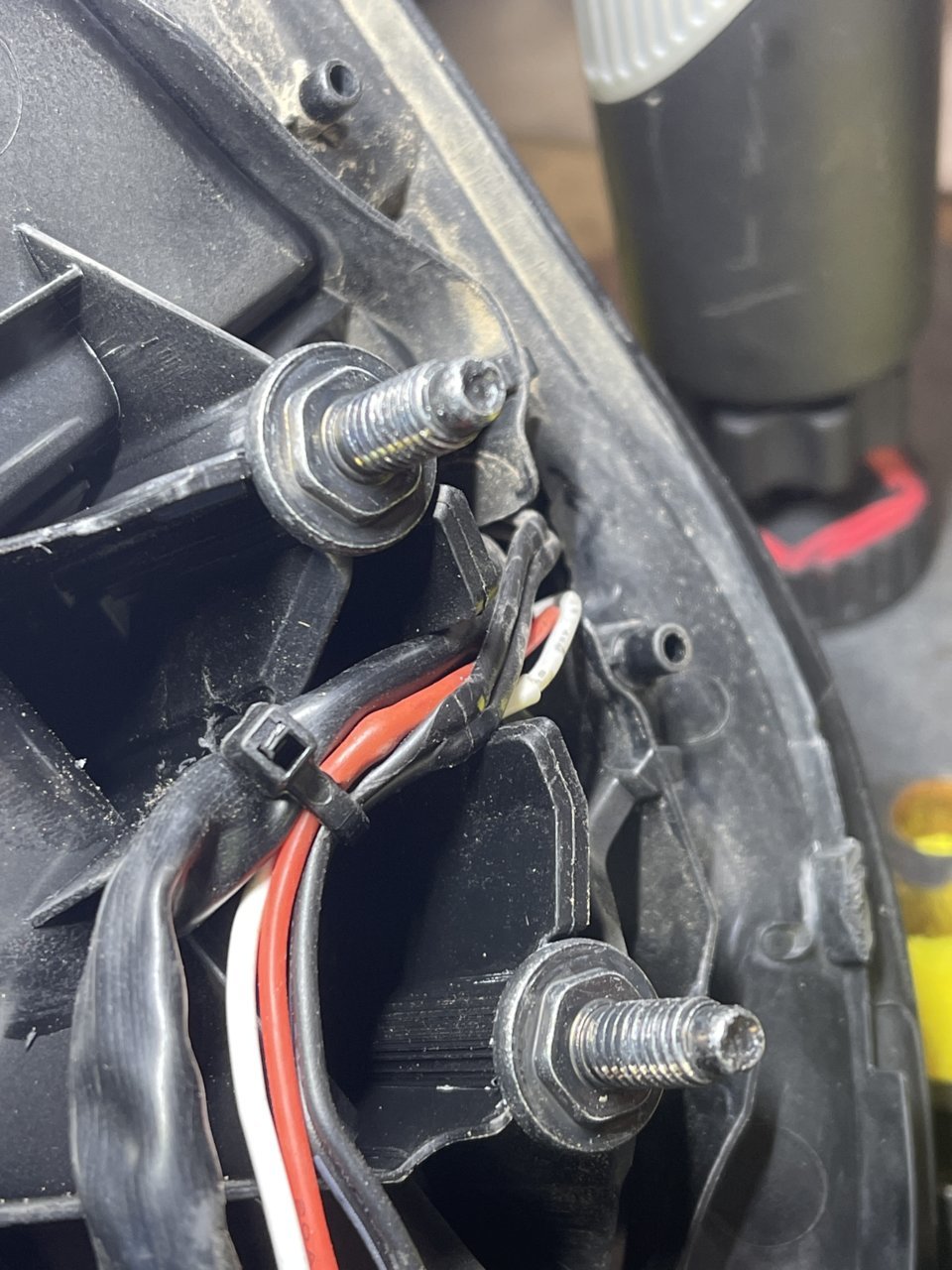

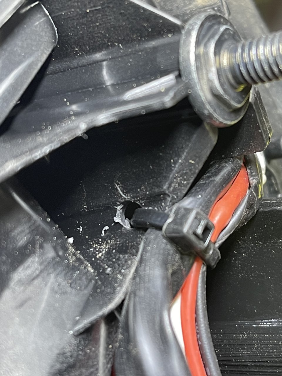

    Install note, I drilled a small hole for a zip tie, to keep all the wires organized in the pass through. So nothing gets pinched.

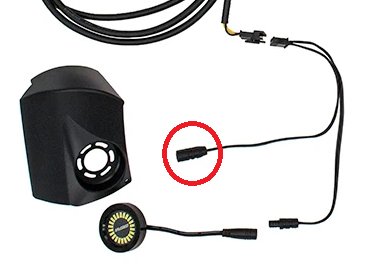

    @Skydvrr , did you noticed that the extra puddle harness at the lamp is compatible with the DRL plug of V5?
  19. Sep 25, 2021 at 9:45 AM
    #99
    Skydvrr
    Skydvrr IG: @kalopsianick
    Sep 13, 2017
    #229889
    12,654
    Nick
    YMH
    Black '17 OR
    Whatcha mean?
    Tacospike likes this.
  20. Sep 25, 2021 at 9:47 AM
    #100
    caribe makaira
    caribe makaira Well-Known Member
    Feb 13, 2011
    #51121
    11,715
    Caribbean, Puerto Rico
    05 PreRunner TRD Offroad AutoTrans
    Hood Struts, My version Fogs always ON, Map & Overhead Light Mod,
    Tell me you didn't snip it off...
    @MESO is the V5 DRL connector a match to the puddle pigtail?
