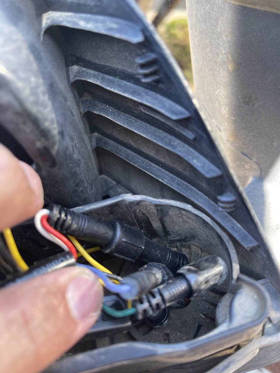

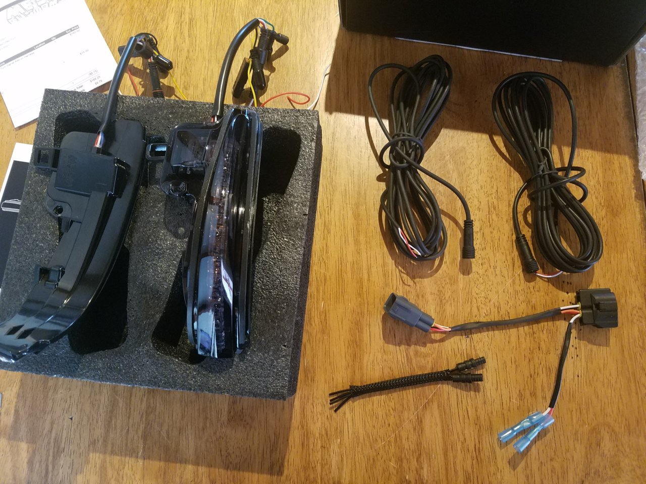

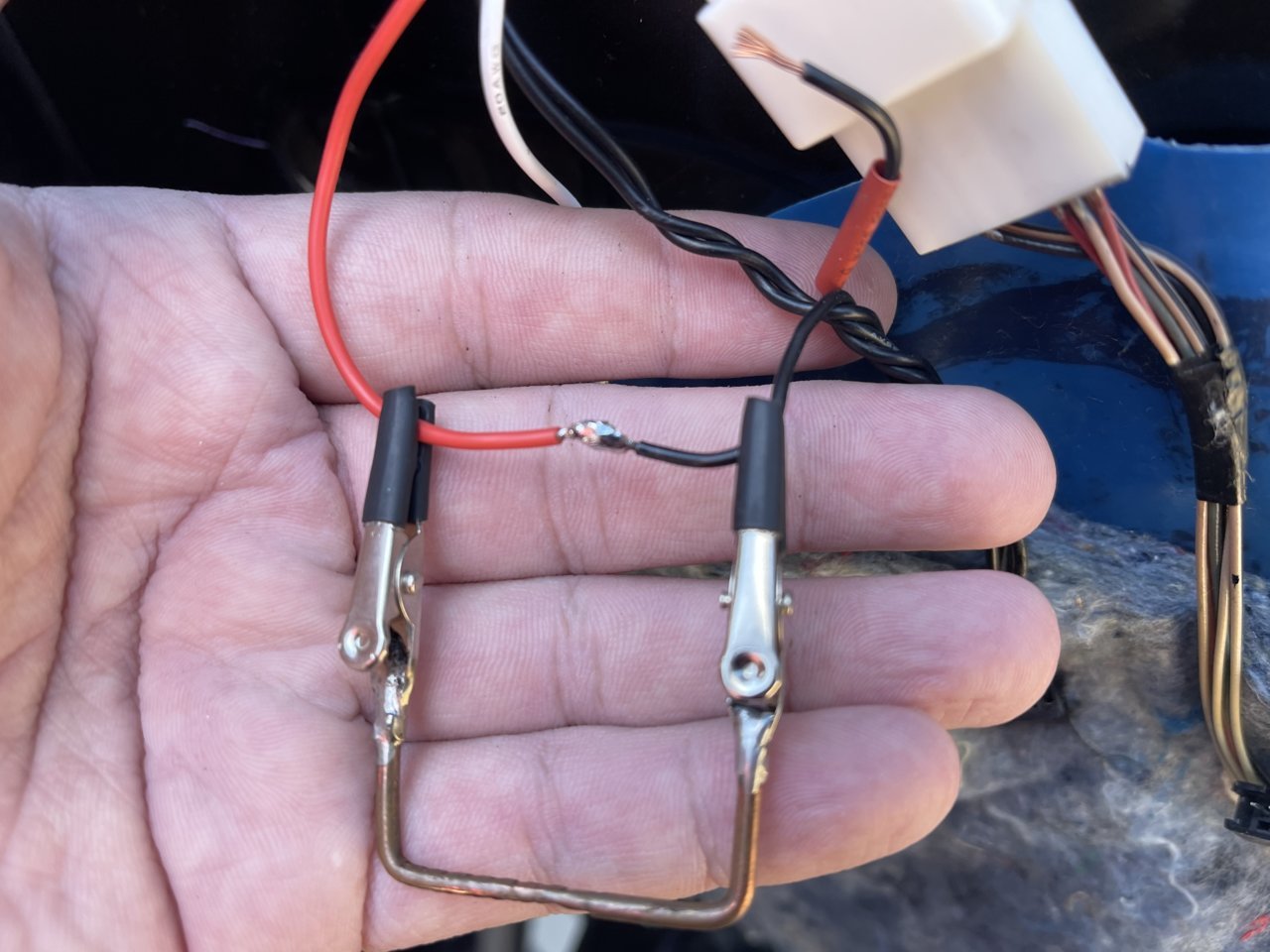

    My puddles weren't like that. Just two snipped wires with heat shrink on the end. Meso supplies the v5 turns with the necessary plug. I just lengthened the leads of the plug.

    Anyone here have the puddles like in post #100 and also have the V5?

    I guess technically mine are like that. But The plug wasnt connected / shipped with the puddles. It came with the V5's and I soldered em up. Also, I never bothered with the DRL extension that meso ships w the V5's, so maybe that plays a part.

    That is why I asked the Q.
    Just looking to verify that the plugs are compatible/same for the "fix".:burp:

    She done. Just 100% bright with IGN on. I went with the blue plug for the sequentials.

    For your IGN power in the door? I don't see any reason that's not possible. White wire is 12+ in the driver's door right?

    That is correct, but the Team has a solution for those with the added pigtail like the pic. I don't have the puddles, so I'd like confirmation from those that do have that version and the V5's.

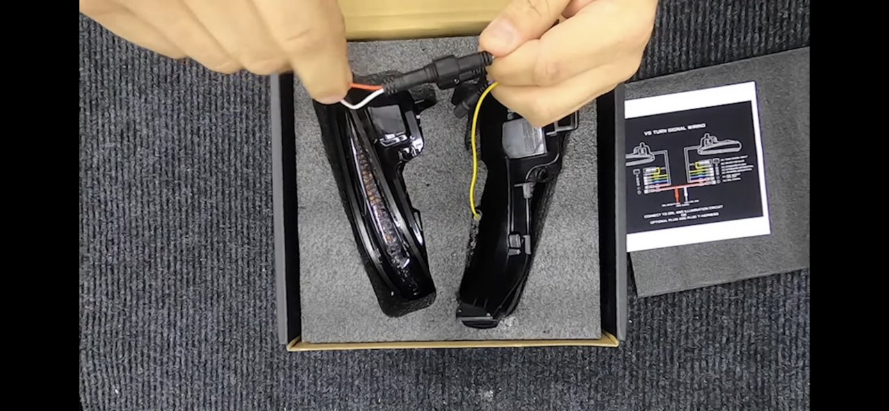

    Yeah I'm pretty sure meso is shipping the correct connector with the V5's. If you look at his unboxing video, you can see it plugged in.

    There is no doubt that the DRL pigtail matches the V5, what I do not know is if the DRL connector on the V5 mates to the PUDDLE harness extra pigtail...:bored:

    @MESO
    If Puddles NO than DRL pigtail.
    If Puddles YES than NO DRL pigtail, mate to puddle connector.
    Correct?

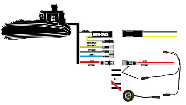

    They're not the same. @MESO supplies a loose plug for the DRL's, and the 2 pin connector to mate them to the Puddle Pod Extras. See plug with braided shield below for the puddle pod connector:

    So if owner has puddles with the pigtail, snip the DRL connector from the V5 and crimp the shorts...:thumbsup:

    Negative. Meso supplies a pigtail plug already connected to the DRL plug with short lead wires for dim and bright DRL.
