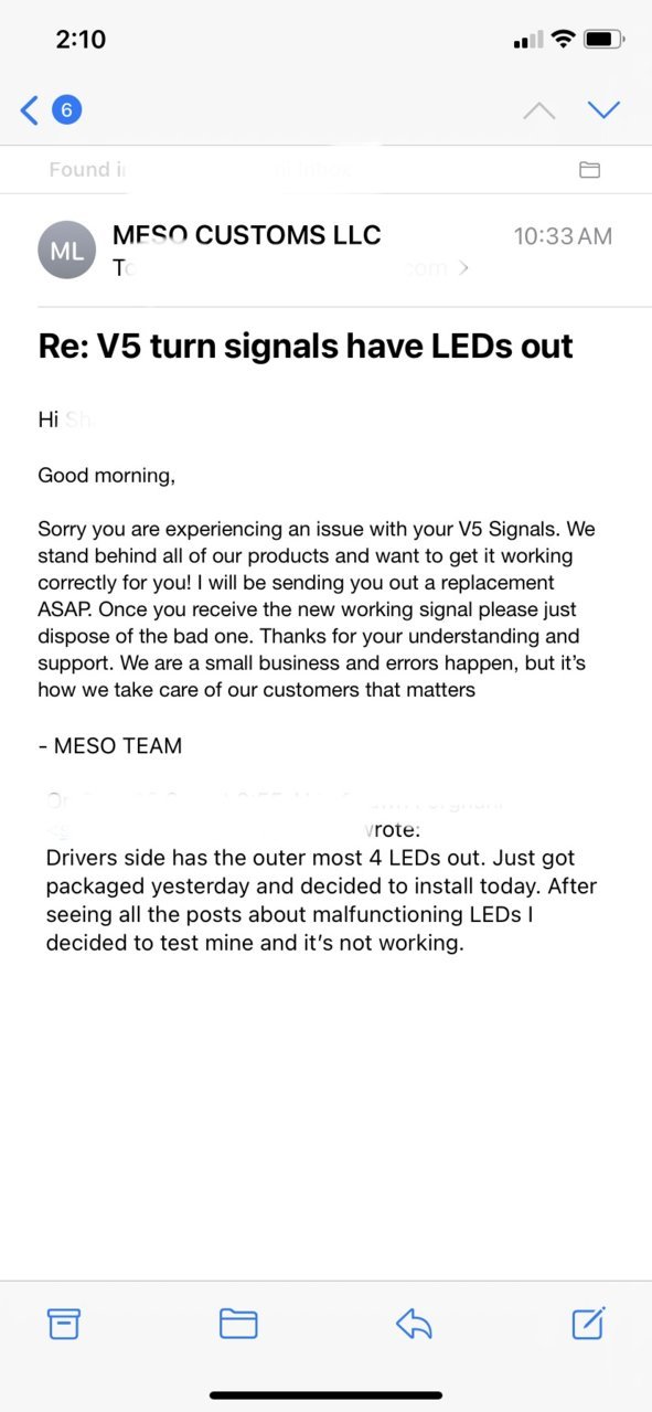

    Shawny5ive
    Shawny5ive Well-Known Member
    Aug 4, 2021
    #373131
    246
    Shawn
    NorCal (707), California
    ‘21 Army Green Tacoma TRD Off-road DCSB
    Just got an email from Meso today. They are sending out a new set that has been tested.
    Tacospike likes this.
  16. Sep 28, 2021 at 1:20 PM
    #176
    Tacospike
    Nov 19, 2018
    #273198
    14,418
    512
    Two Trucks
    Great news!
    EDIT: a whole new set or just a single problem left / right side?

  17. Sep 28, 2021 at 2:12 PM
    #177
    Shawny5ive
    Aug 4, 2021
    #373131
    246
    Shawn
    Not sure, the wording is a little ambiguous, but it reads as probably just a single signal. Edited out my contact info.68224BE0-D427-41E8-8B5A-FEE547FE012F.jpg

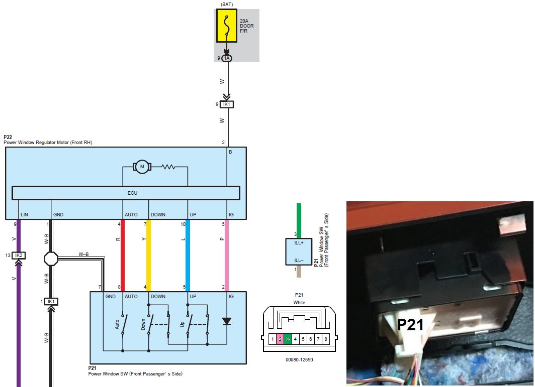

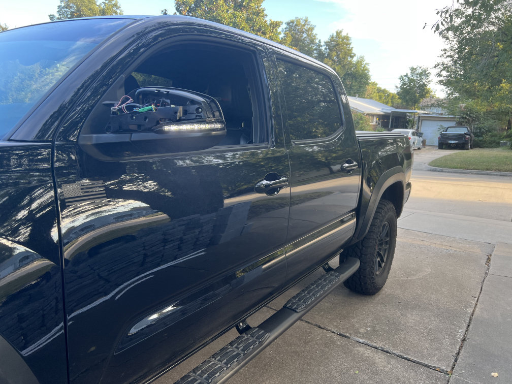

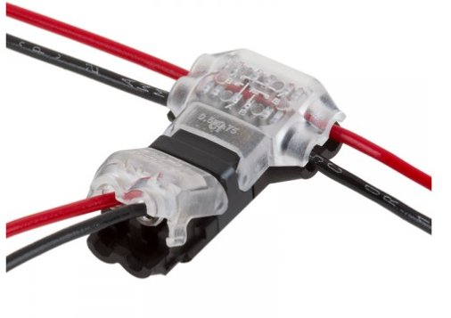

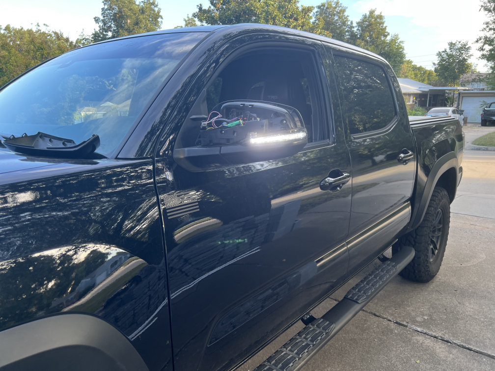

  19. Sep 28, 2021 at 5:33 PM
    #179
    Ooh-it's all squishy!
    Ooh-it's all squishy! Where's the kaboom?
    Sep 28, 2020
    #342244
    54
    Rod
    OK
    2020 Black TRD Pro MT
    KDMax Pro Tune, debadge, tonneau, hood struts, some ME-SO goodies, JL-Audio
    Got 'em Saturday and installed today. DRL not officially connected, but tested. Waiting for LED light harness from @daveeasa. Post status says Friday.
    I got lucky on the lights, all the LED's work :D
    Blinken lights:
    Dim DRL test:
    Bright DRL test:
    Skydvrr, devale, ktbell444 and 10 others like this.
  20. Sep 29, 2021 at 12:17 PM
    #180
    caribe makaira
    caribe makaira Well-Known Member
    Feb 13, 2011
    #51121
    11,788
    Caribbean, Puerto Rico
    05 PreRunner TRD Offroad AutoTrans
    Hood Struts, My version Fogs always ON, Map & Overhead Light Mod,

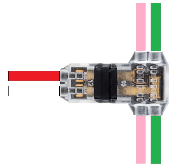

    Passenger' side IGN & Parking Tap at P21 for Taco's with anti-jam windows.
    These are fine for the taps:
    https://www.amazon.com/Lockitt-POSI...7f19e677c66&pd_rd_wg=3rAvy&pd_rd_i=B001MPW54G
    Passenger's side (With Jam-Protection windows)
    Driver's side (any model)
    Or do this:
    V5 DRL added relay (5 pin) in parallel with Headlight DRL relay, at Low Beam select Main Body ECU shuts down ground source to both. Headlight DRL dims via feed from Parking circuit, V5 added relay switches from NC to NO providing power to Dim side of V5 via add-a-fuse IGN source.
