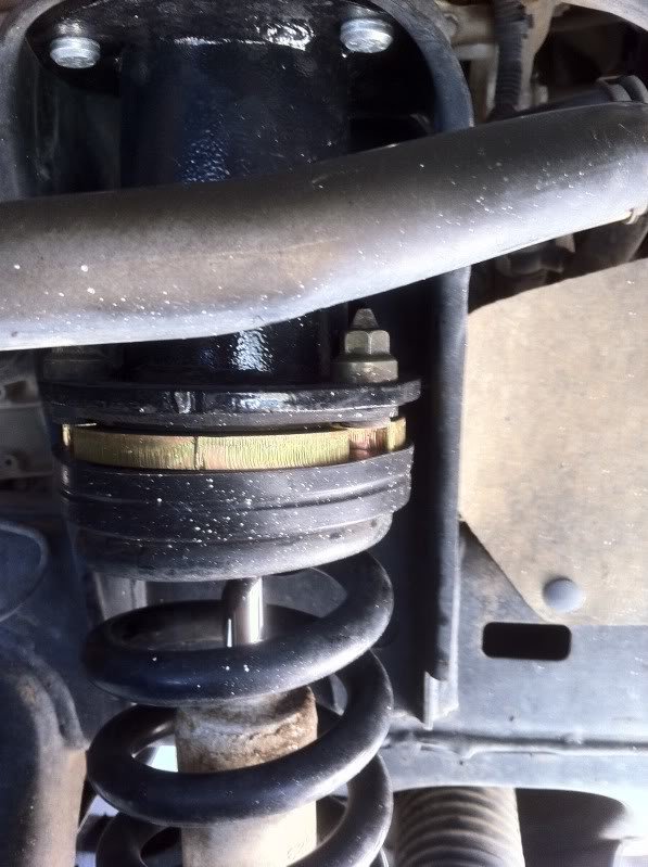

    From what y'all can see all I need to do is add those spacers and fix the cam bolts right?

    rrh 2,
    i know you are pissed off right now and i would be to, but the correct thing to do is go back to the shop and give them a chance to fix their fucked up install, start off by telling him about the tech saying you didn't need the "spacers etc. etc." if they are a reputable shop they will fix their mess, including the alignment cams they put on incorrectly. if that doesn't work i would suggest BBB and then give them a piece of your mind. I can't see more than a few hrs of work here. i would be right there watching them fix that. i hope this works in your favor. I am getting pissed myself, the more i think about this and its not my truck. sounds like you have a level head so go back and make them fix this small problem. it'll work out in the end.....

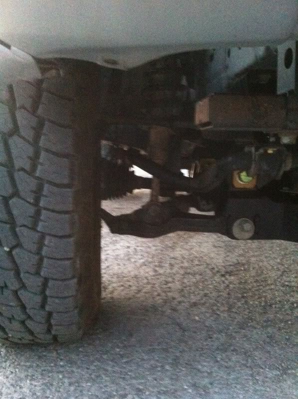

    look at my CV angle vs yours
    mine
    yours

    The sway bar looks f-d up. I don't have a 6" lift but it looks like something needs to be done about that, especially if you add more lift to the front.

    I might take the sway bar off

    glad you got it all worked out! take some pics now for us! i was a little confused? isnt that the spacer in the second pic you had ontop of the coils? and what is the spring isolator? i am not familiar with 6" lifts . .
  13. Jun 10, 2011 at 2:54 PM
    #33
    rrh_2
    rrh_2 [OP] Well-Known Member
    Jun 10, 2010
    #38724
    803
    Richard
    Devine texas
    05 tacoma 4x4 sr5 dc
    6" pro comp stage one lift ome 885's, 5100's,bhlm, billet grille, lights behind grille, k&n cai , tinted Led tails, tinted 3rd brake light, Lotek a pillar, color matched grille mirrors and door handles, trd seat covers, blacked out windows, color matched engine cover, in-dash flip out screen 2 10'' kicker subs
    ur thinking about the big spacer the one that he had to add are the lil rubber one and that metal one

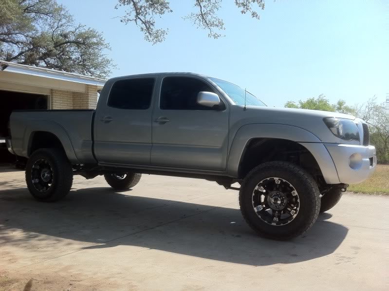

  14. Jun 10, 2011 at 2:54 PM
    #34
    rrh_2
    Jun 10, 2010
    #38724
    803
    Richard
    Devine texas
  15. Jun 10, 2011 at 3:01 PM
    #35
    krimson
    krimson Nothin
    May 17, 2008
    #6714
    3,399
    TRD Off Road
    OME 3" lift with 885 coils. OME Shocks with TSB 1.5 AAL. 285/75/16 KM2s. XD Hoss 16" wheels. DDM Tuning 6000K HIDs, H10 6000K Fogs. BHLM. Debaged. 20% tint on front windows.
    Now that's what it should be looking like.. I bet the installer felt like a dumb ass..
  16. Jun 10, 2011 at 3:07 PM
    #36
    rrh_2
    Jun 10, 2010
    #38724
    803
    Richard
    Devine texas
    yea especially since he didnt believe that they were supposed to be there.. until he let the lift down and my truck sat perfect
