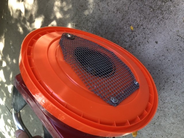

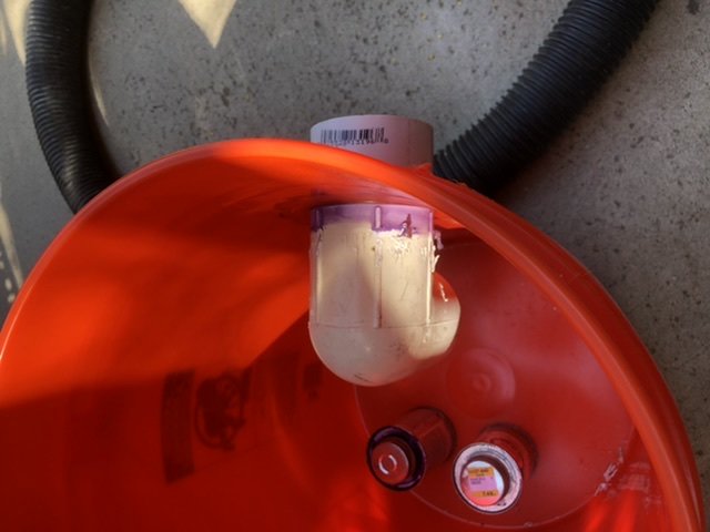

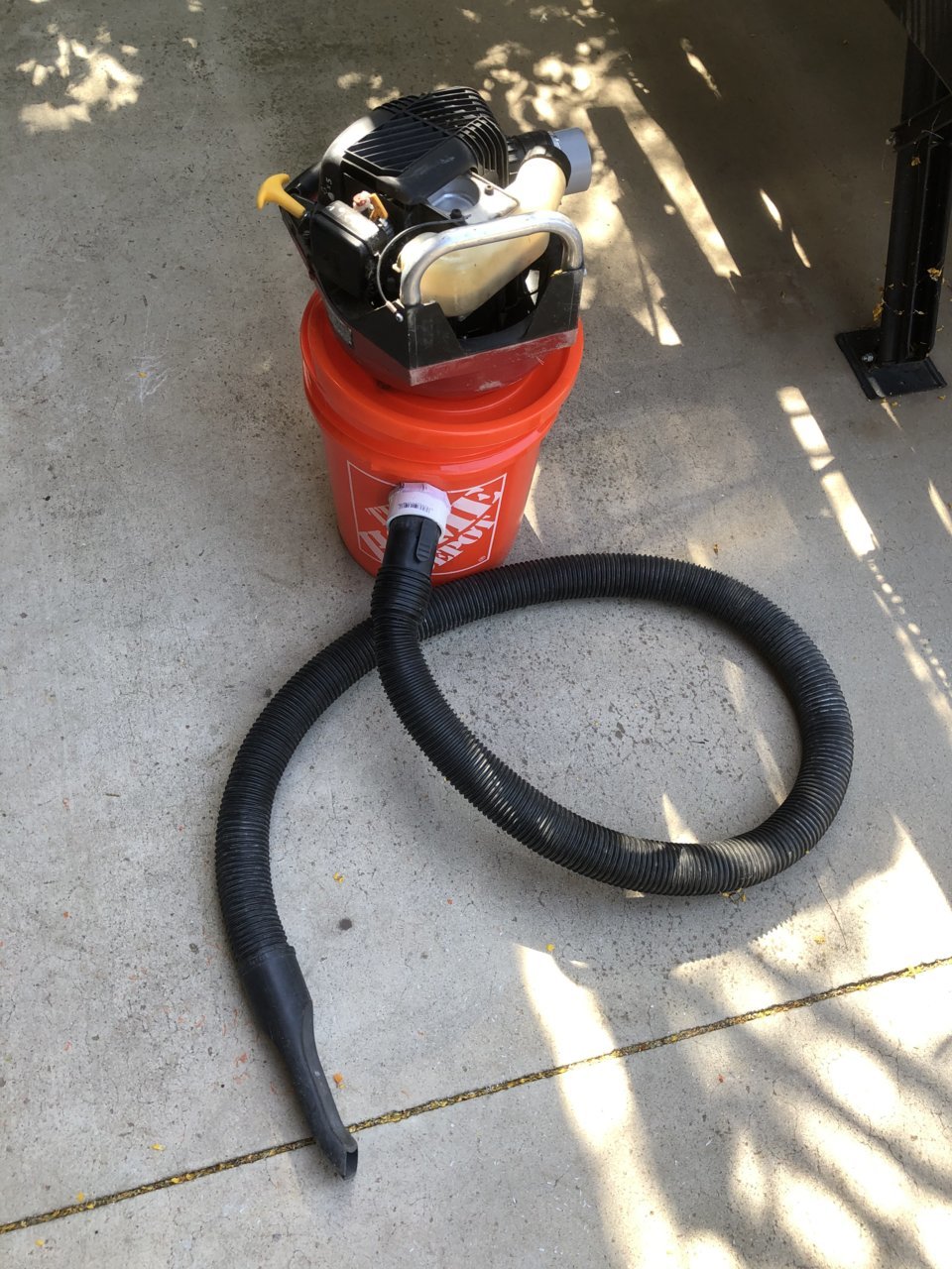

    Just finished making my $23 Homer Homelite gas powered gold vacuum. It really sucks!
    It’s a garage sale Homelite 23cc 2-cycle Zipstart handheld leaf blower, screen, three screws, Homer bucket and top, two 2-inch threaded pipe fittings (1 90-degree elbow and a male thread to female slip adapter).
    If you’re looking online at some of the other retail models (e.g., the Keene vac), be careful about trying to make your own with a four cycle motor like the Makita or Honda leaf blowers because those motors will not oil themselves correctly if they are not in the proper orientation, it has to be a vertical shaft oriented motor in order for it to work right (I think Keene has modified their motors as they are using Makita 4-strokes on their vacs).

    That's rad.

    WOW great thinking and craftsmanship there :) I have never gone out looking for gold :( How does that work ? I have never seen one before... Sorry for being a Newbie at yet another thing lol lol, thnx for posting it.

    Its a vacuum to help collect rocks, sand, and hopefully gold, that gets stuck in the cracks of bedrock. Since gold is really heavy, it tends to collect at the lowest points of a stream channel or in bedrock cracks where floodwaters deposit it.

    That's cool! I have seen people use those for a drywasher also.
