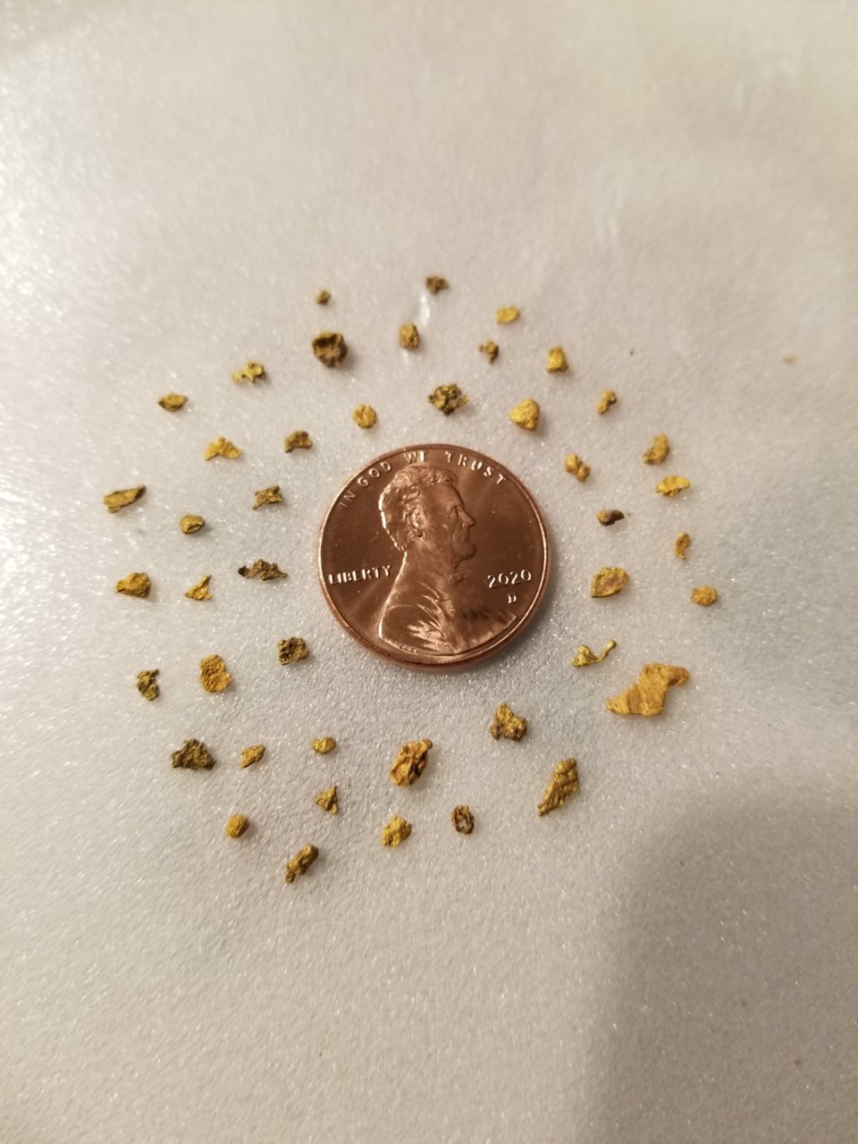

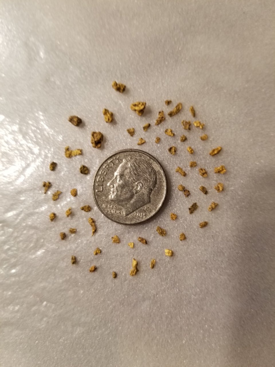

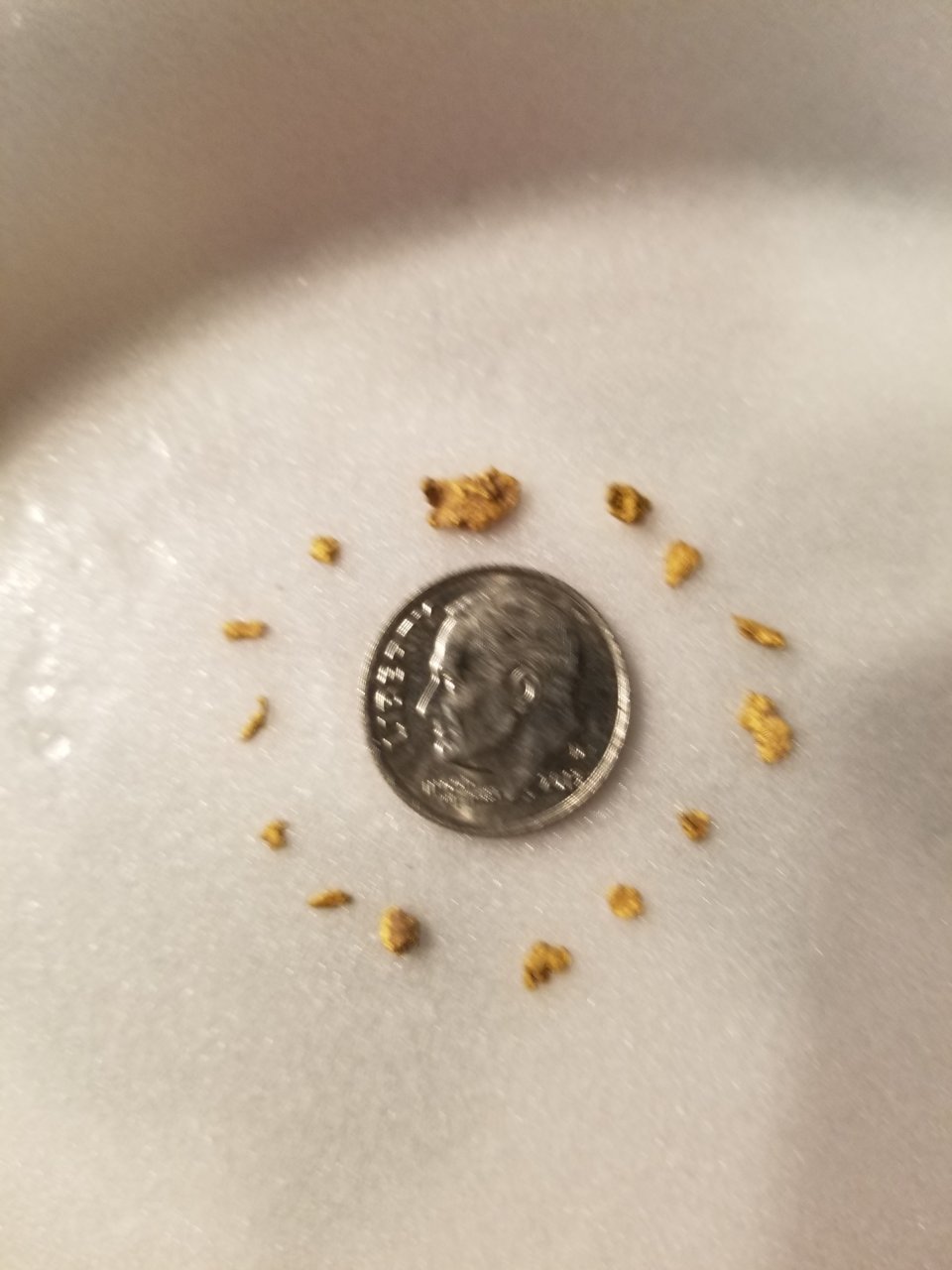

    Very nice!
    Gold Monster by chance?

    Ha Ha. Just messing with you. I found a pretty rich wash that has a cemented type bottom with tight little pockets in it. Tried to do some vacuum work and discovered I wasn't getting the pieces because they were wedged in. I started getting signals with my pin pointer after I had vacuumed. So put on kneepads, put on my reading glasses and used a scribe to scratch out little pieces. They are deep enough that the detector isn't seeing them. The pin pointer gets down into the little holes and signals pretty sharply and I can dig them out.
