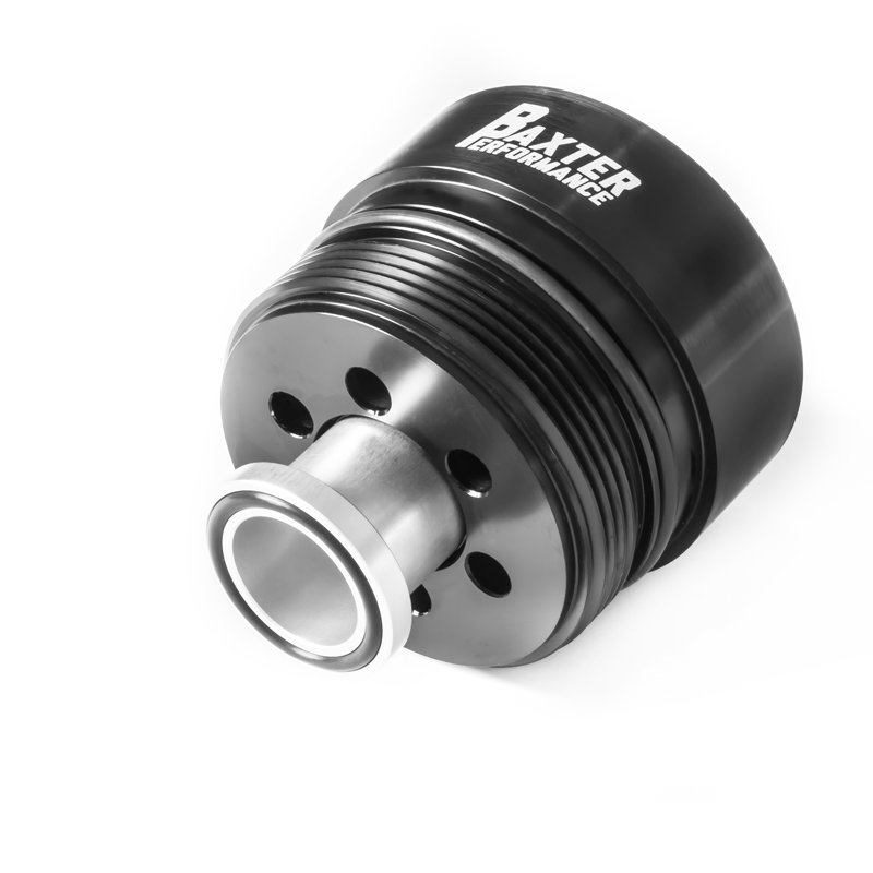

    Understand! The over tightened housing seems to be fairly common. On my original 5K change, I broke the wrench trying to get the damn thing off. That's when I decided to buy the adapter. Got it Fed-ex'd and then swapped it out with the canister. The spin-on's never are that difficult to remove and you are working at a much better angle with the wrench.

    I sure did like the oil filter right on top of the motor on the 2013 and 2005 4.0L I had. So easy to change the oil. What the heck is Toyota thinking? Let's take something easy and make it hard! Well, I will just have to learn to change the canister filter now. I think I will take off the entire skid plate just to make it easier and less oil mess. I'll see how hard that is on this old body of mine.

    Is this the one you got?

    Yes, and some people on this forum think everything the Toyota engineers do is in the best interest of the consumer! That is a joke!
