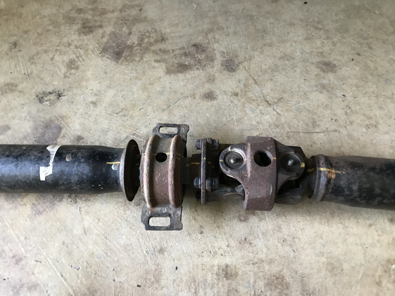

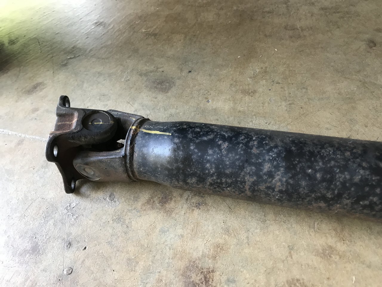

    Thanks for all the suggestions. Got it torn apart today finally. There aren't multiple sets of splines, right? The only ones I have are the slip-splines that are just forward of the rearmost U-joint that allows the shaft to extend/contract with suspension movement.
    Mechanicjon - are the companion flanges simply the flanges on the ends of each shaft segment that bolt together?

    There supposed to have movement in them. Usually the bearing gets sloppy in the rubber and will start spinning in it. The flange I would start with is the one you had in your hand in the video.

    that's normal. unless there are tares and/or holes, the carrier rubber is usually fine. but what about the bearing?
