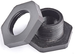

    Alright, well i've been rethinking the nozzle mounting. I got ordered an extra 2.75" silicone coupler that goes before my TB and i am going to drill a hole in that and use a Snow nozzle mount like pictured below. This should eliminate the need for a solenoid and also keep me from needing to tap into the intake piping. If this doesnt work, i will pursue the throttle body spacer further. Hopefully everything comes in for this in the next few weeks and i can get this done and go to the stage 2 pulley.

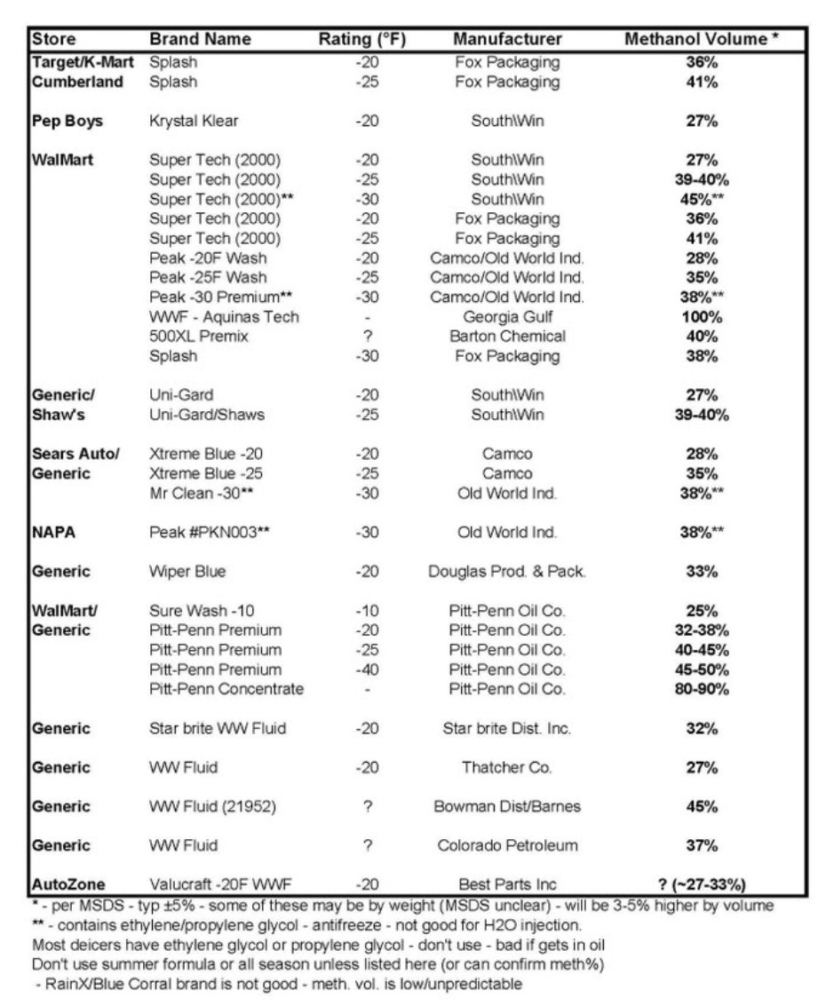

    Does anyone know what % methanol the 0*F Supertech stuff at Walmart is? I did some research but couldnt find anything

    1,185

    No MSDS info available online for Supertech?

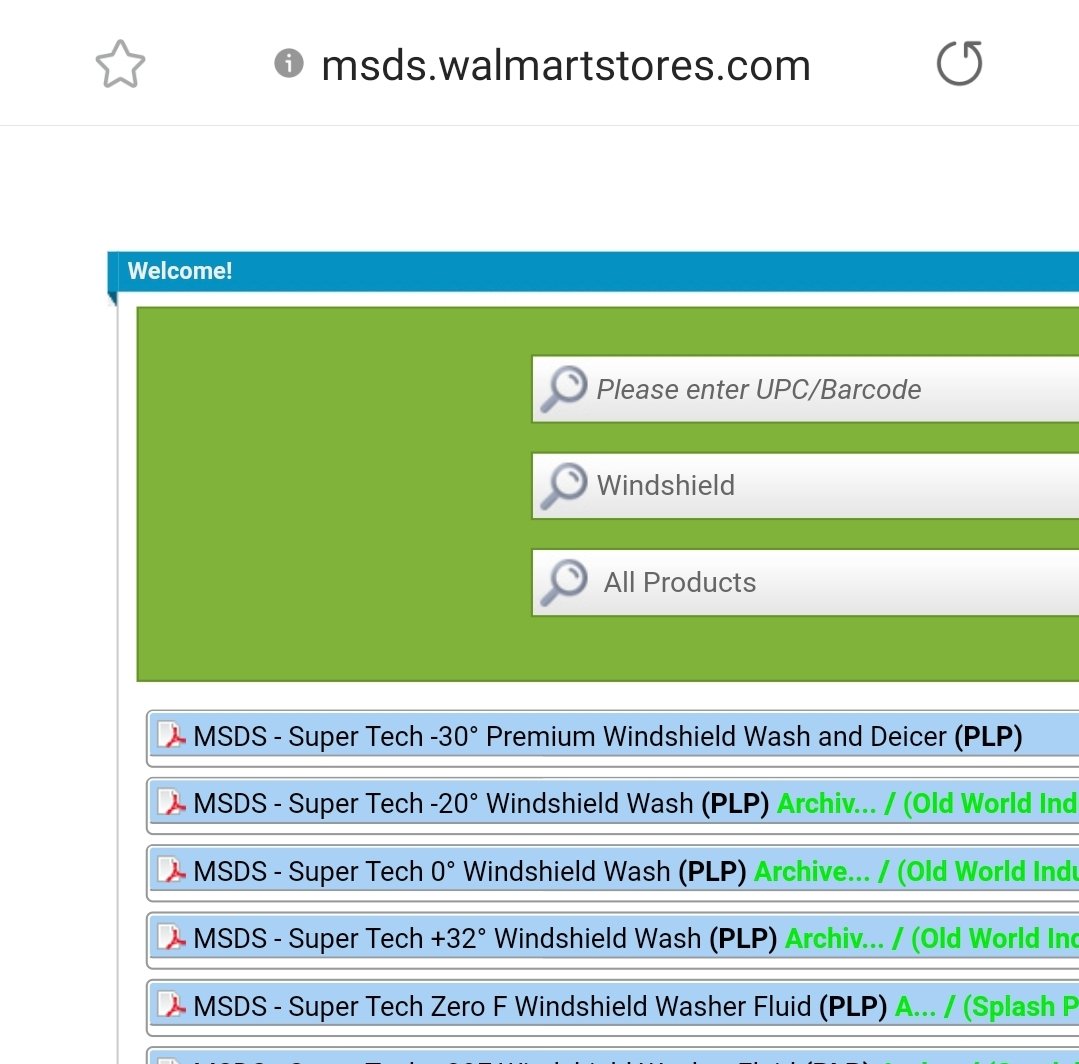

    Search "windshield" on this site:
    Looks like less than 23%

    Thanks man! I need to work on my searching skills it seems :anonymous:

    No problem I was looking at some of these a couple months ago when I installed my system, but didnt realize the 0°F still had methanol
