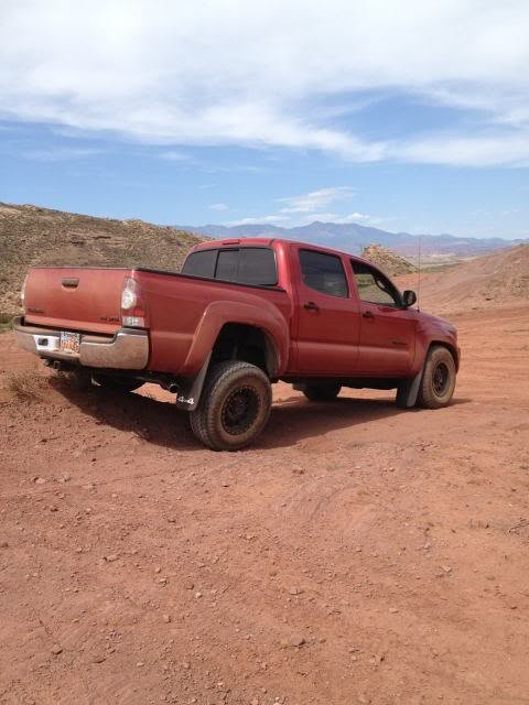

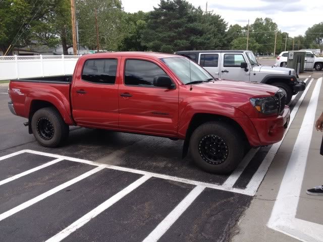

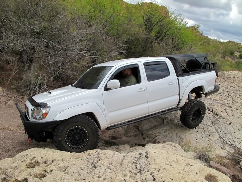

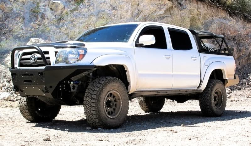

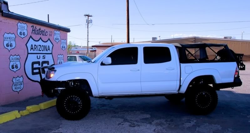

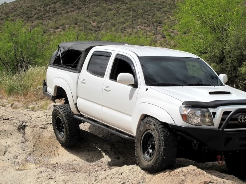

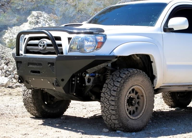

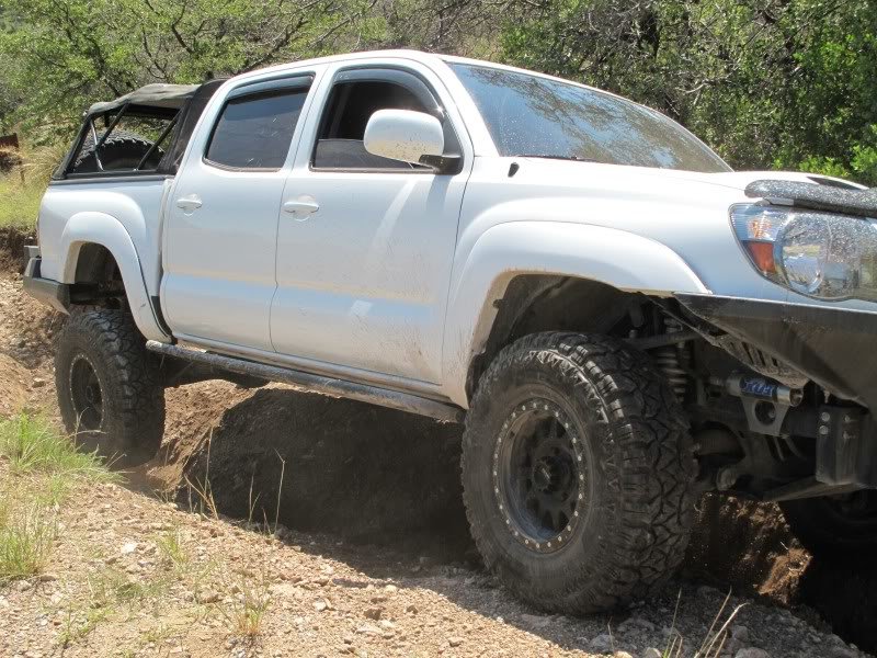

    NOT TRUE, 16" METHOD wheels will fit any 6 Lug 2nd gen taco (as long as it doesnt have the TRD big brake kit)
    Hey, I know that guy!!!
    Here are more pictures of the above truck (MINE) running those rims. I ran them WITH and WITHOUT spacers and both work fine. My truck is a 2010 DCSB TRD SPORT 6pd with a supercharger, and yes, my truck kicks ass!!!
