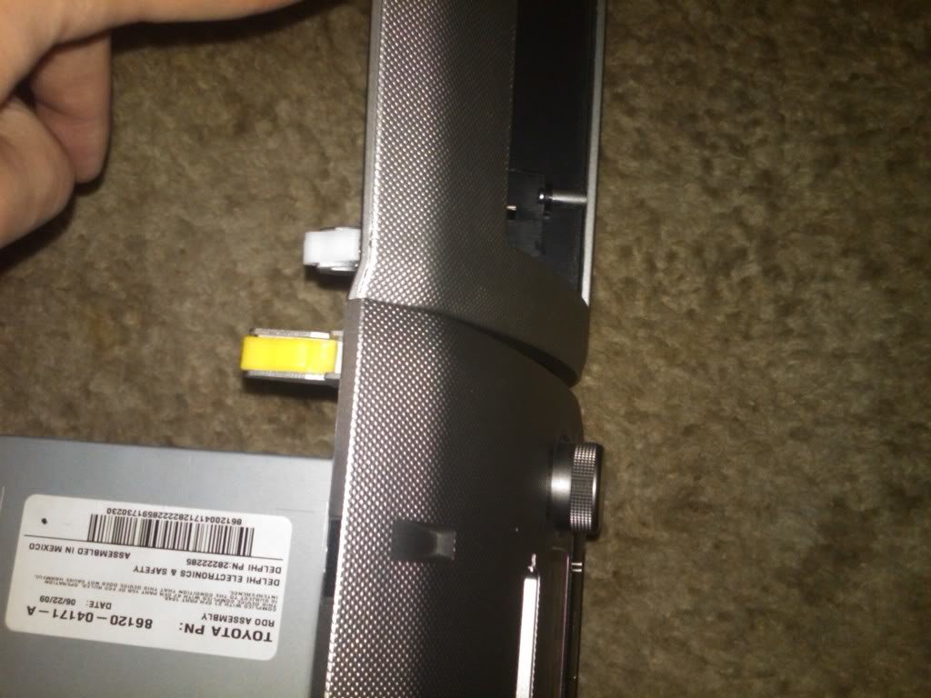

    So I tried swapping the clips, and even putting the trim piece in place without the headunit even in, still doesn't go in. So there's definitely something wrong with this one. It's as if the tabs aren't long enough.

    After comparing it to the stock headunit my suspicions were correct, they're not even remotely long enough.

    Just got off the phone with Crutchfield, guy seemed pretty baffled by why there is such a difference.. Had me email him a few pics along with measurements to compare with another kit they have at the warehouse and to check with Metra to see what the issue is. So we'll see.

    I had a Metra single din kit that had the same short fastners, and the top wouldn't stay snapped in at all.
    Got a Schoshe (sp?), and it had same length fastners as the factory radio. Snapped in just like the factory and won't budge. All is right with the world now.

    An update on this, the Crutchfield guy I was speaking with said Metra told him the clips on the top should have been longer ones than the ones for the bottom and that if all for white clips they gave me were the same I got the wrong ones. They're sending me long ones, although I'm very skeptical that they will actually fit. But I'll hold off on ordering something new til these arrive and I can try them.
    If it still doesn't work I'm just going to get the Schoshe one.

    Sure enough the clips they sent were the same as the others. So I'm still stuck with a half ass fitting dash kit. See what else they come up with. It's obvious the tabs that stick out that the clips go on aren't remotely long enough which is what I told them before.
