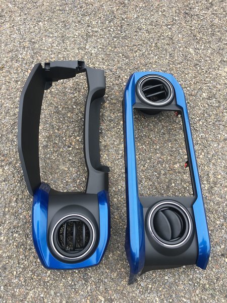

    Yes! Their paint is amazing! I have bought their touch up spray for several vehicles and always a perfect match. And their clear coat comes out amazing. Both of these are Automotive Touchup rattle can jobs
    The grill on my 2013 spruce mica tacoma
    The dash bezel on my 2016 blazing blue tacoma
    But duplicolor MGM is perfect and comes out great too. And 1/3 the price of a custom can from Automotivetouchup
    Bullitt and Dgibson529[QUOTED] like this.

    Was the clear a rattle can too? How many coats? Hows it holding up? Looks great in the pics!

    It actually didn't hold up good because their clearcoat isn't hardened, it's just for touch up. I ended up redoing it with 2k hardened clear coat.
