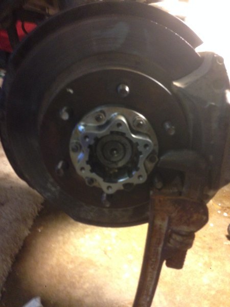

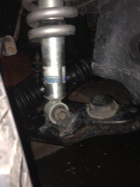

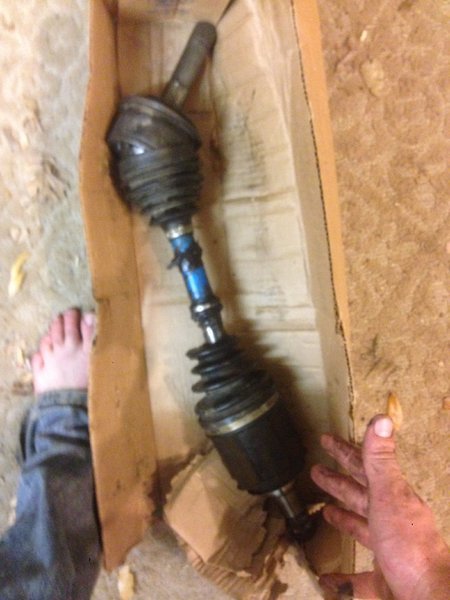

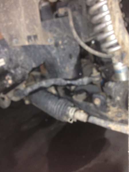

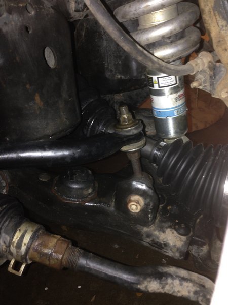

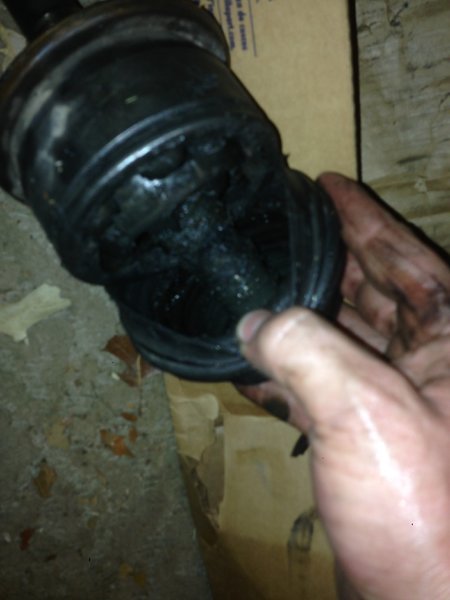

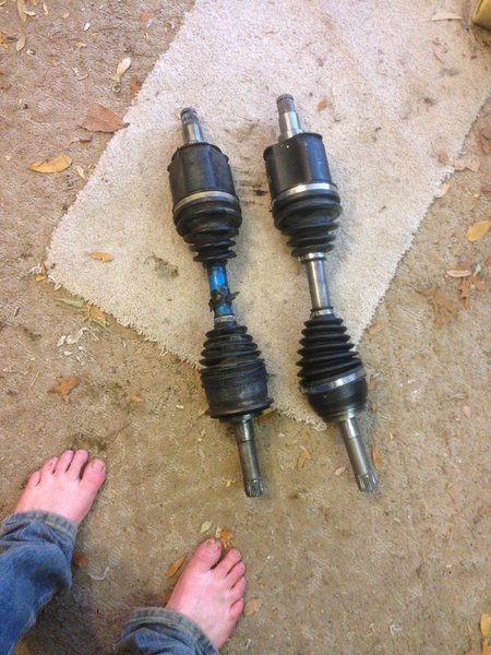

    Well I had some down time so I changed my CV, not too hard of a job to do.
    Old vs. New
    The old CV was toast
    The locking hub partly disassembled
    She wasnt too much help lol
    The new one looks good in there!

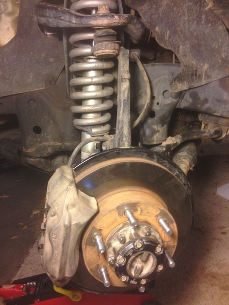

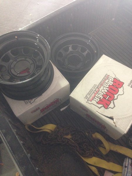

    I bought these rims for a great deal from a fellow member and fellow ag in houston around March, I just got around to putting them on lol

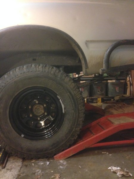

    These rims hit the caliper in the front so I have to run a 1/4" spacer in the front. To compensate for the loss of threads I bought some E/T lug nuts. They didnt work, same amount of turns as stock. So what we ended up doing is getting the rear wheel studs for a 2004 matrix, they are 55mm long compared to 40mm. put those on the front and it worked perfectly!
    The stance:cool: :laughing:
