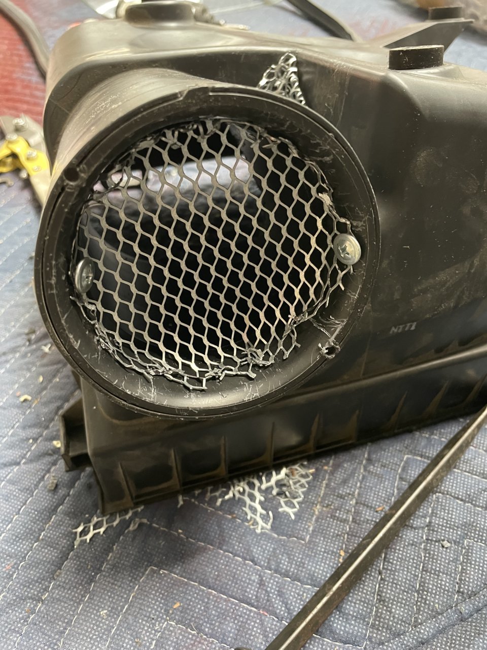

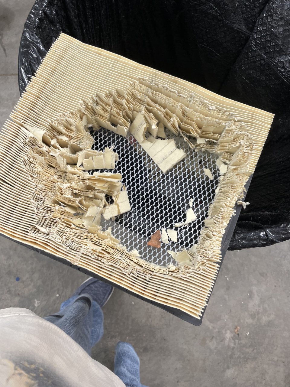

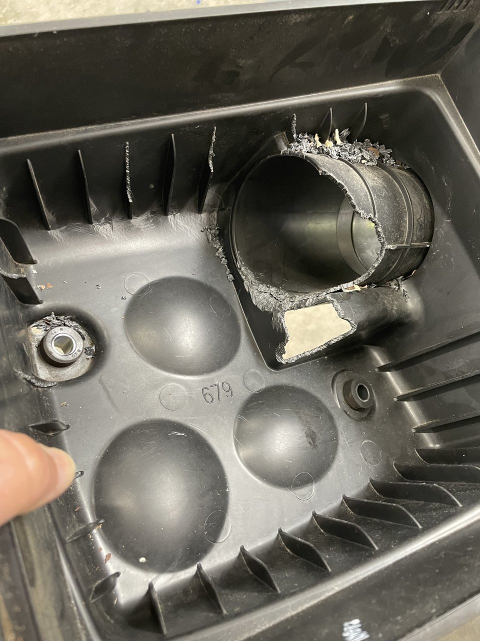

    Husband was changing the oil in my truck and checked the air filter.... can’t believe Toyota left this wide open for rodents. Put mesh (cut from the old air filter LOL) and then we fiberglassed the hole they chewed.... daym.....
    They got the headlight wires earlier.... thank you again Puppypunter for the help on that....5AF1777B-53A2-439C-B02A-38BC0281C14E.jpgD1C1D22F-857D-46FB-952B-8903DFA44ABE.jpgA7EFCFE7-3549-4D57-8E95-426DB59F031F.jpg

    Sticky trap cards applied in flat areas of travel with double sided tape will keep you from buying several $7k wiring harnesses as they are most definitely next..seriously..mice love Toyota wiring harnesses..I've thought about using that exhaust pipe wrap sold in rolls that you wrap around headers for heat shielding to add a protective layer to wiring harnesses then the good old hose clamps to start and finish the ends..unless you like paying $7k a few times a year or start feeding stray cats as that may also work maybe..

    Wire mesh will need to be pretty fine as mice can squeeze through a hole only a quarter inch in diameter. That's like pencil diameter. It's crazy. Found this: Mice and rats have somewhat collapsible rib cages. Their ribs have a greater capacity to flex than most other mammals, enabling them to flatten themselves temporarily to squeeze through narrow cracks. If a mouse can fit its head through a space, the rest of its body can squeeze through as well.

    Spicy peppers and such has zero effect on mice and rats..as they don't have the receptors to taste spicy peppers..several videos on YT mouse trap channels have tested this on several occasions..they have tested pure capsaicin powder with no effect at all on mice / rats etc..sticky traps , extra layers on wiring harnesses, maybe predators seems to be the only solution..its frustrating to fight such issues as it gets very expensive to repair..some people have used their car insurance to replace wiring harnesses as the repairs are so expensive..
