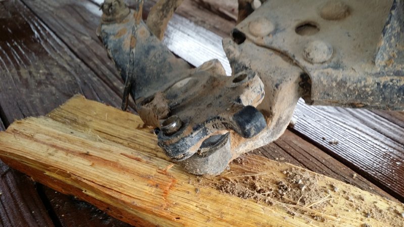

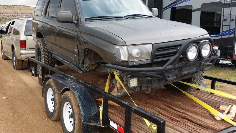

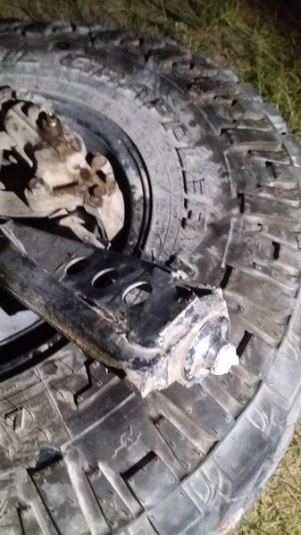

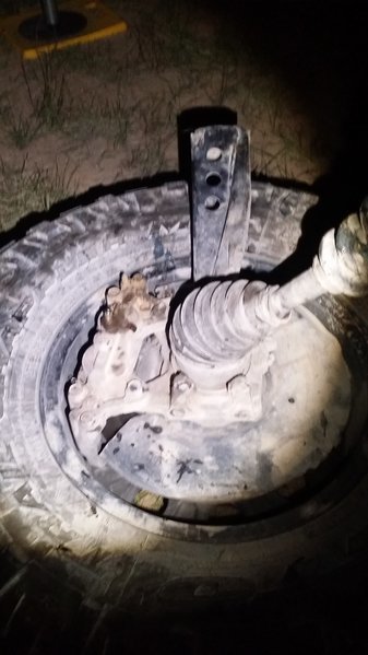

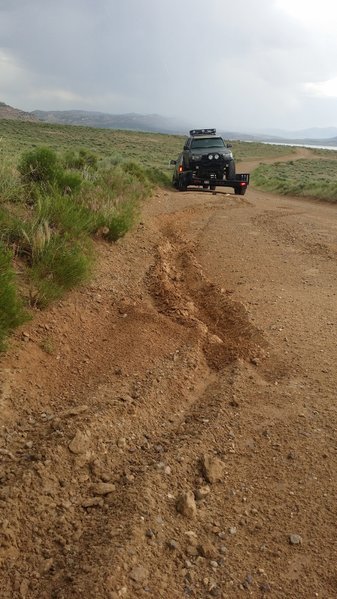

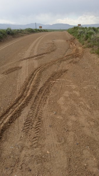

    Let me tell you first hand, It does not pay to get cheap quality parts and ignore torque specs.
    Example A: Ebay UCA and toyota OEM LBJ not torqued to the proper spec.
    I was doing 25mph on a gravel road near flaming gorge and the wheel decided to not want to be on the vehicle anymore. Luckily nobody and no objects were hurt with the 90+ lb. 33" load range E tire and hub assembly bouncing across the sagebrush.
    20160623_154910.jpg 20160623_160025.jpg 20160623_160234.jpg 20160623_162341.jpg
    Dented fender
    LBJ bolts snapped off in spindle
    Bad(?) LBJ
    Broken passenger uniball.
    Could have ended a lot worse than it did, especially since i was going 90mph on I-80 the day before...
    The risk of human life is not worth the reward for saving a couple hundred bucks. If anything would have happend to my girlfriend that was riding passenger seat at the time, I would have never forgiven myself....

    Holy shit! That's scary. Any idea what gave out first?
    #25
  6. Feb 26, 2017 at 10:30 PM
    #26
    miles.less.traveled
    miles.less.traveled [OP] Well-Known Member
    Feb 22, 2017
    #211403
    55
    Miles
    Mid-travel expedition/overland 3rd gen 4runner
    Hamster forced induction The shocks for the going fast Places to store and set the things in the rear
    I really cant say for sure. All I know is my tire was flying past me still doing 25 mph + while my girlfriend and I just stared at each other in shock!
    If I had to guess, I would say the LBJ bolts went first causing the spindle to catch and spin around then causing the uniball to break.
