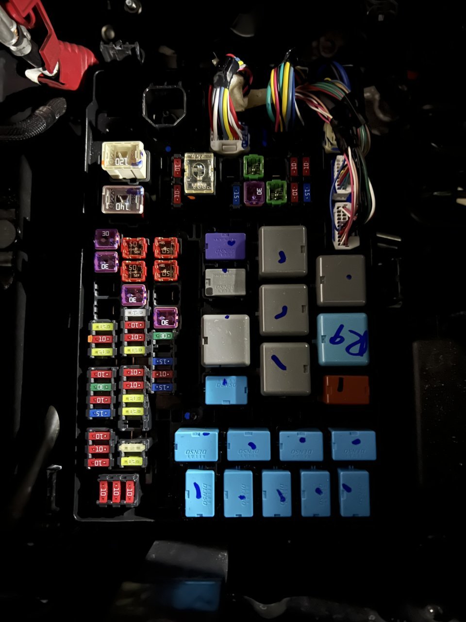

    Stab in the dark but check the 10A DCM fuse in the fuse box under the hood (see yellow box below).

    Okay so I think I’m losing I did that at first too, under the fuse box lid there’s a couple spares so I replaced the 10 fuse but that didn’t work, so I went back and did it again after your comment but that fuse was again?? What did I do with that fuse? Lol we’ll I put another one in entune promoted for an update and dcm logo was live. Here is a pic also of what my fuse box looos like it looks like everything is in place unless I’m missing something.

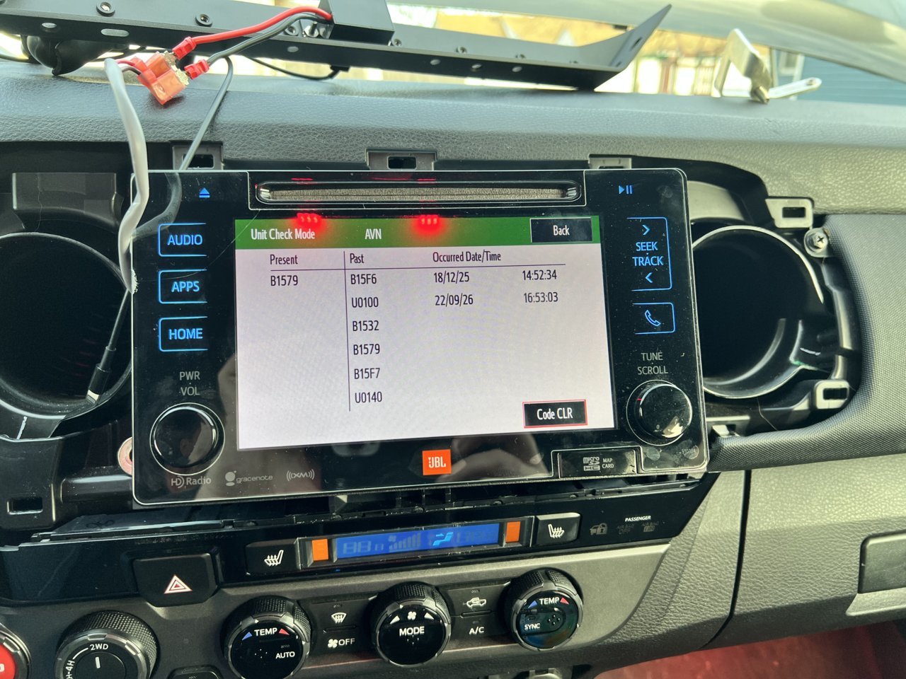

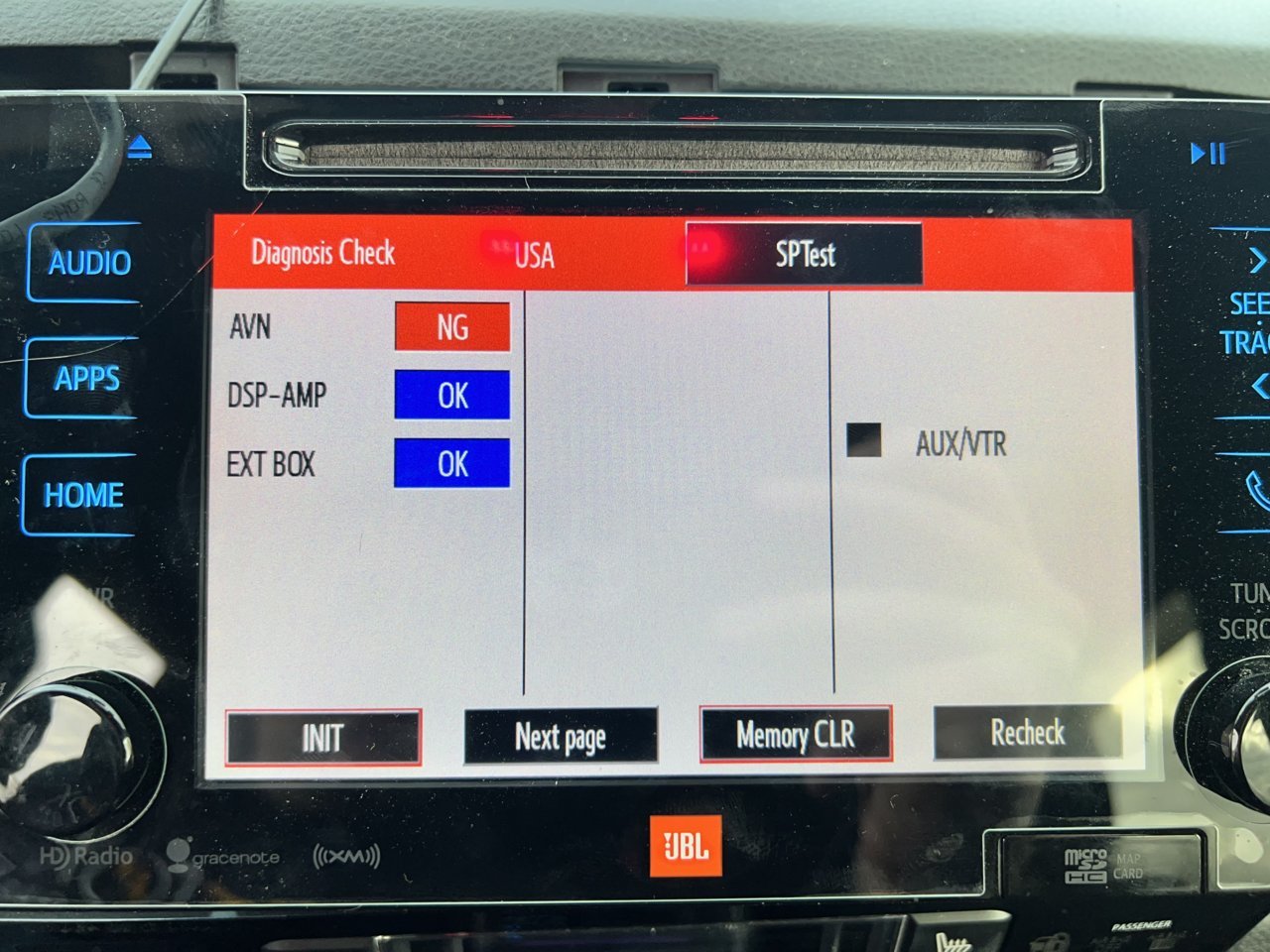

    Run the diagnostic from the head unit. Do the following: AUX start the truck by just pressing the ignition button/turning the key to AUX. press and hold APS on the radio head unit and simultaneously turn the headlights on then off three times. You’ll get a screen like the one I posted. Doing the steps above but holding down AUDIO will show various error codes.
    I’ve narrowed mine down to a bent pin in the 25 pin connector. Just gotta get the pin and replace it.
