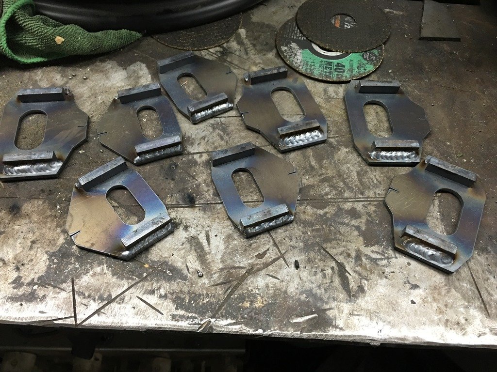

    Prepping some TC cam gussets for install, I'm a Total Chaos vendor of anybody is looking for TC parts. I've also had a lot of intereste lately in the non-swaybar TC spindle gussets, so I ordered up a few sets. I should have a set welded up and ready for a new home by this weekend

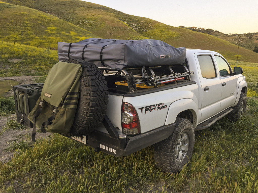

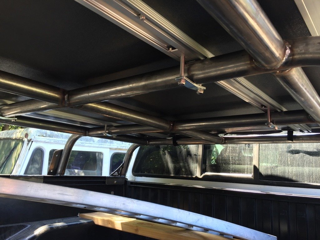

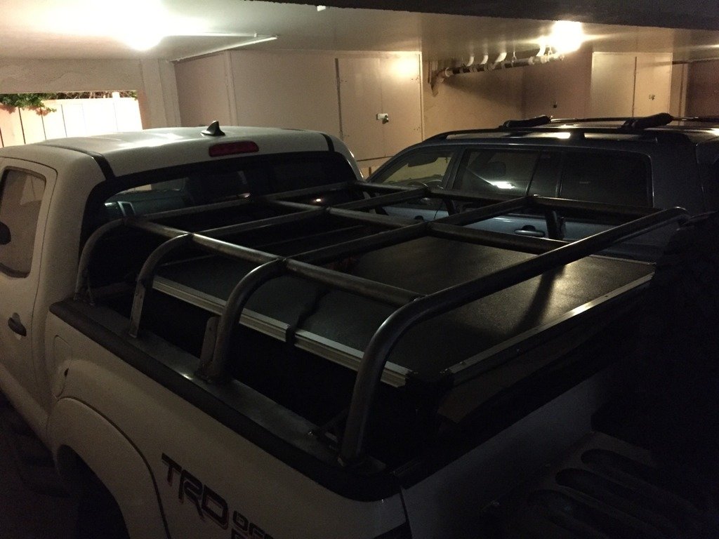

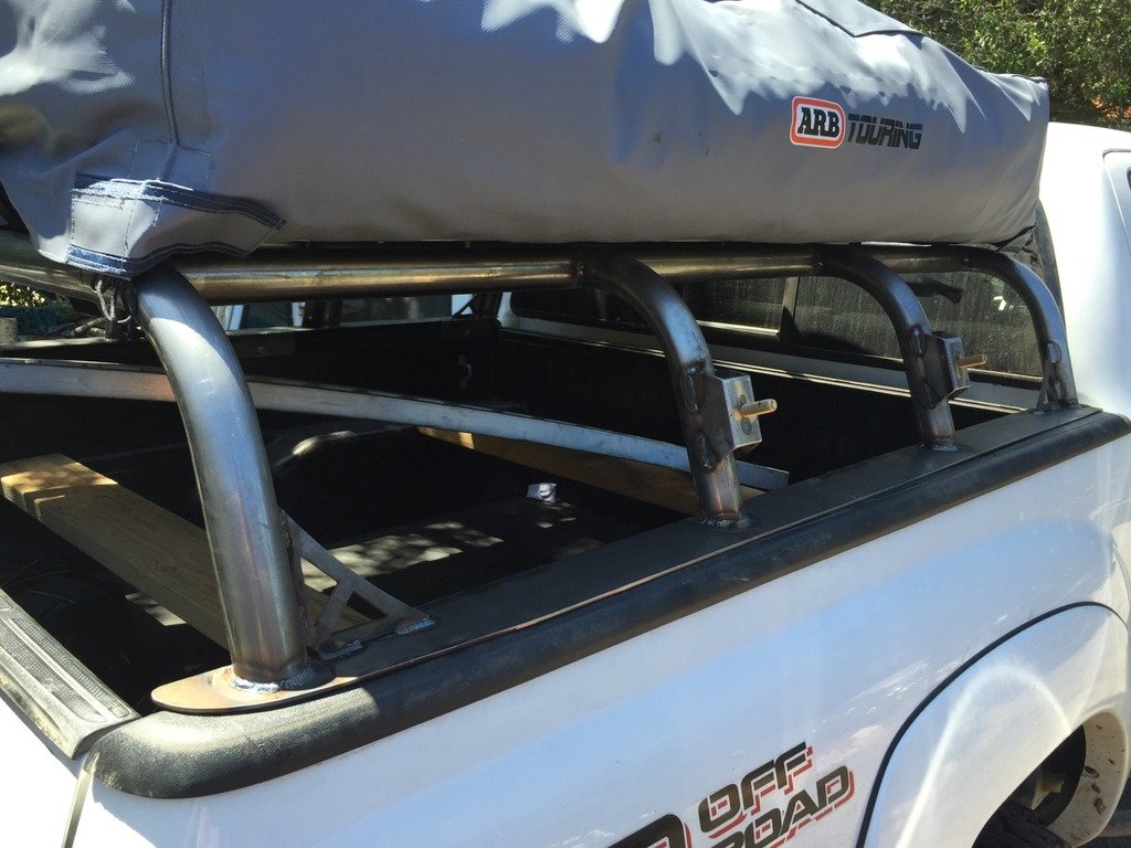

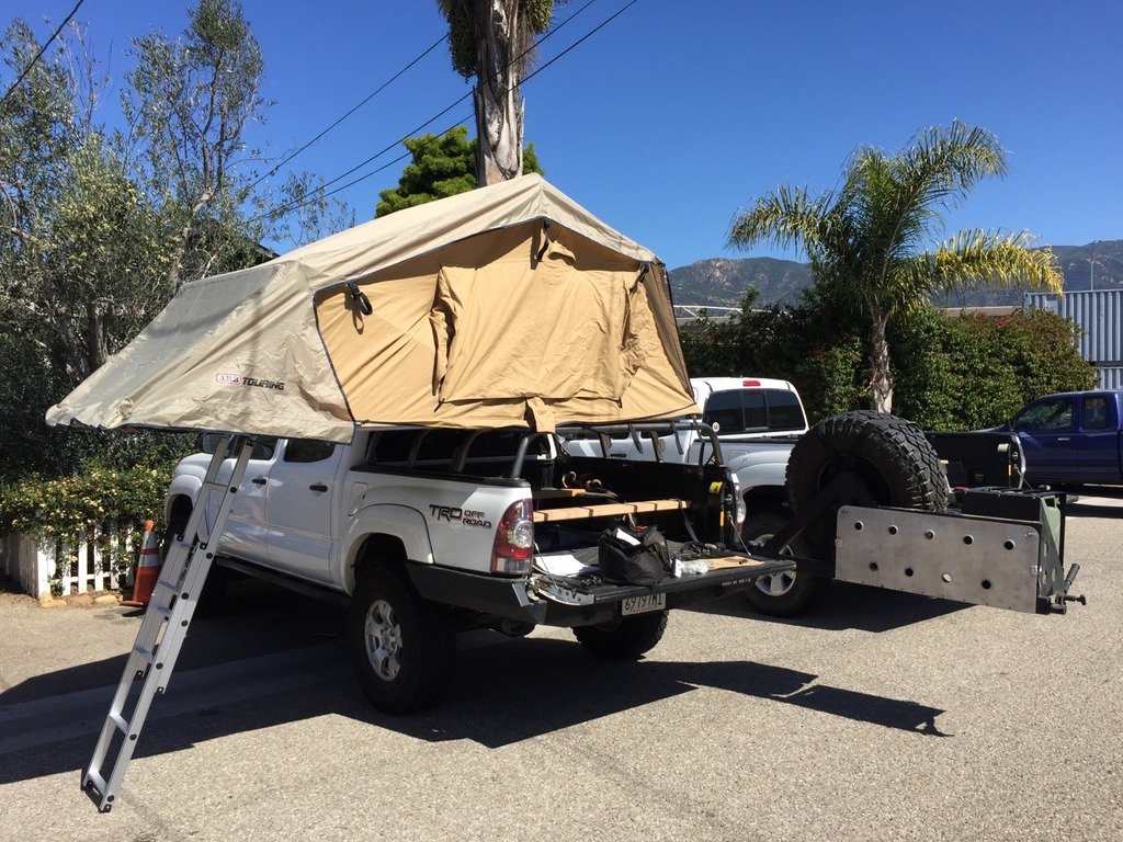

    Installed pictures of the bed rack I built last Friday. Rack included hi-lift mounts, custom cut tie down gussets, lighting tabs, and some gussets that will allow expansion (like rotopax mounts or maxtracs) in the future.

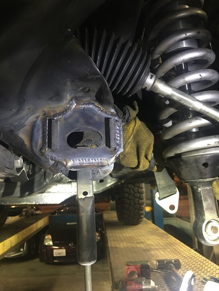

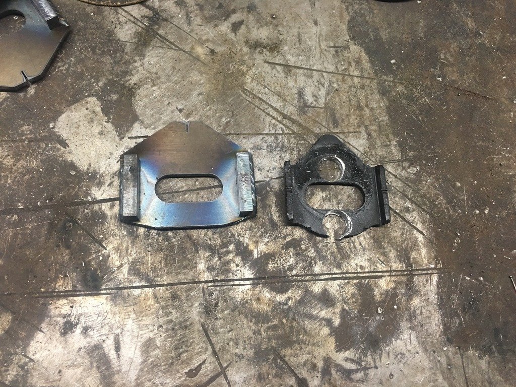

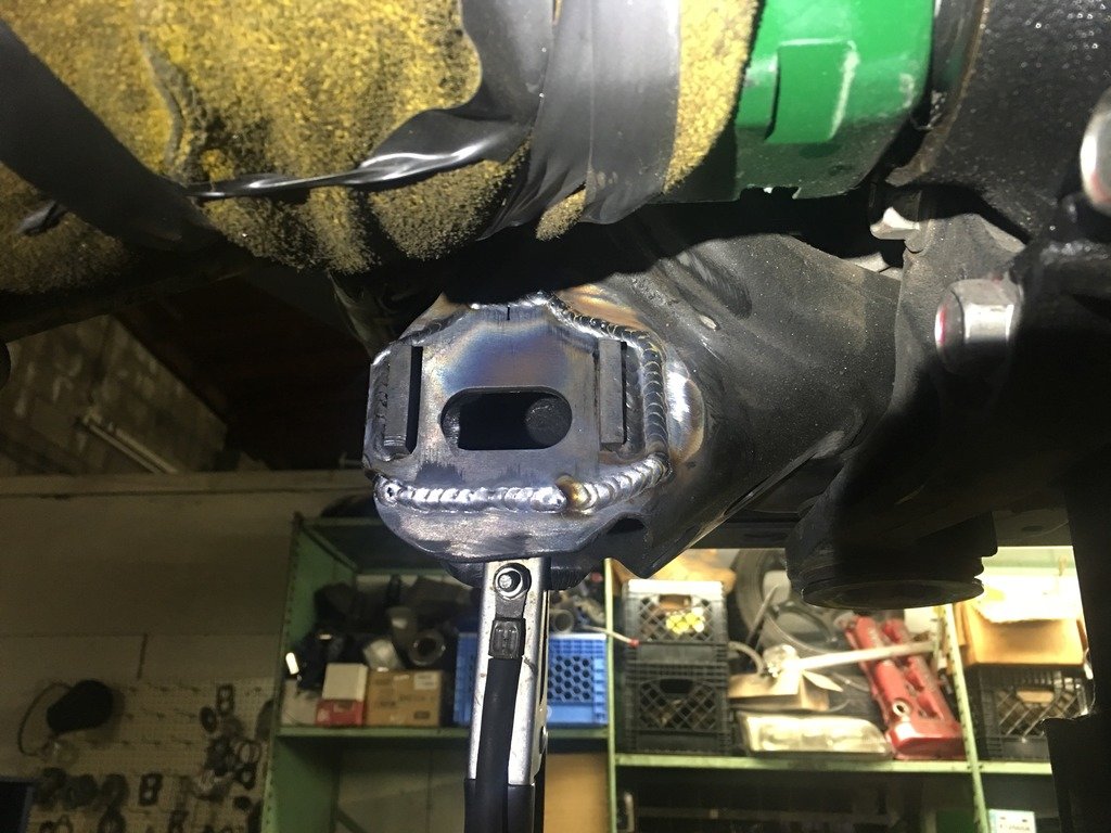

    Another late night installing total chaos cam gussets among other tidying up on another TW members truck

    Hey Jason, I have a stupid question. What are the gussets used for?

    I'm guessing limit straps but I have no clue

    @Bravisimo @SixthSnail they reinforce the alignment tab on the lower arm. Rough offroading can really bang up the stock one. He shows pictures of before/after.
    If you lay down under the truck and look at the bolt that holds the lower arm in place you'll see the area he's welded to. That large flared "washer" looking piece.

    . The are used to hold the alignment cams for the lower control arms, I think they are a must for any arms that are t gonna be solid mounted on a truck that will see the dirt. They hold the alignment 1000x's better the factory ones and won't fold over on you if you hit a hard edge.

    Cool, thanks @digitaLbraVo! Never really noticed. But if I do the occasional off road, nothing heavy or rough, is it something I should consider?
