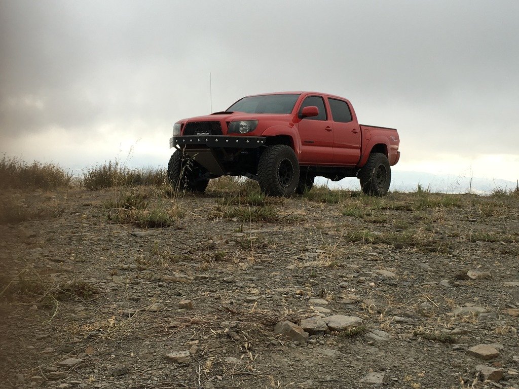

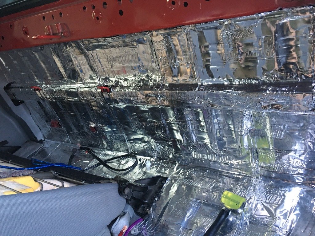

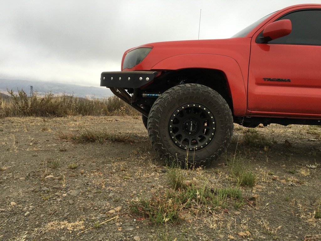

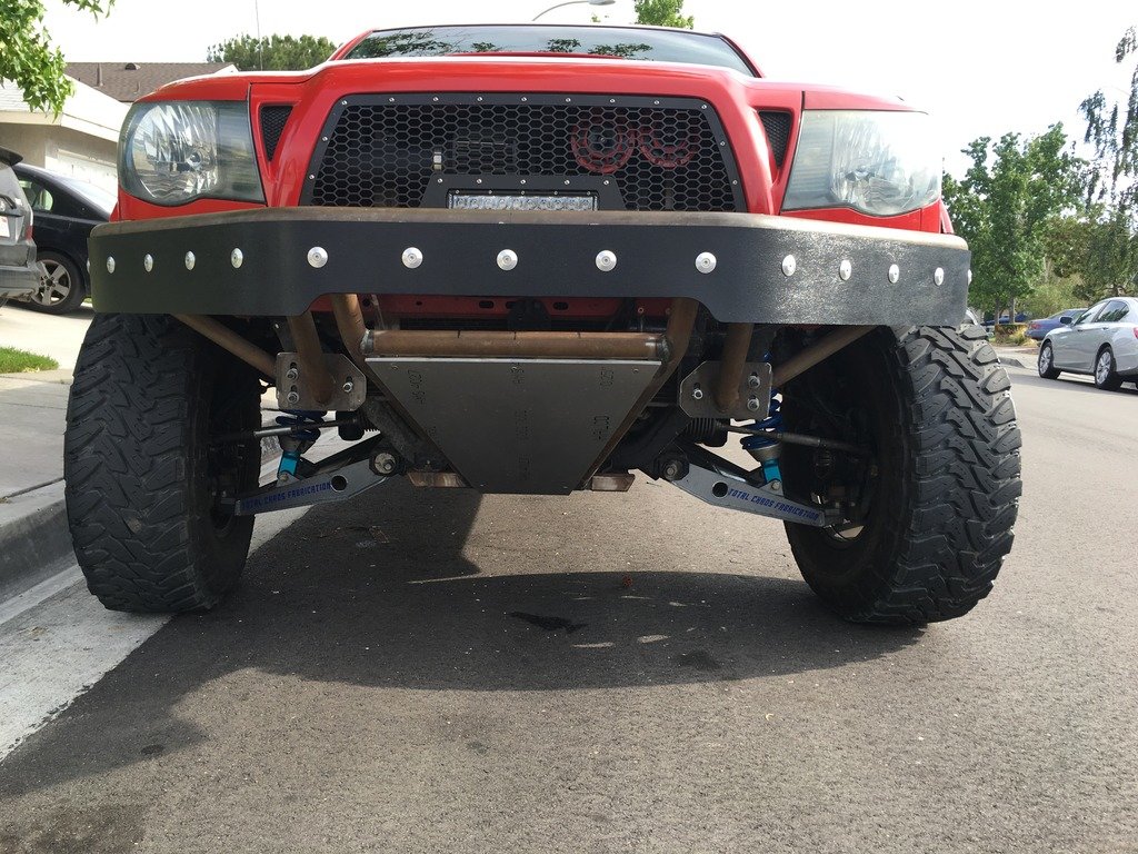

    Finally found some time to start welding some links together, install the new afe headers, dyno matted and reconfigured my subwoofer setup and work on my front bumper(now all I need to do is mount the winch and lights) too bad it'll have to go up for sale once I start installing my fiberglass fenders

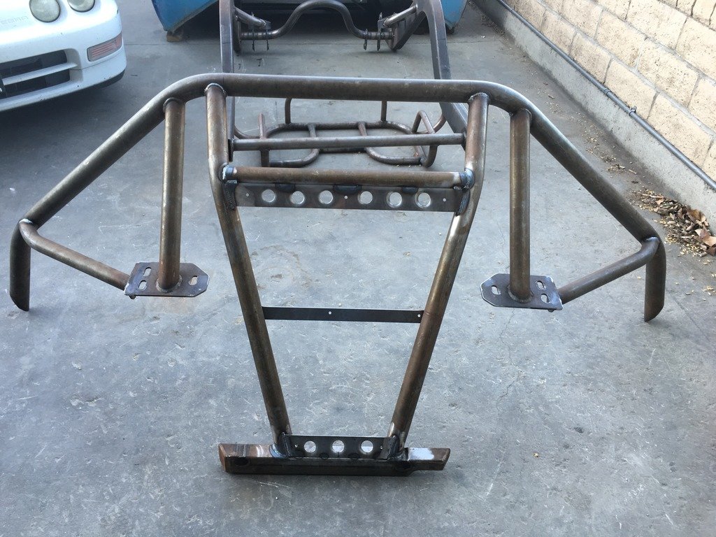

    Front bumper 2" dom main tube everything else is 1.75 and 1.5" Dom

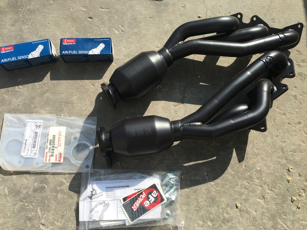

    New afe headers width high flow cats

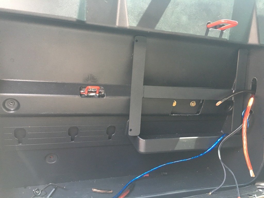

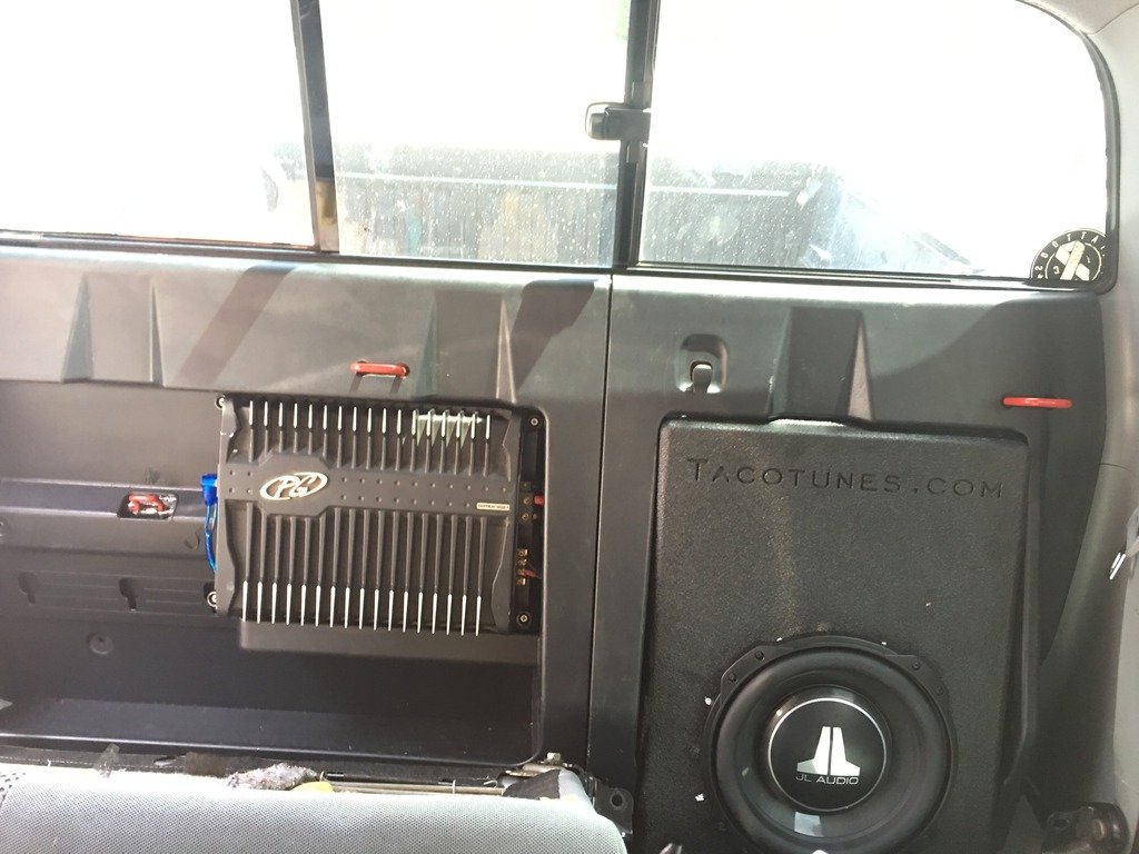

    Quick amp rack and some trimming of the stock.plastic to swap for two subs back to a single with room to relocate my battery behind the seat

    How much to build a bumper like that for a 2nd Gen? Such a rad looking bumper!!

    Stoked you got time to work on your own rig. Its coming along sick. Good choice with the JL
    Im guessing the High Flow Cats have a lower back pressure?
    And did you have to replace the 02 sensors?

    I didn't have cats at all before. Once I started upping the boost I pulled the cats. Gotta a crazy deal on the headers and it included hi temp coating and two new o2 sensors.

    Why did you relocate your battery?

    The weight of the battery out there on the front corner causes a couple of problems. It squashes the front core support wall bushing and leads to the core support wall itself wrinkling and tearing.

    So I don't destroy my core support. Just like I recommended for you to do. Putting a giant battery on your core support and then romping your truck is never a good idea
    Also trying to offset the weight of my gas tank a little. Coming from a road racing background I plan on corner balancing my truck once the links going in. Definitely overkill, but why not
