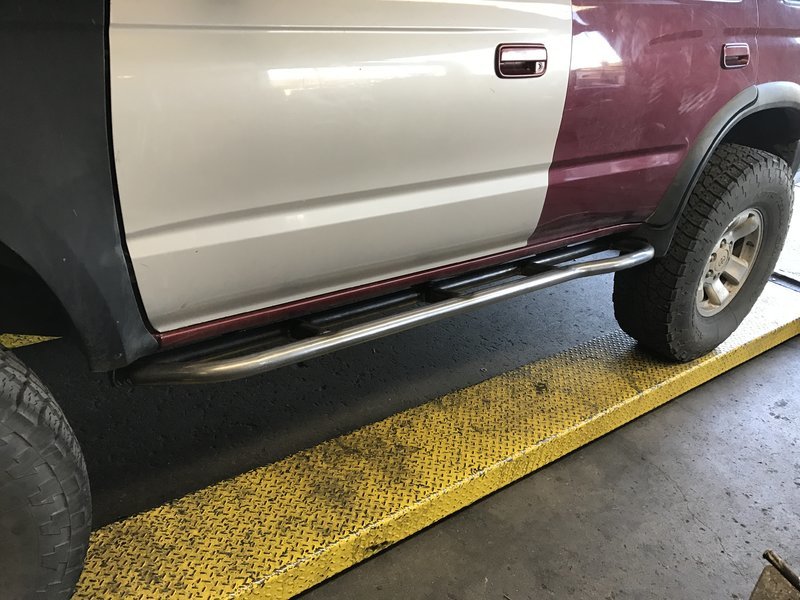

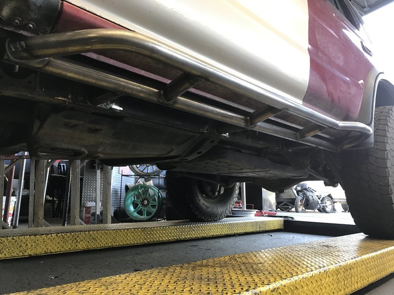

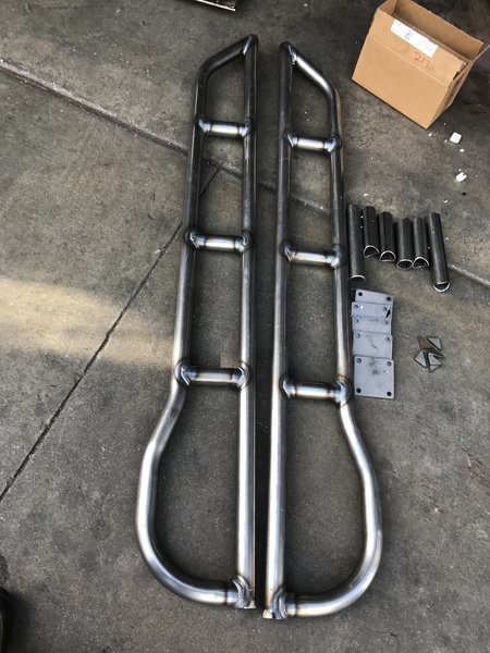

    Customer brought me these 4x innovations sliders to be finished and installed on his 4Runner

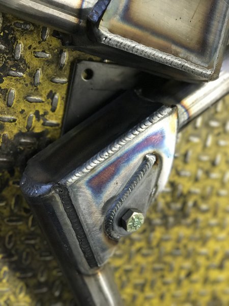

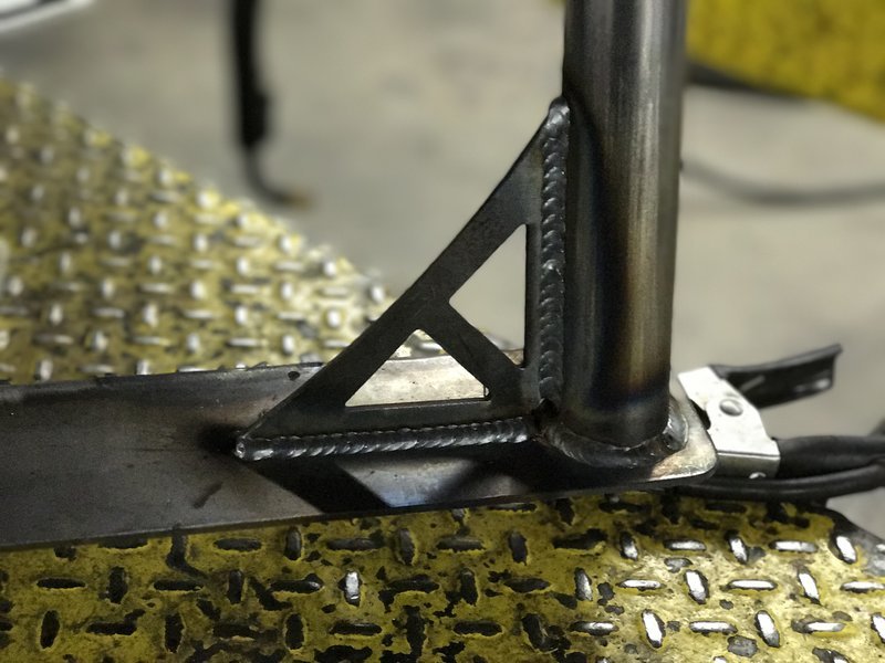

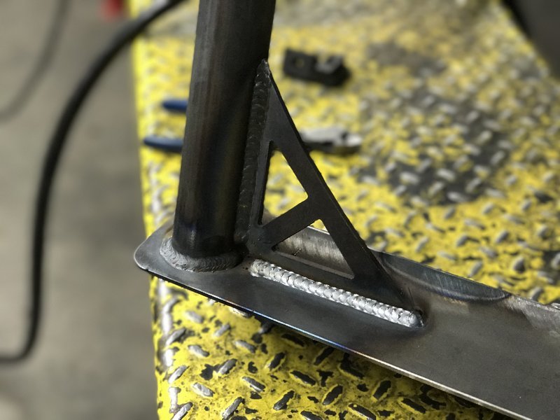

    Also started on another little project for a member. I'll hold off on posting pictures of of the whole project till it's closer to completed, but I did want to post some pictures of the gussets that I designed and had water jetted. I can't stand watching fabricators use the same off the shelf generic gussets over and over. I like to go the extra mile and design my own gussets for each project when the budget allows it. Gussets double as a tie down point.

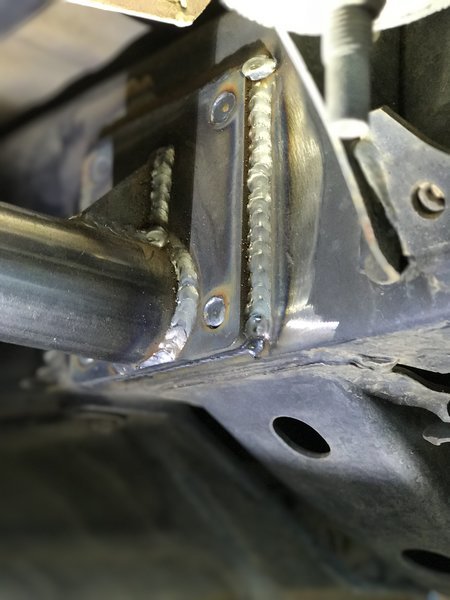

    Spent a long weekend at the shop.
    Picked up another welder Thursday night. I bleed miller blue. This will allow me to set up all of my welders for different types of results. I prefer having multiple welders so I'm always prepared incase one goes down or isn't running perfect. I may be listing one welder up for sale soon to make some space for a new price of fab equipment I'm looking to purchase.

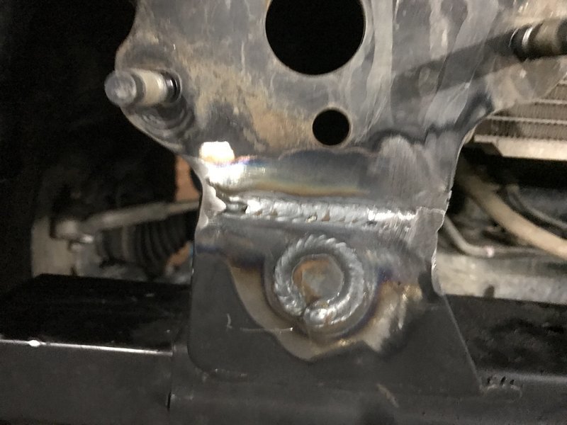

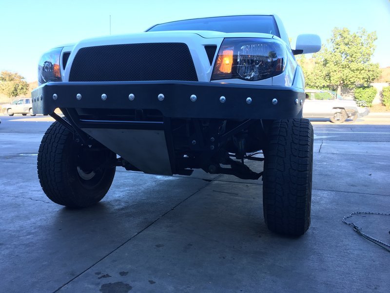

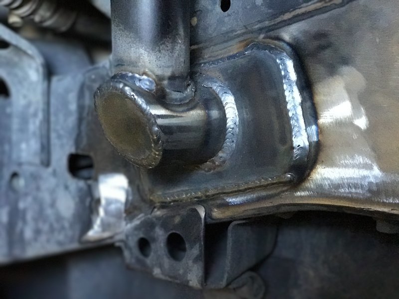

    Next I welded up a lower front crossmember that a @Mike likes Tacos had peviously removed.

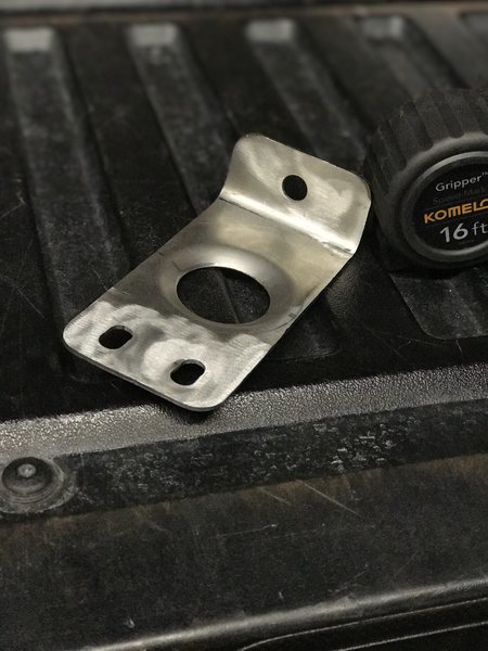

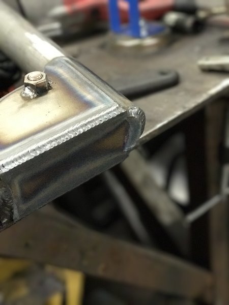

    Quick little fire stick mount

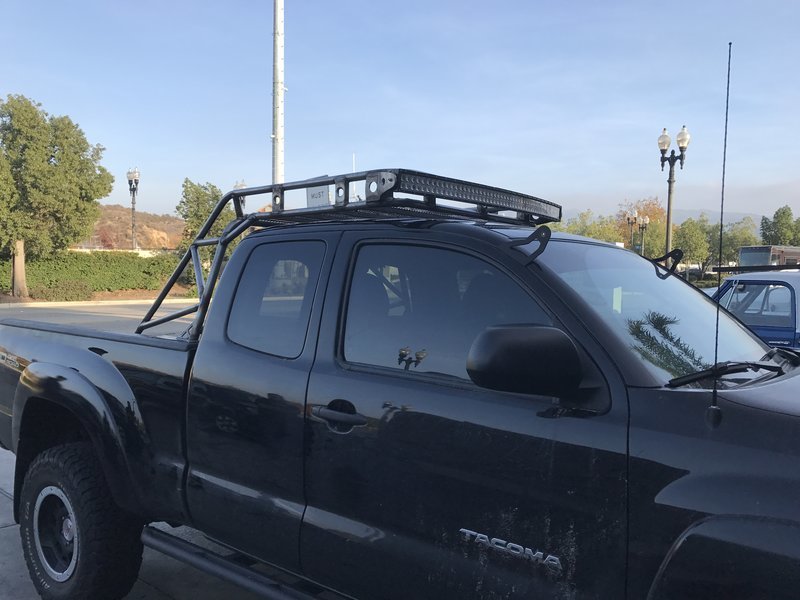

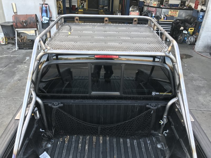

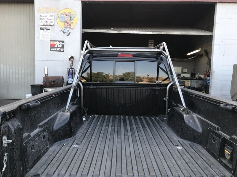

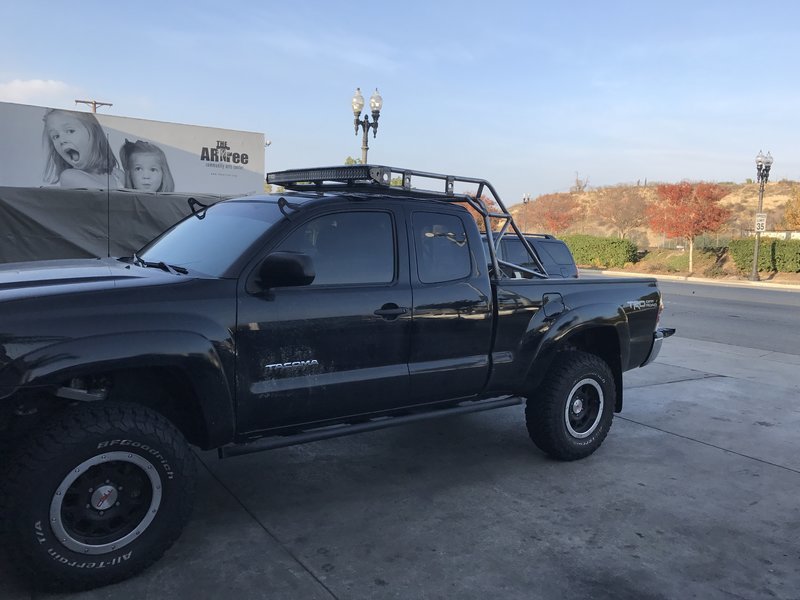

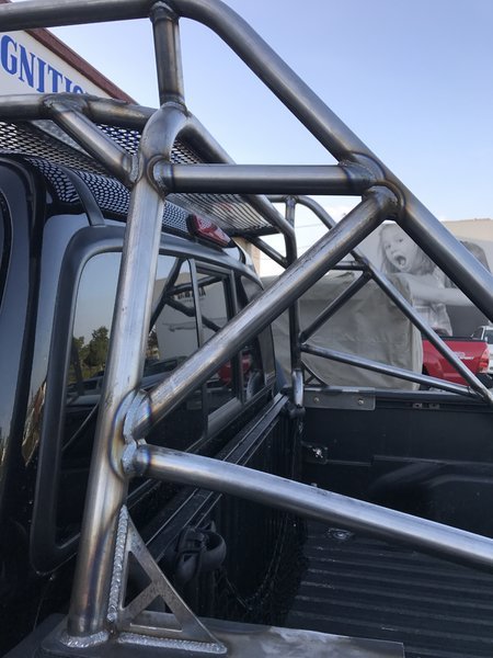

    Then we built a chase rack for another TW member. It involved lots of little details to mount his antenna and high lift.
    Thanks for the support TW members. More fun projects coming up in the next week or so

    Nice! Looks awesome.

    Thanks again for the help. That rack is sick!

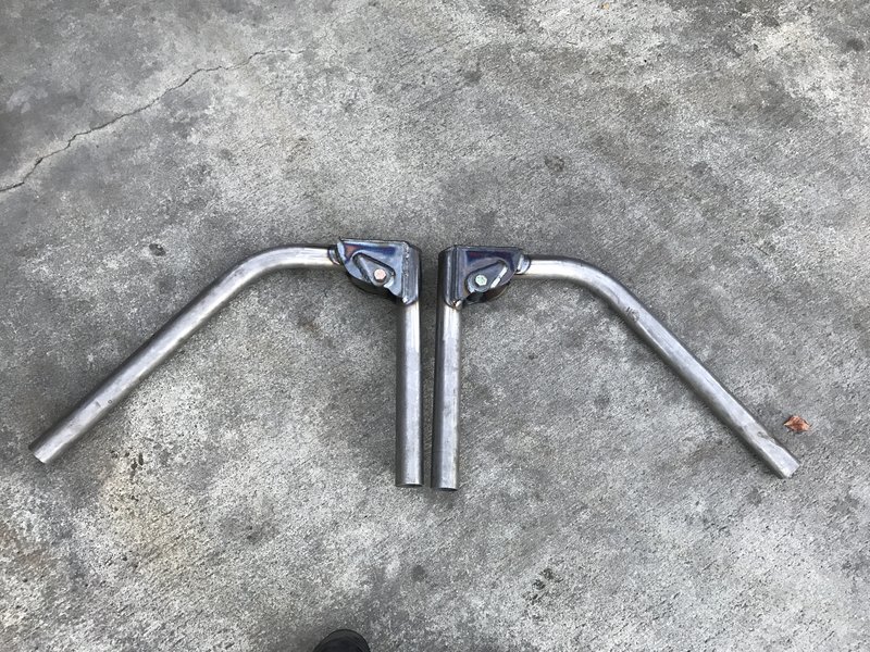

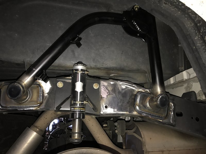

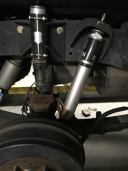

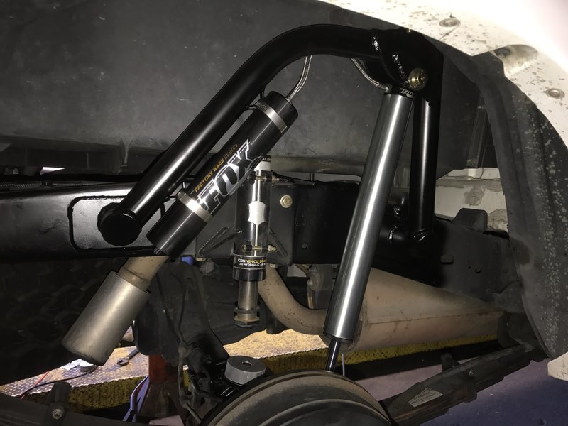

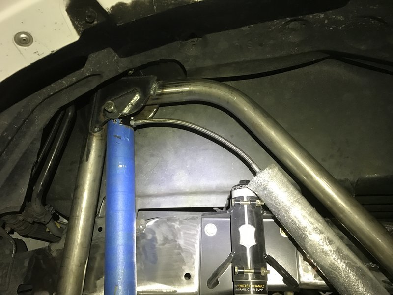

    Tc sua kit with fox 12"x2.0 shocks. Hoops built and installed by myself. Makes for what I would consider a great daily driven mid travel rear end.
    You can see how little up travel the tc kit had with stock length icon shocks by looking at the print on the icon bump stop. The combo of the new shock and new bump stop pads gained the owner approximately 3.25" of extra bump travel. Putting the bump to droop ratio at about 50/50
