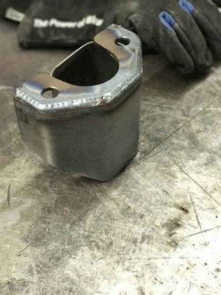

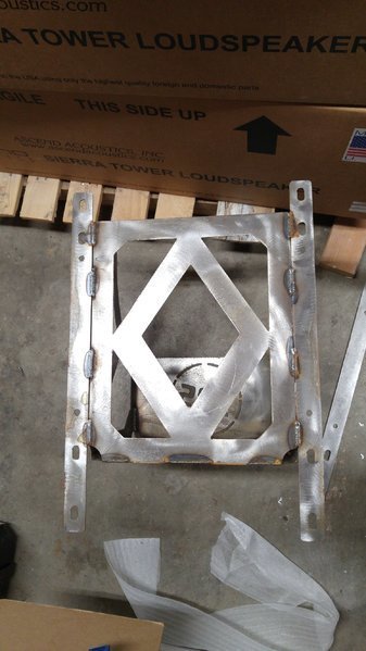

    Been super busy lately mostly with bolt on installs. Still try to weld everyday. Here's a little tab I threw together yesterday while trying to throw a stereo and a few other things into my new commuter car.

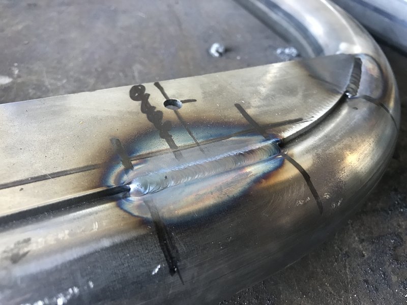

    Another set of jeep slider mounts ready for install this weekend

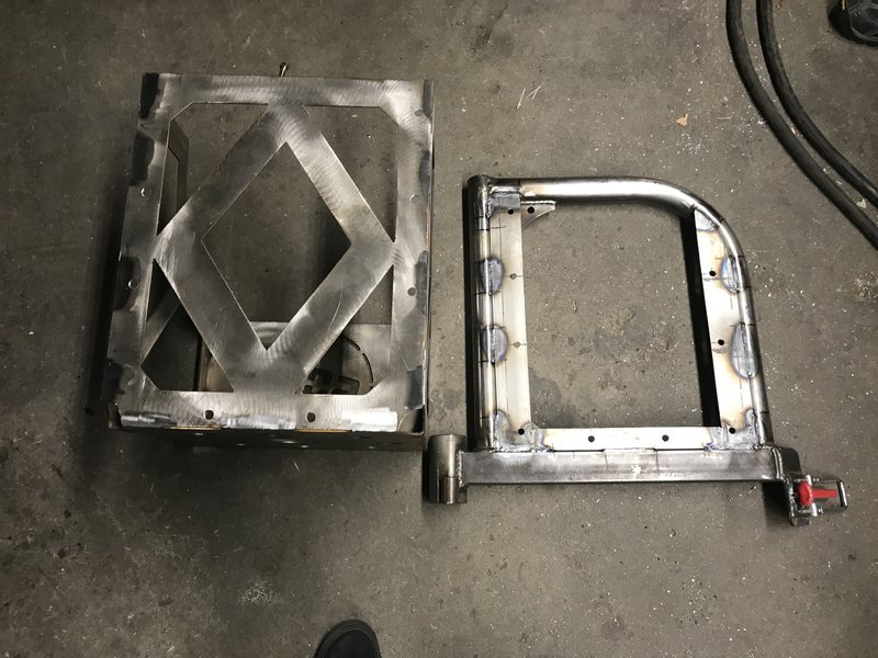

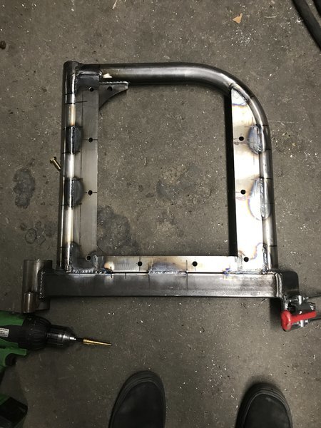

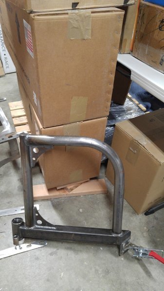

    Knocked out an exhaust reroute and pelfrey skid plate install for @sdheda last night. He also brought in a bumper swing out to weld a jerrycans holder onto. After discussing his plans we decided to add bolt on tabs which would allow for modular use of the swingout if his plans or build changed direction down the road.
    Before
    After

    Weld porn-so sexy! Nice work sir

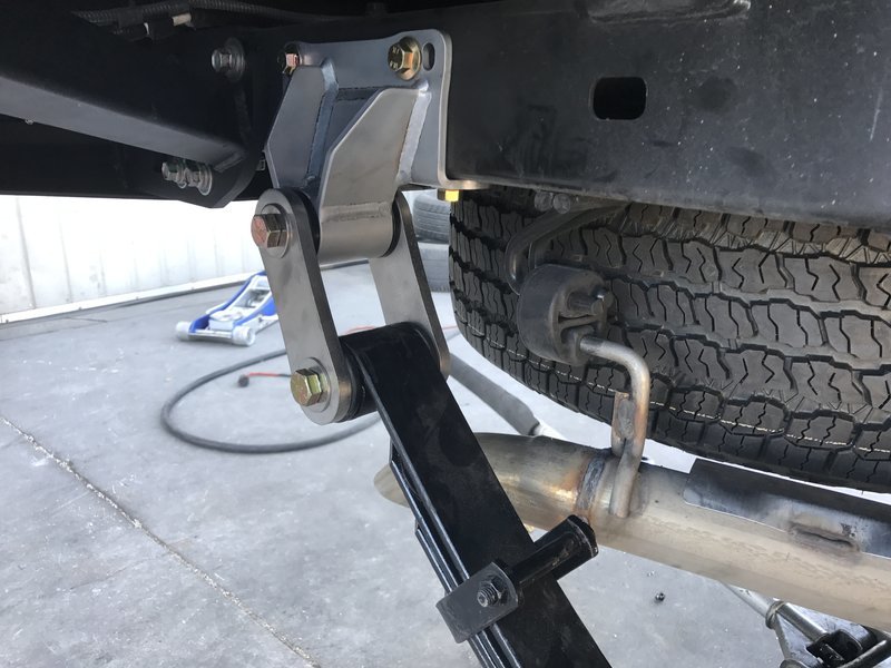

    Just left @glorifiedwelder shop. He installed the Archive Garage Shackle Flip Kit and couldn't be happier with the service and pricing. Highly recommend Jason!!! Thanks again man!

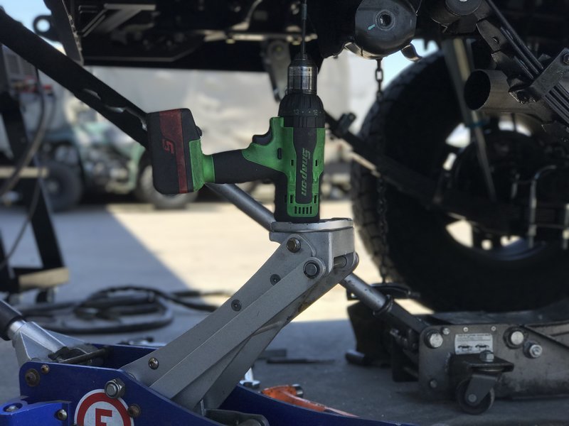

    Don't think my snap-on guy would appreciate the last pic

    Is the shackle going backwards ??

    That's what the shackle is supposed to look like at full droop. This truck is using the TC sua setup so the settings with one hole drilled will look a little drifferent than with a soa

    The Deaver U539/540's really curl up under droop. There is extra holes in the brackets to assist moving brackets forward for better shackle angle, but requires drilling some extra holes. Really not to bad though

    It should also be noted that we opted to drill one hole moving the shackles forward a little bit. We could have drilled 4 for a better shackle angle at full droop but the main reason the owner of the truck went with the shackle flip was to gain the 1.5" of lift that this position gave him.

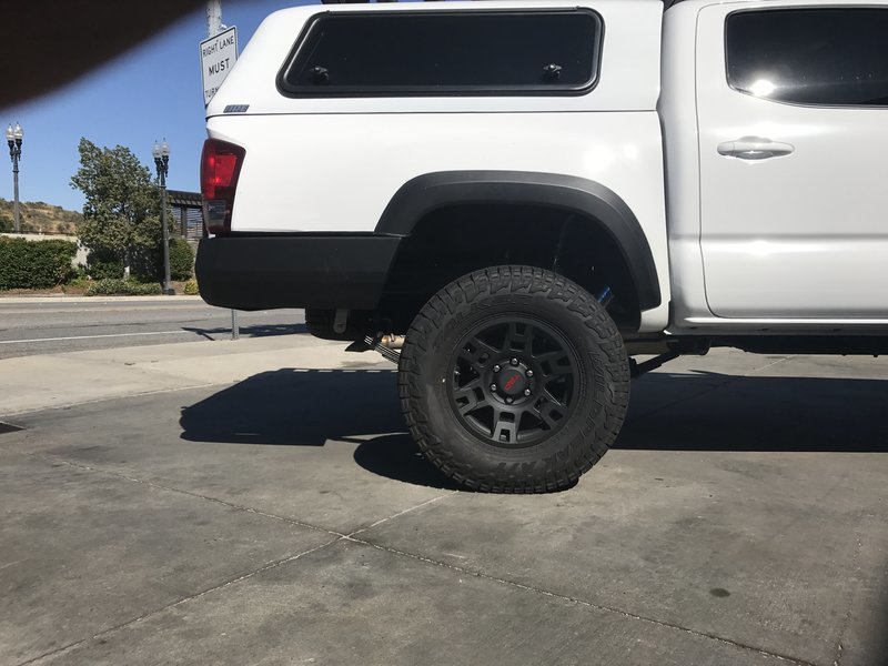

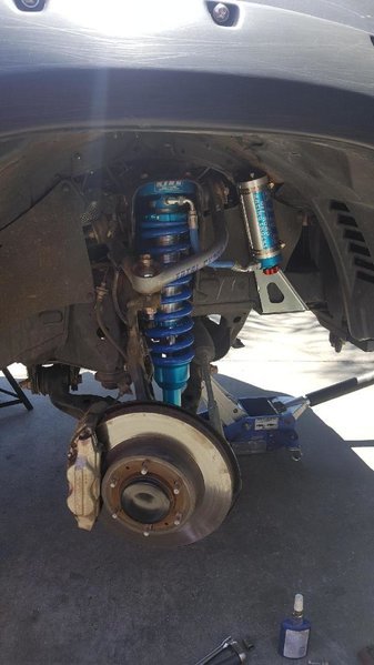

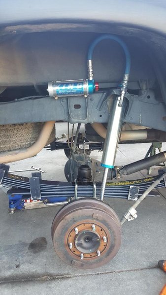

    Today we installed king coilovers and shocks with compression adjusters, OME Dakar leaf springs, front and rear superbumps, as well as +4 rear brake lines on @PNOYTACO627's third gen

    Are those dakars modified?? They look kinda flat lol...spring retainers look different

    Nope, standard dakars from @Wheeler's Off-Road Inc
