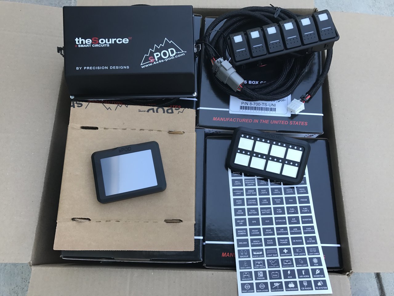

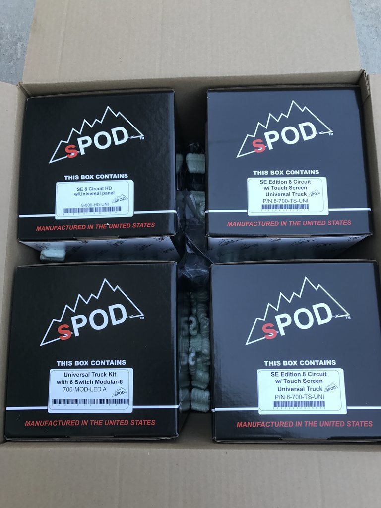

    One kit shipping out tomorrow and three kits I'll be installing. Stoked to be a retailer for what is possibly the best wiring solution on the market. Built local to So Cal. By a fellow tacoma owner.

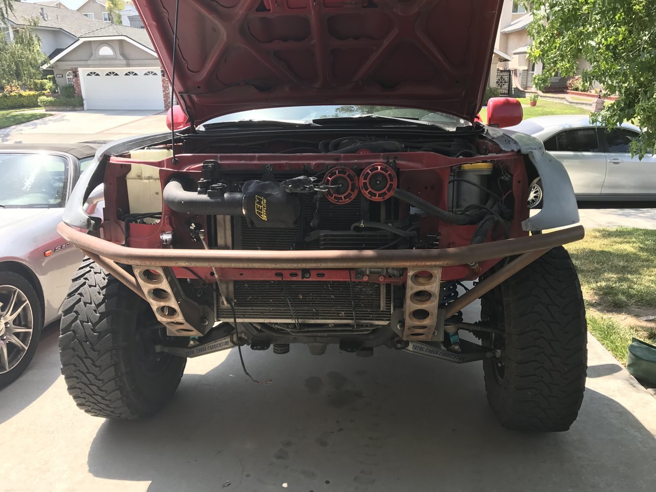

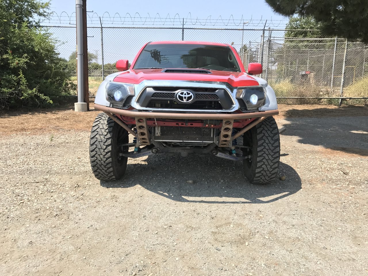

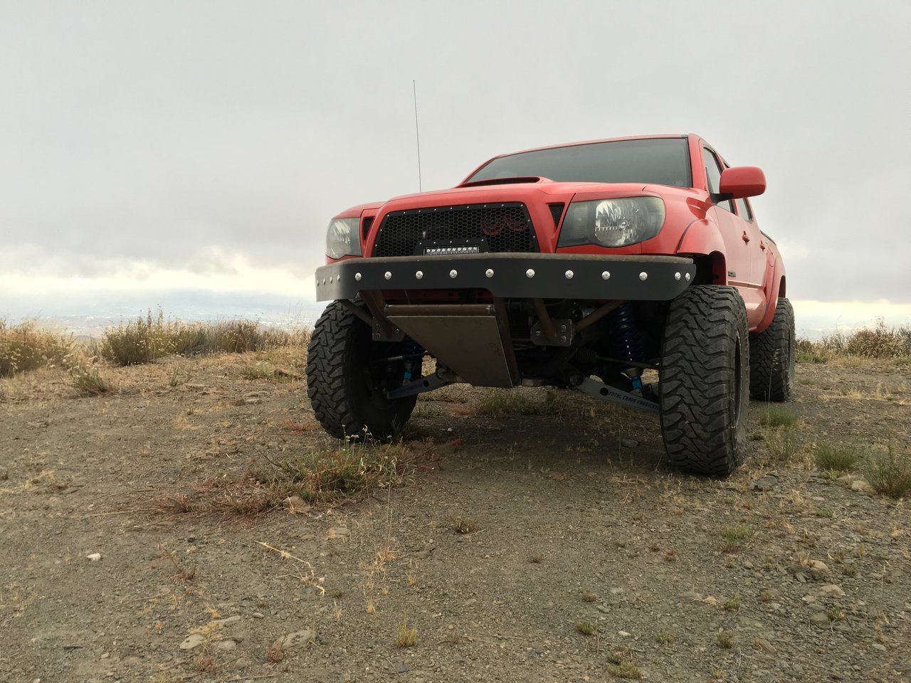

    Finally spent some time working on my own truck. Trying to spend atleast one day a week chipping away at the stockpile of parts I've purchased for my own build. It's funny how you could have a whole shop full of tools and you still revert back to putting your truck together in your own driveway.
    2006 to 2012-2015 front end swap as well as rebuilding a set of retrofit headlights. Trying to get the truck ready for paint
    Before
    Midway
    After

    Always exciting to see what you've done to your own truck. With the new fender out front, they look a bit wider. Gonna move up to 35's?

    Yeah those are 34's. I'll atleast move up to 35's. The trucks suspension is being setup for 37's , but I'm not sure if I hate myself enough to swap up to 37's

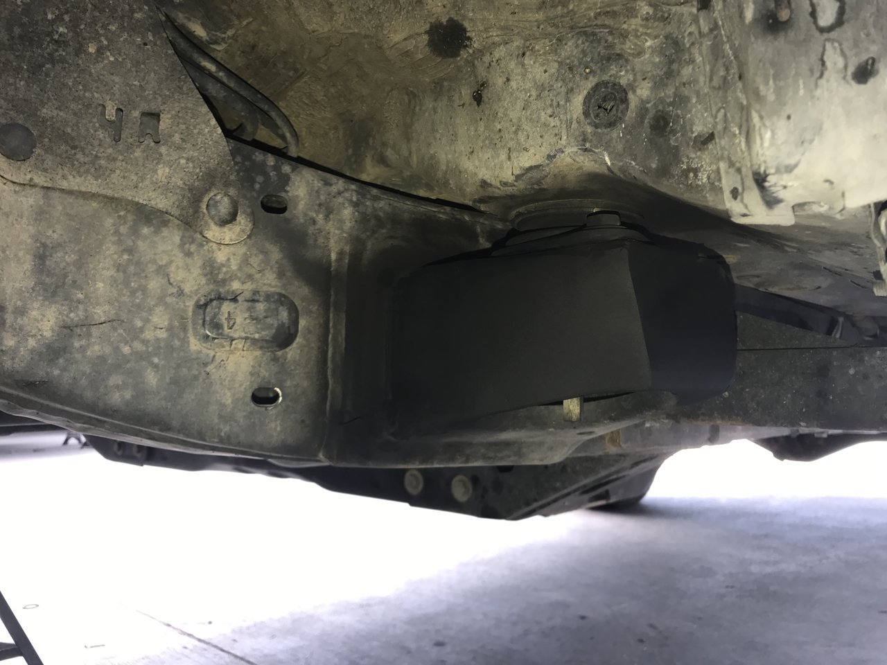

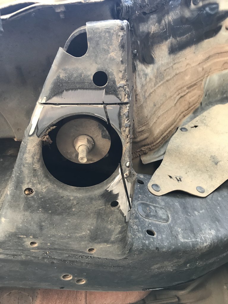

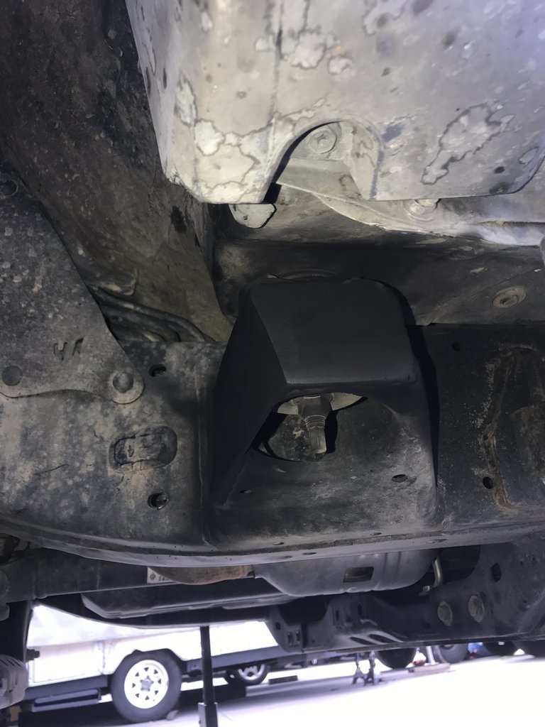

    Cab mount chop on a second gen

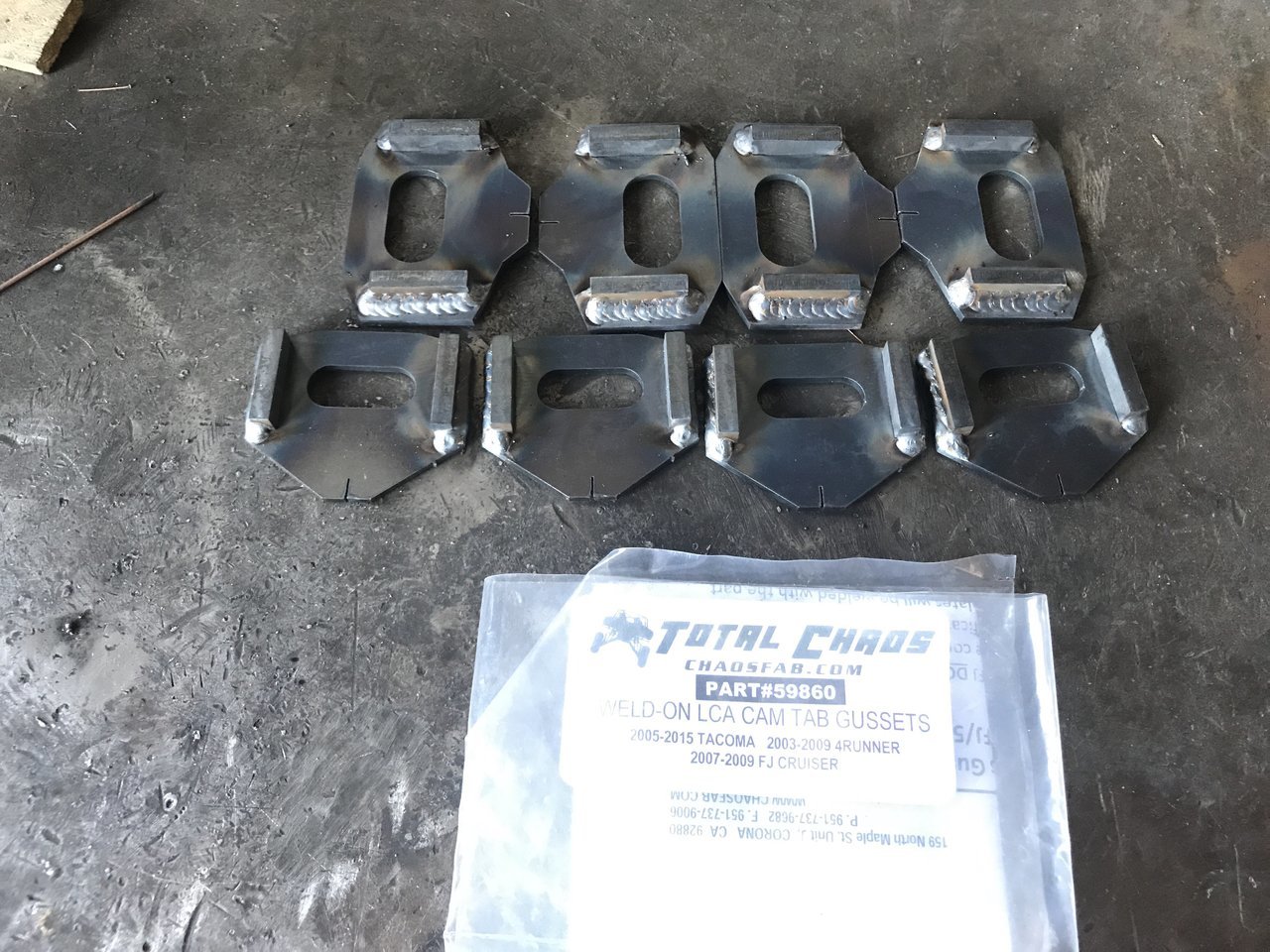

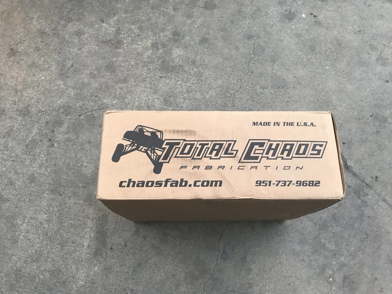

    Prepped a set of total chaos cam tabs and shipped them off to the east coast

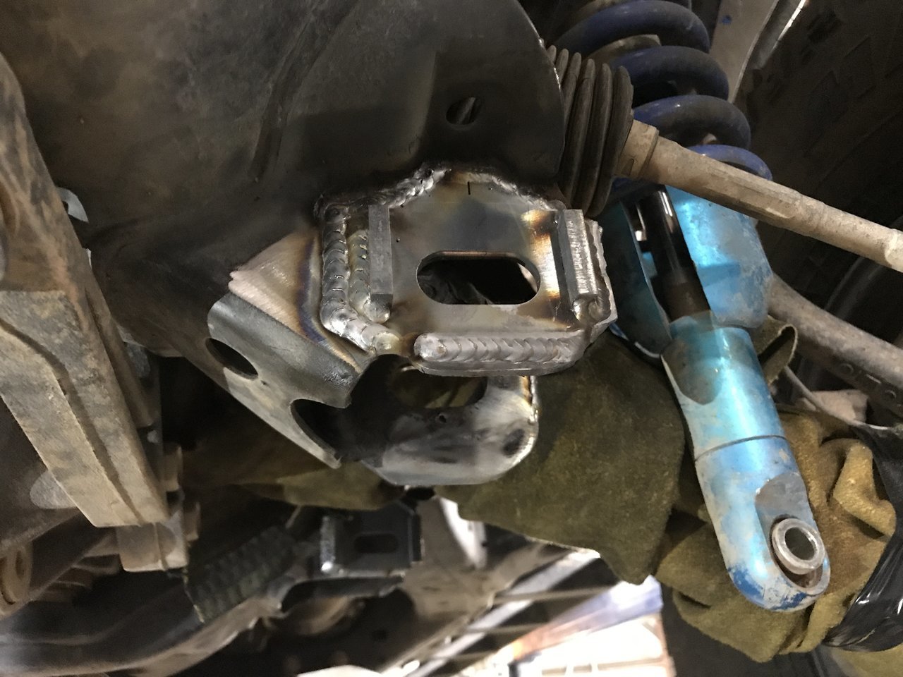

    Is it necessary to weld the sides? Or is just the back good?

    You could probably get away with just the sides (I weld the sides and the bottom), if I went that route I'd probably tiig weld them to be safe. But it's definetly a lot strong with the side of the tabs welded since all the force is now pushing against the weld and not pulling at it from the side.

    Total Chaos Cam tab install that went down last night on @inv3ctiv3 truck

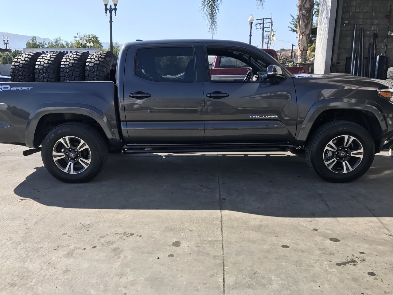

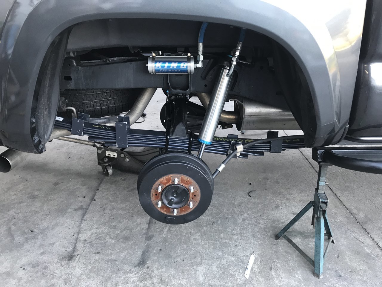

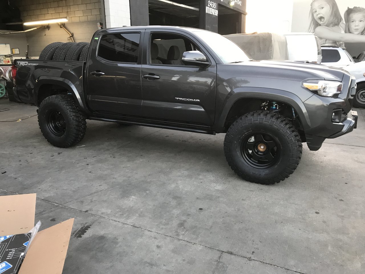

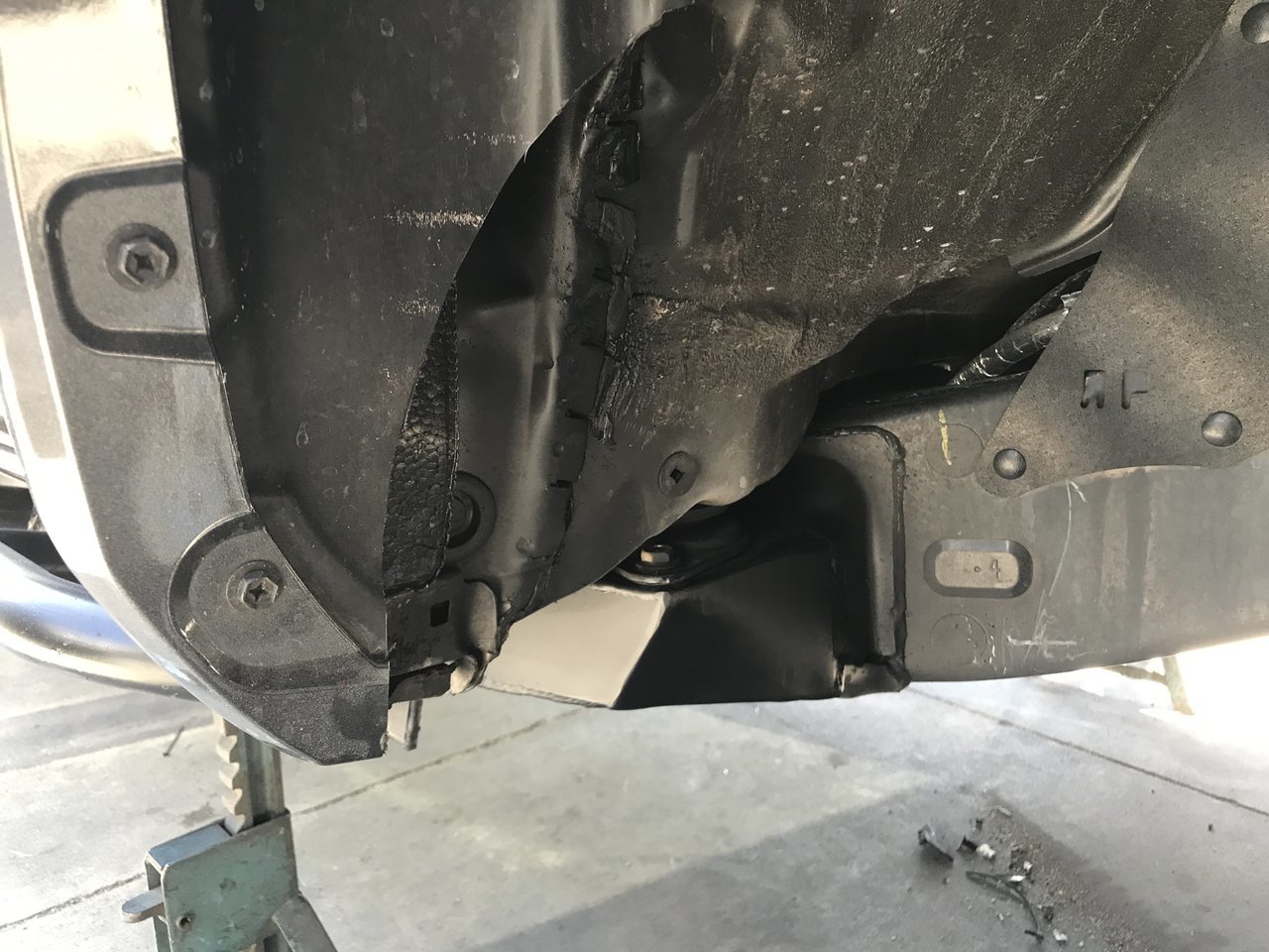

    Another 3rd gen install. Cmc, front and rear kings, total chaos uca's, Ome Dakar springs, and 35" km2's mounted on scs wheels. Sweet ride @Mr3yn0lds
    Before
    After
    Cmc, pinch weld rolled and fenders trimmed

    Rear suspension
