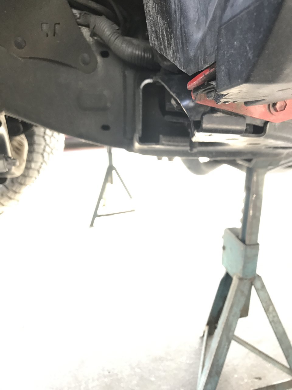

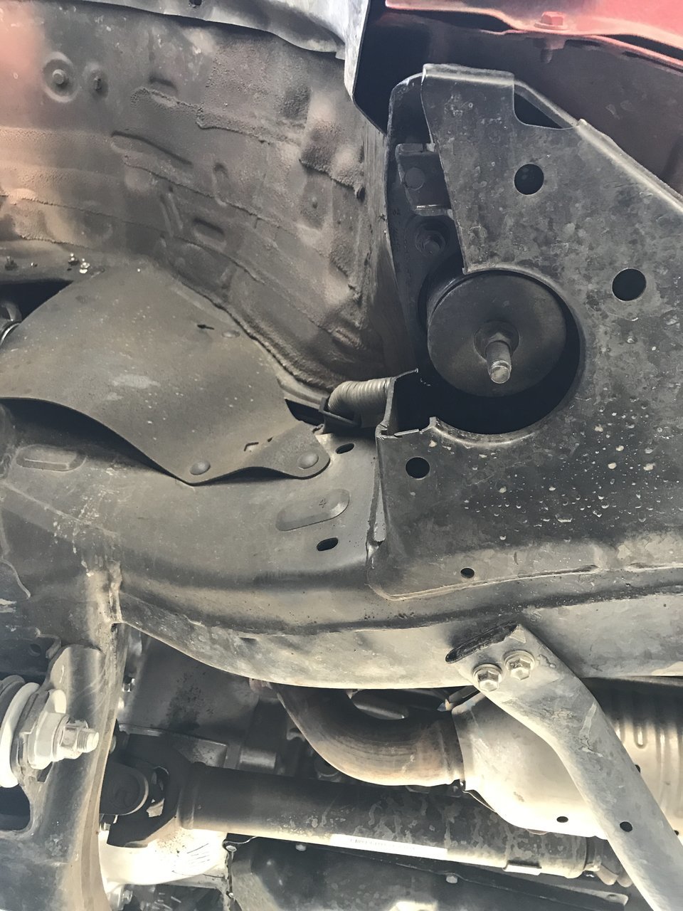

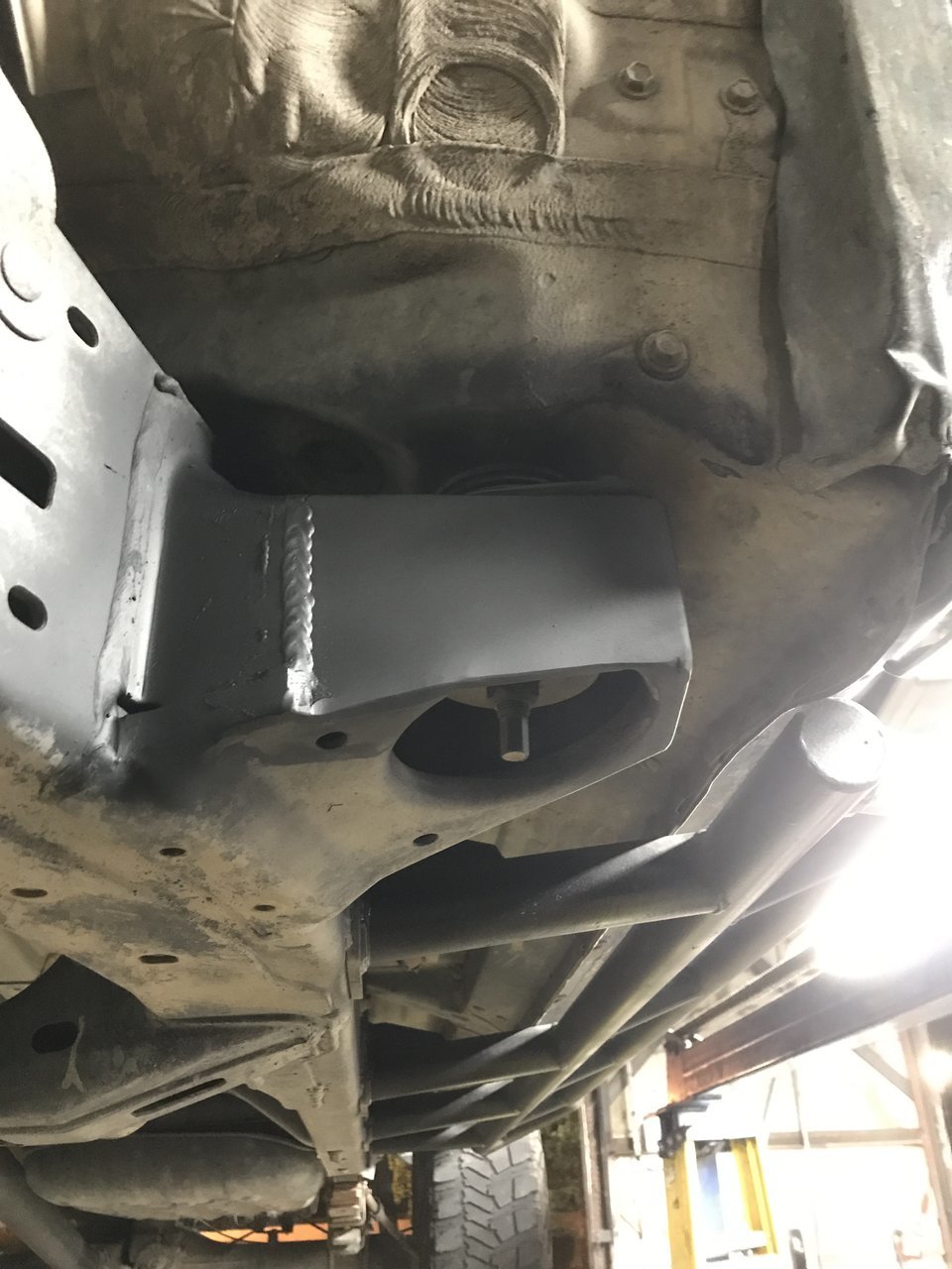

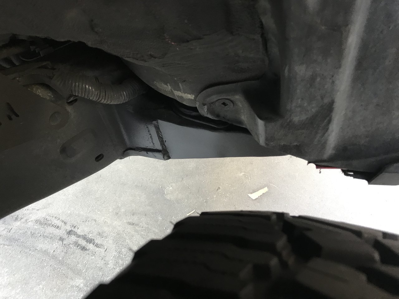

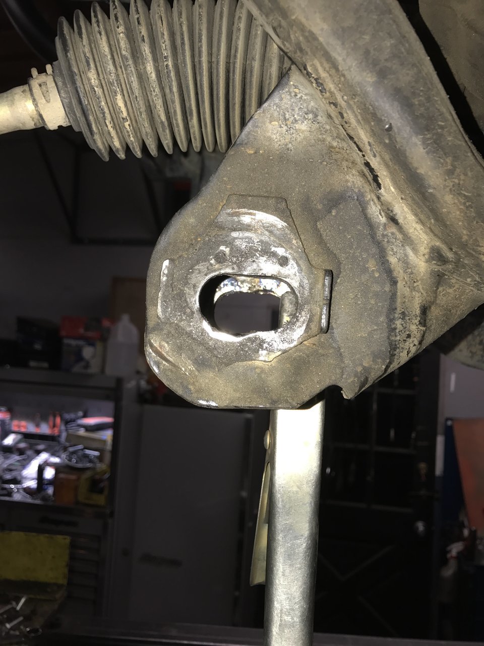

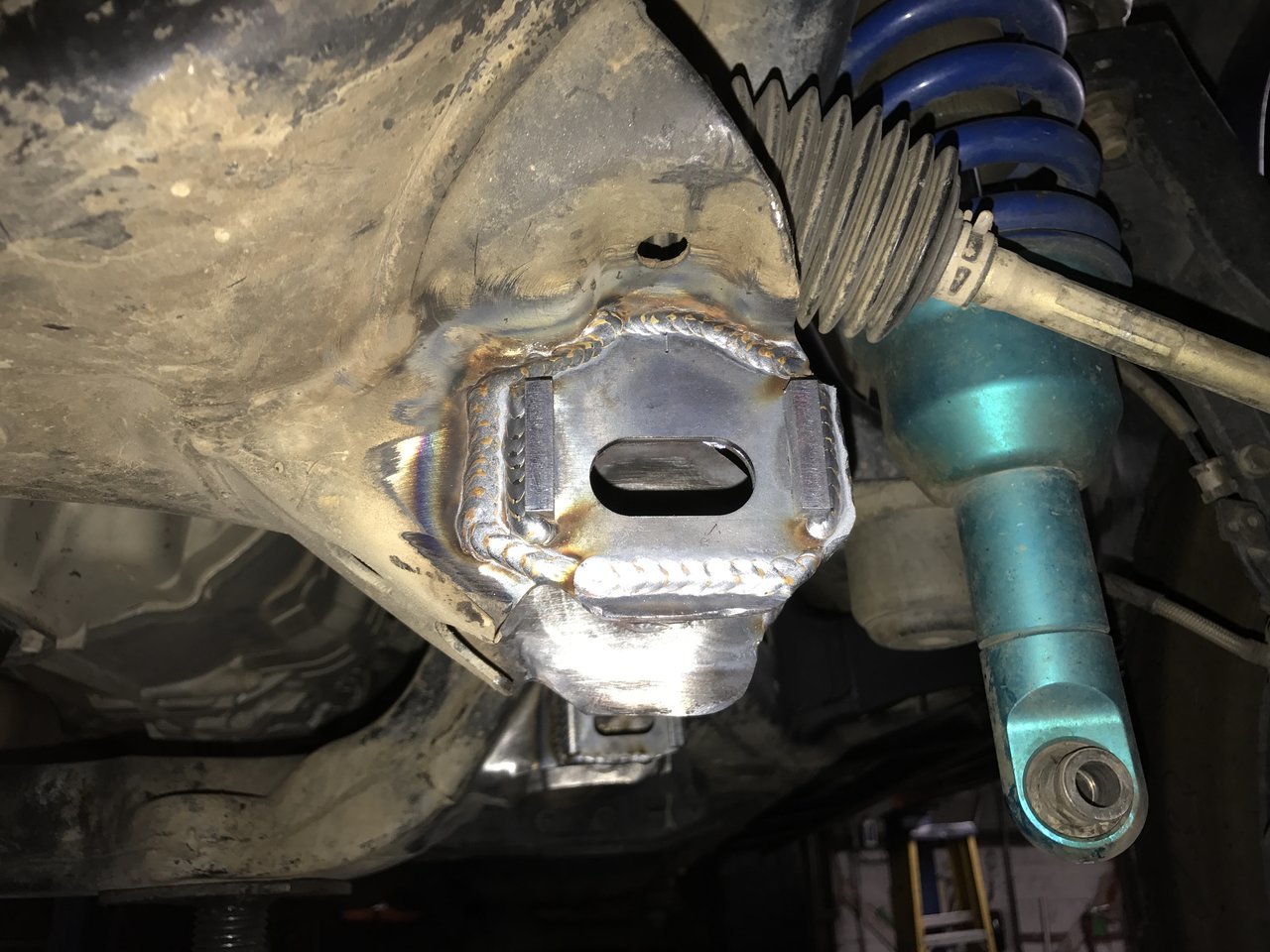

    Forgot to post these up. Not the style cab mount I prefer doing (my normal style offers more clearance) but this was done to repair a cab mount chop another shop started and butchered . Their wasn't enough material left to make the cuts I normall make so we did it similar to how everyone else does theirs but with a few minor improvements to give it more clearance then can be achieved with a flat one piece plate.
    Before
    After

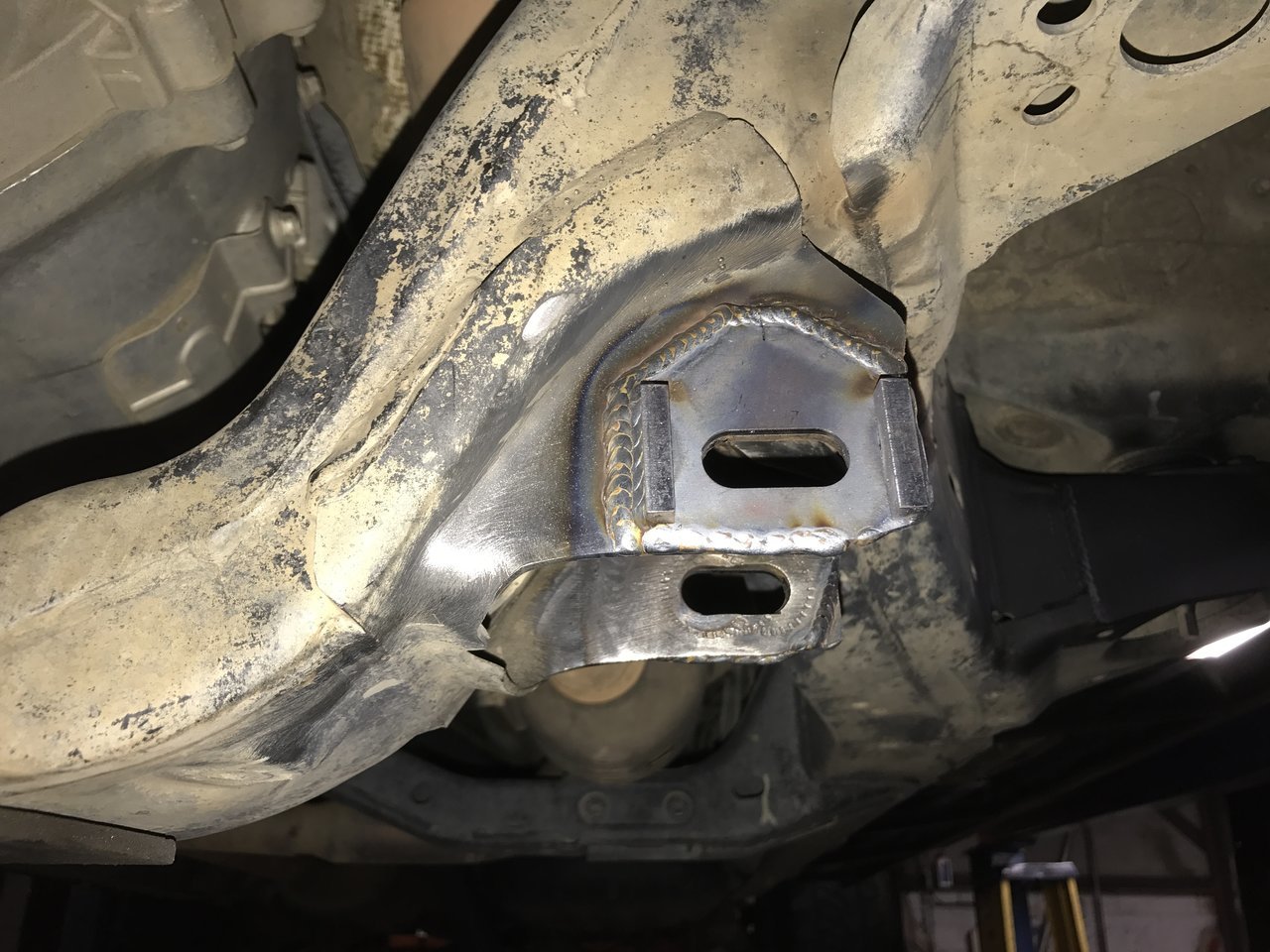

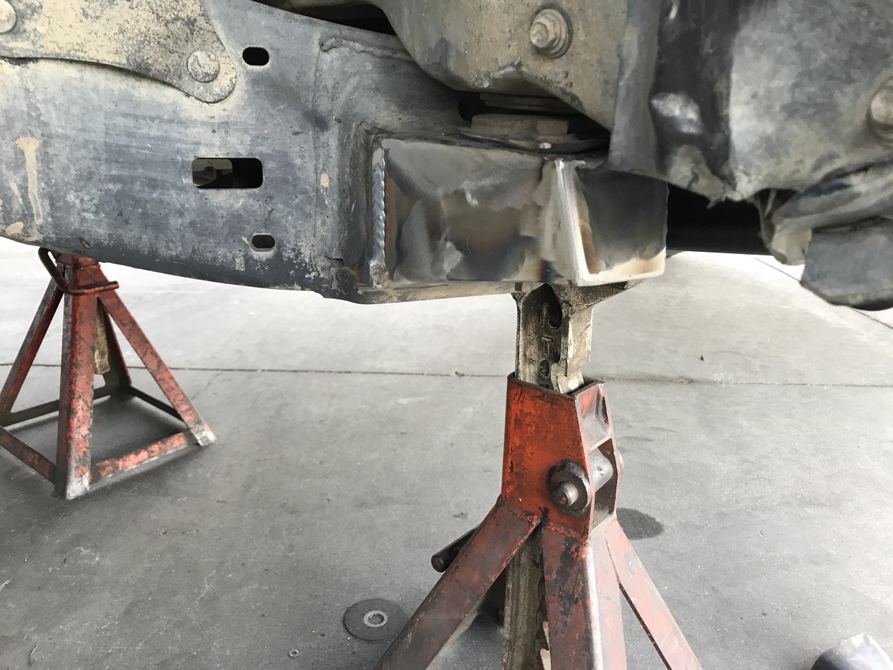

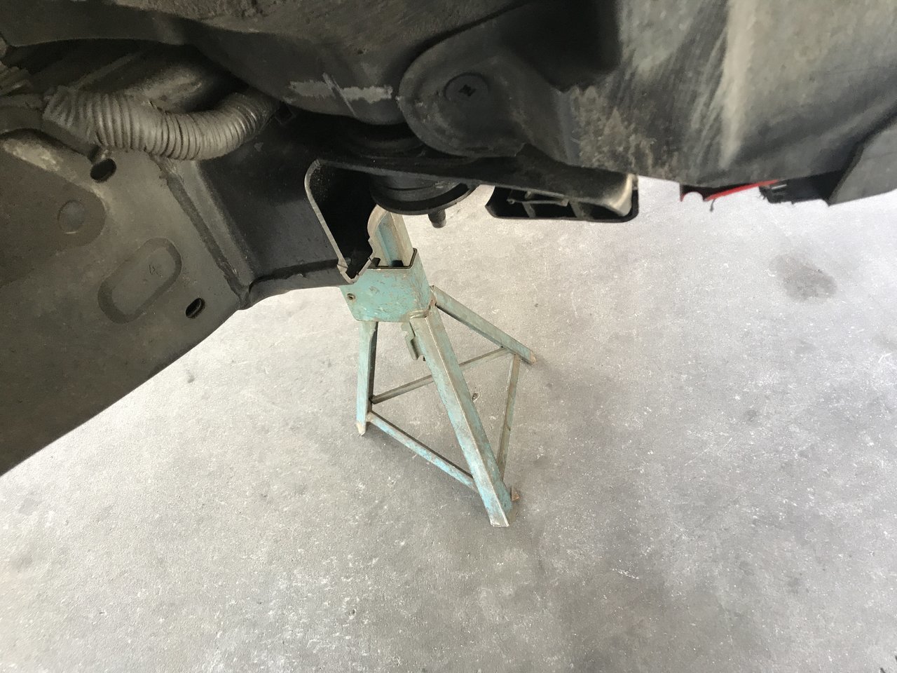

    Cab mount chop and TC cam tabs we did last night
    This is one of the reasons it's better to do cam tabs before you actually need them
