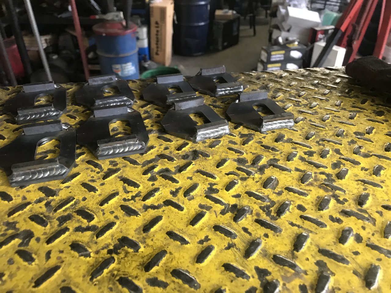

    Back in the shop after a weekend of wheeling and fishing in the sierras. I’ll be getting around to returning all this weekends messages today.

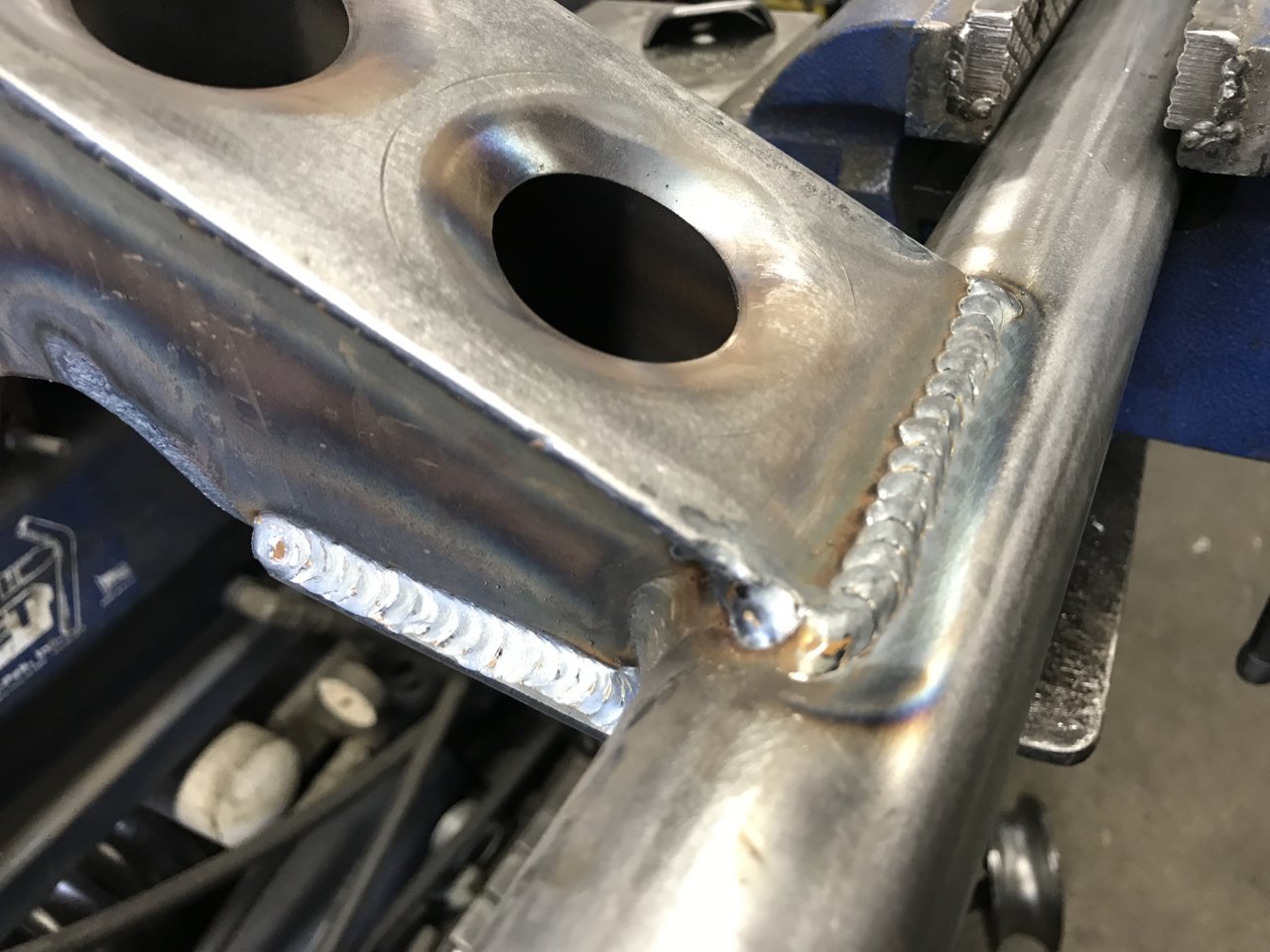

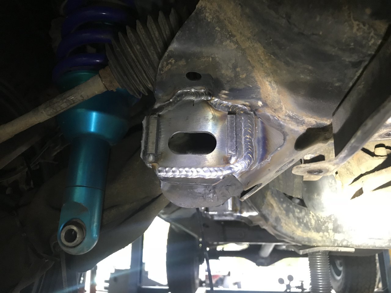

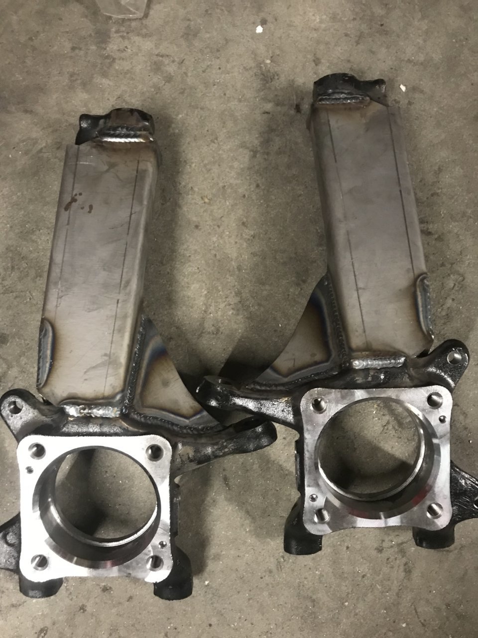

    Knocked out a cam tab gusset install and a gusseted a set of new spindles last night

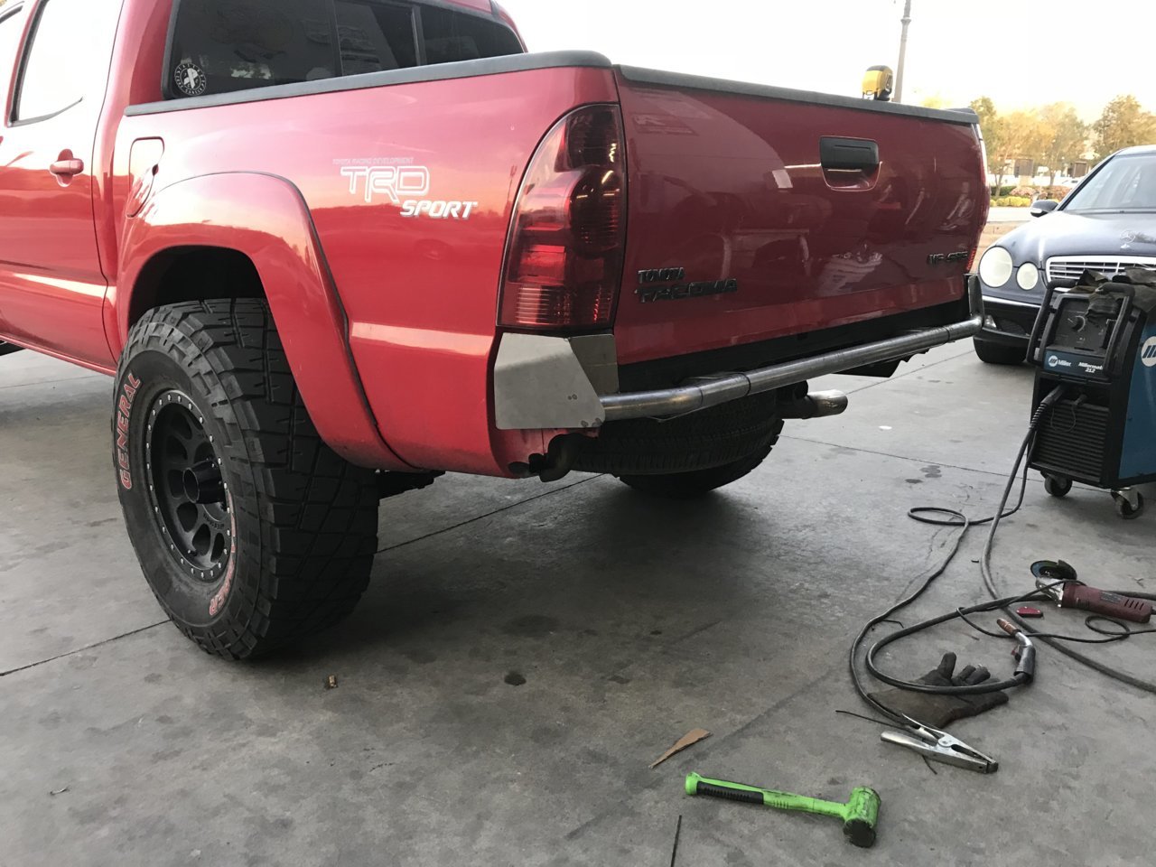

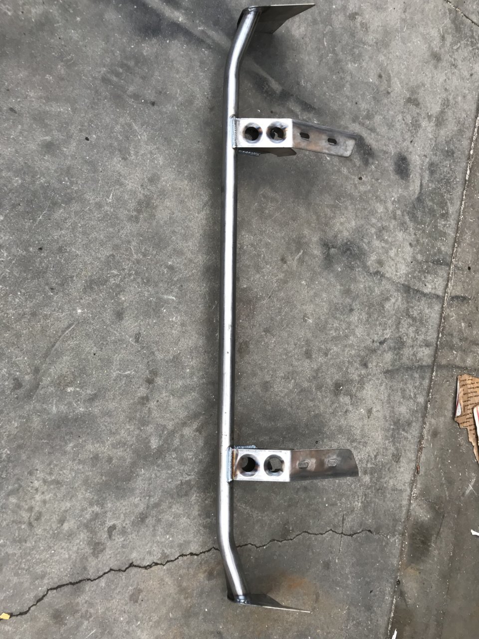

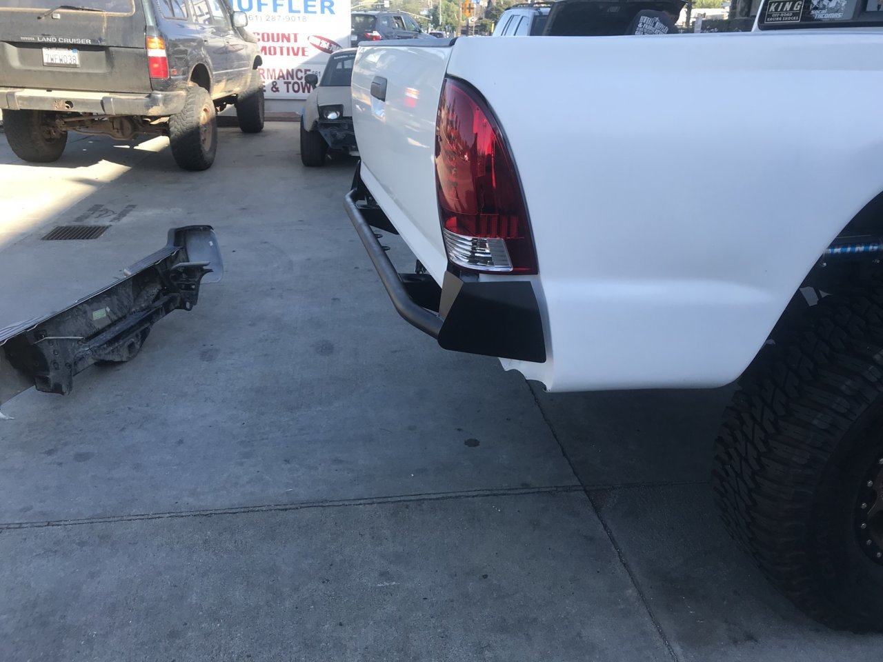

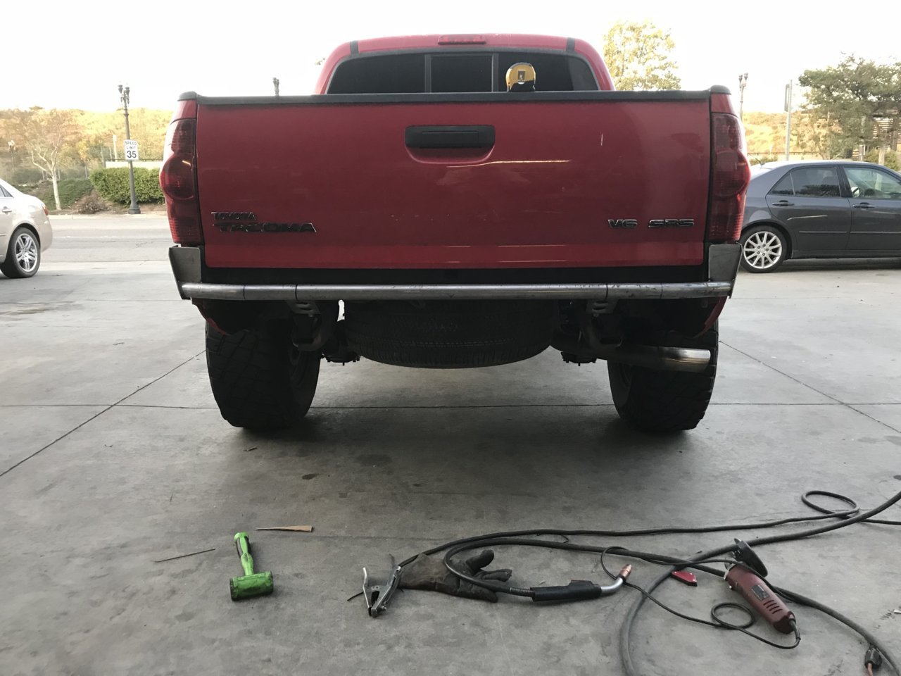

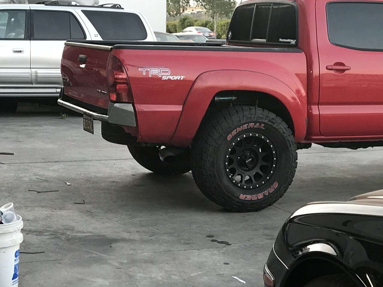

    Wrapped up the basic version of my rear tube bumper last night, it’s designed to shave weight, protect from incidental contact, and allow the fenders to be trimmed to allow for better approach angles.
    Waiting for a delivery of tubing and plate and I’ll be getting started on an HD version of the same bumper with a tow hitch as well as wrapping up a production rear shock hoop.

    what happened to the zip ties !?
  7. May 2, 2018 at 10:28 AM
    #667
    glorifiedwelder
    glorifiedwelder [OP] IG= @Liquid_Torch
    Feb 14, 2015
    #148647
    3,658
    jason
    Santa Clarita, ca
    double cab trd sport
    Saving those for the HD version

    Looks killer! will you be making a version with a hitch reciever?

    Thanks. At the shop working on an HD version with hitch for my own truck.

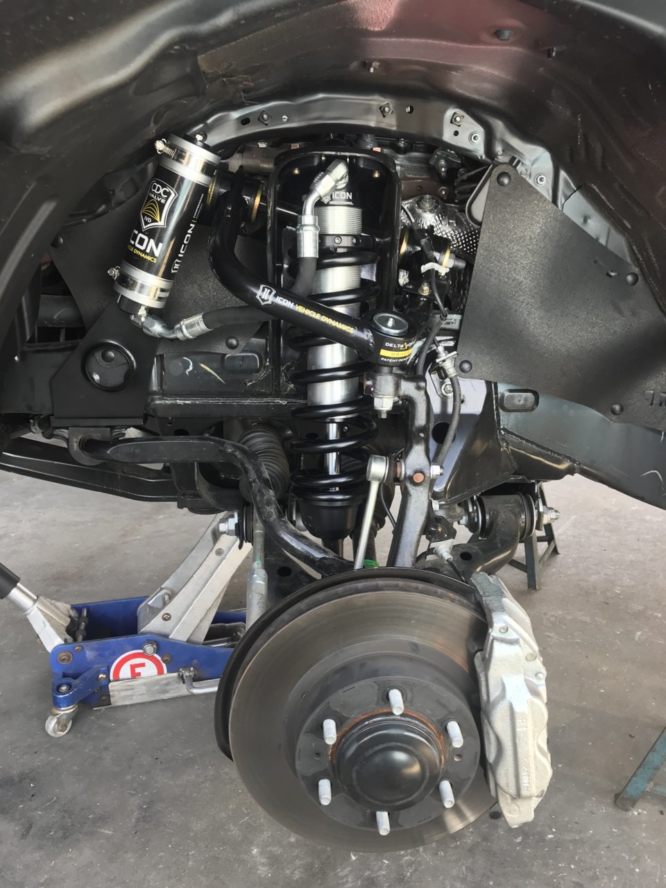

    Saturdays work. Icon stage 9 install on a 3rd gen. Leaf springs were missing a few parts so we had to hold off on installing them.

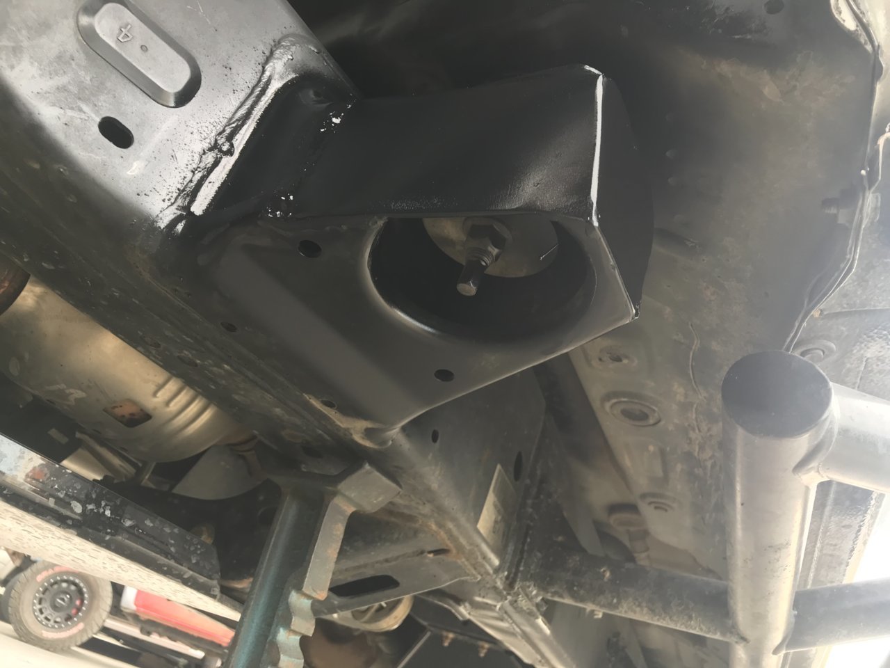

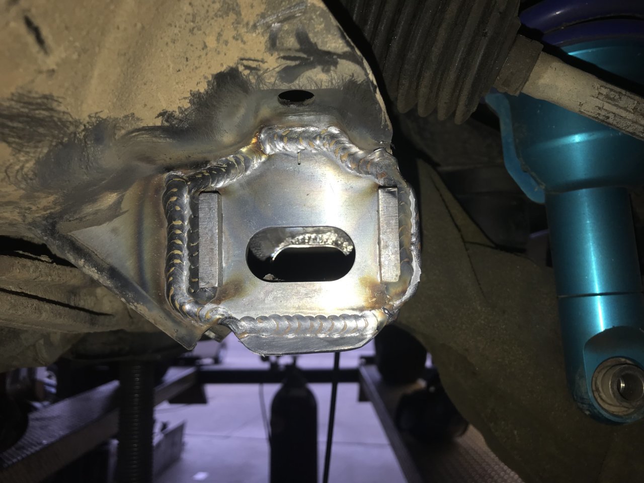

    One of a few cmc’s we did last week

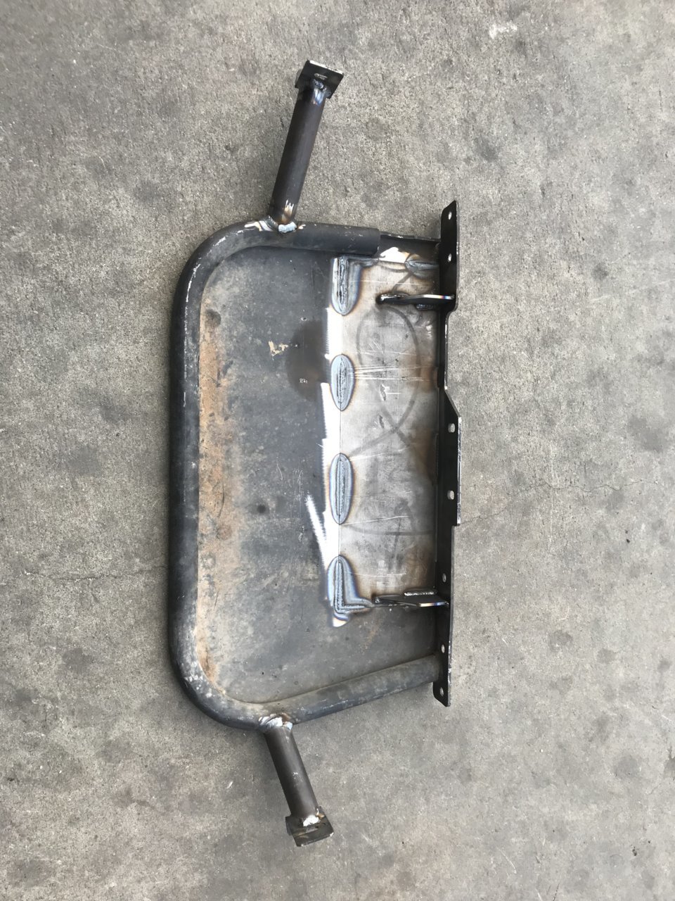

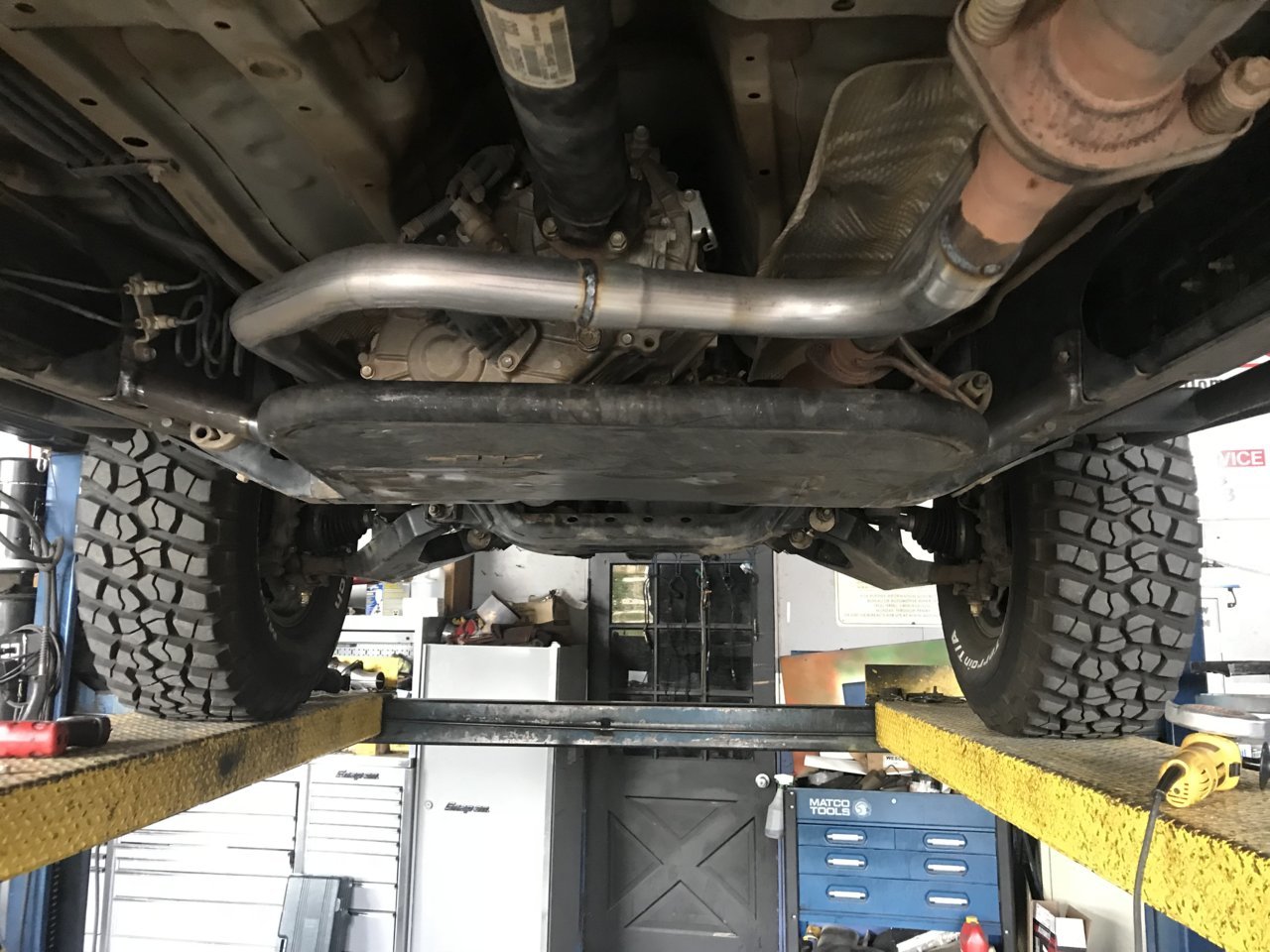

    Here’s @Mike likes Tacos transfer case skid. He bent the mounting points on it. So we straightened everything out, welded new legs on it, added some gussets, and rerouted his exhaust so we could cut the low hanging exhaust jump off the skid.

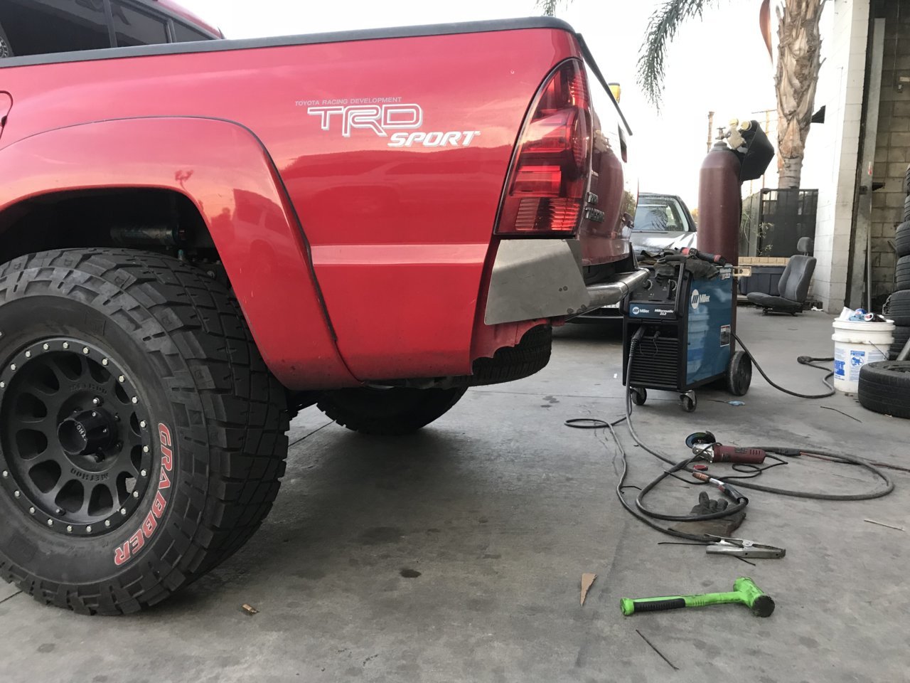

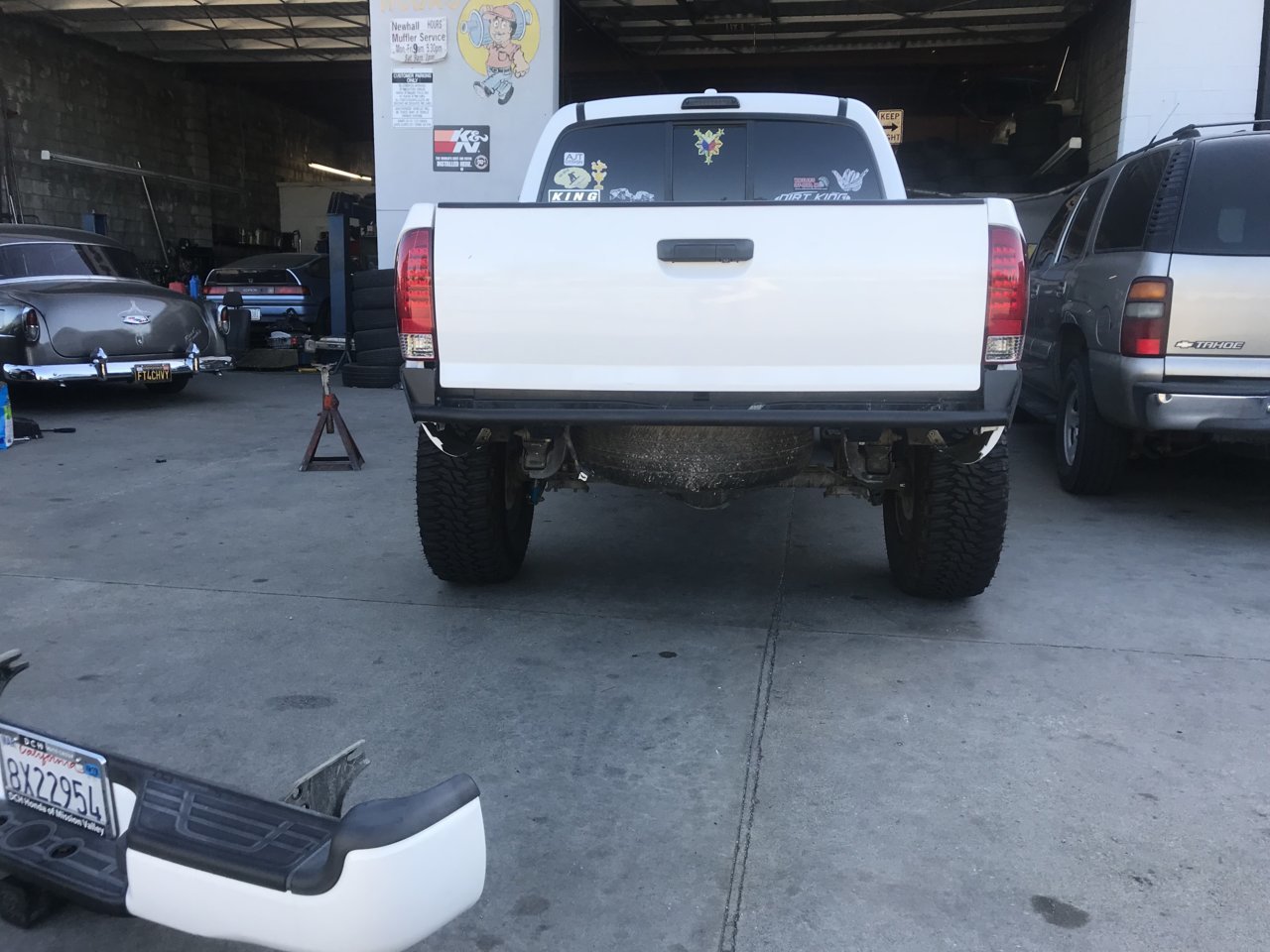

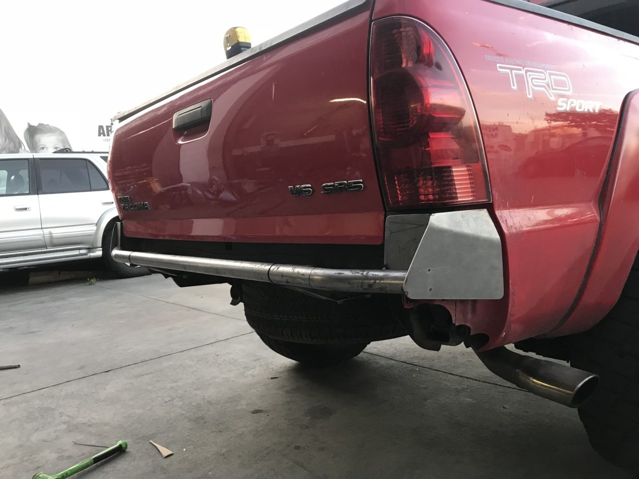

    Built a rear bumper for Sheldon’s truck which also happens to sport a front bumper we made a year or two ago
    Here’s a pic from after he trimmed his fenders

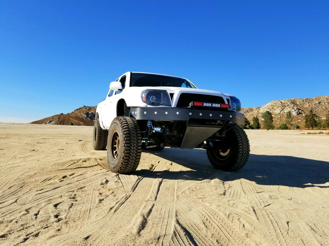

    Here’s the front bumper we built. Now that he’s gone LT and added glass fenders we’ll be reworking the front bumper to fit the wider fenders

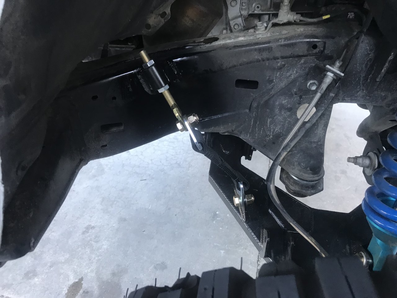

    Set up some limit straps on a Dirt King Lt kit

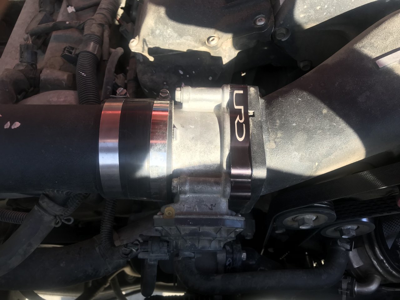

    Been making it a point to schedule an appointment with myself every week for my own build for the last month or so. Last week was a 70mm throttle body install and port matching the blower intake to the new larger TB

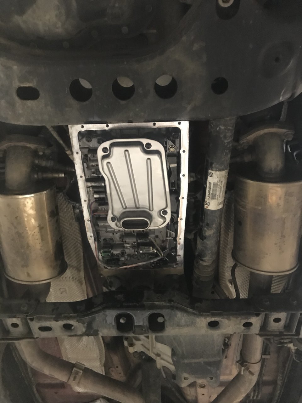

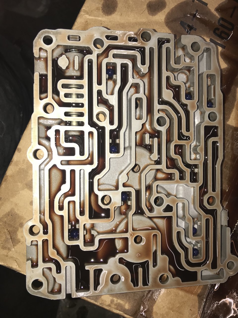

    This weeks appointment was to install a Ratiotek shift kit, and do a transmission service to help firm up my shifts under boost.
