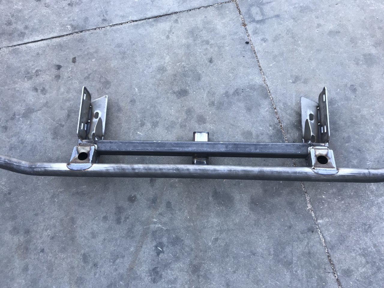

    The HD version of the bumper will currently only be offered locally. The tolerances are extremely tight with the tow hitch installed, ~1/4” and would require a sacrifice in design to open that tolerance up enough to guarantee proper fit when being installed by someone besides myself. I’m sure after the first few go put locally I’ll be able to open up the sale on bumpers not installed by myself.

    I’m sure I’ll be sending them out once I install a few more of the he versions. The places the fit is tight at shouldn’t and hasn’t varies between the few trucks I’ve test fit it on, but I want to confirm that on a few more prior to Having someone else do the install.

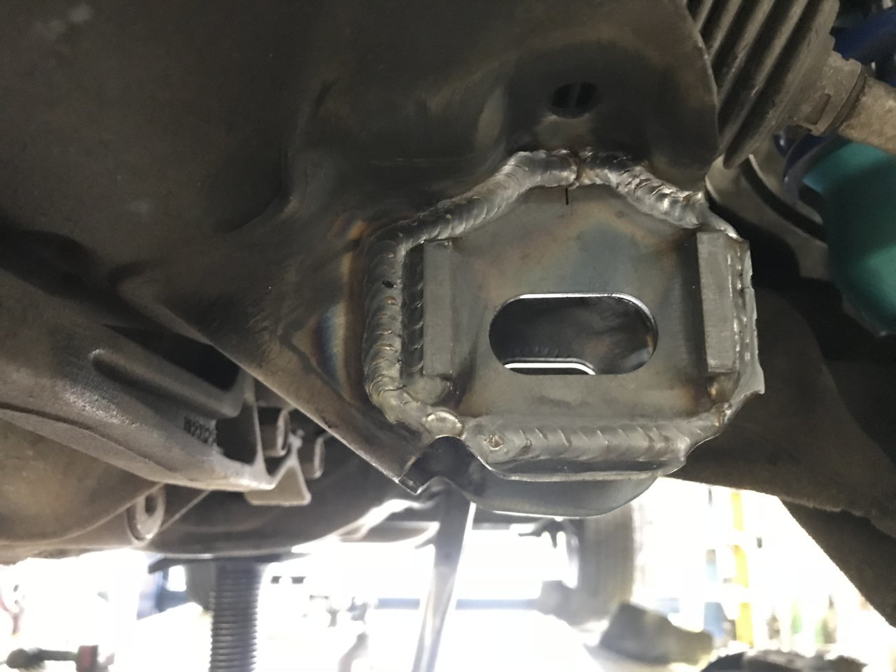

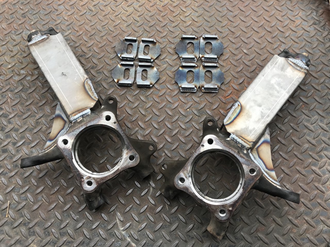

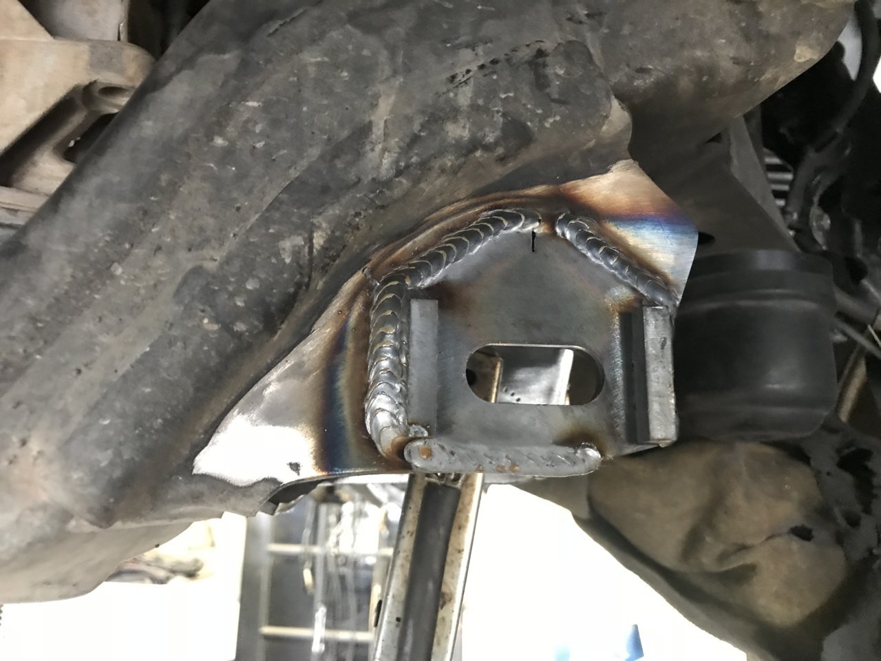

    Installed TC cam tabs, spindle gussets, and chopped the cab mounts on @RubberTank truck

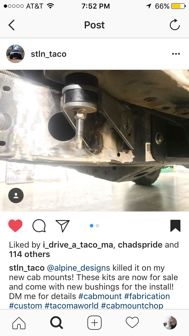

    Ordering the Alpine design cab mount relocation next week. @glorifiedwelder if you are able to cut the old ones and put these on please DM me a price quote.

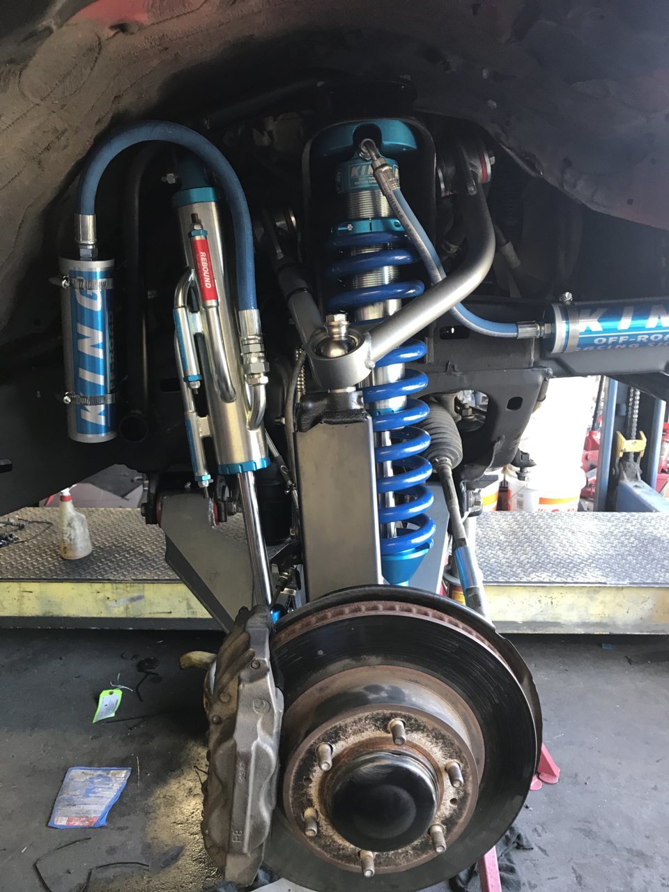

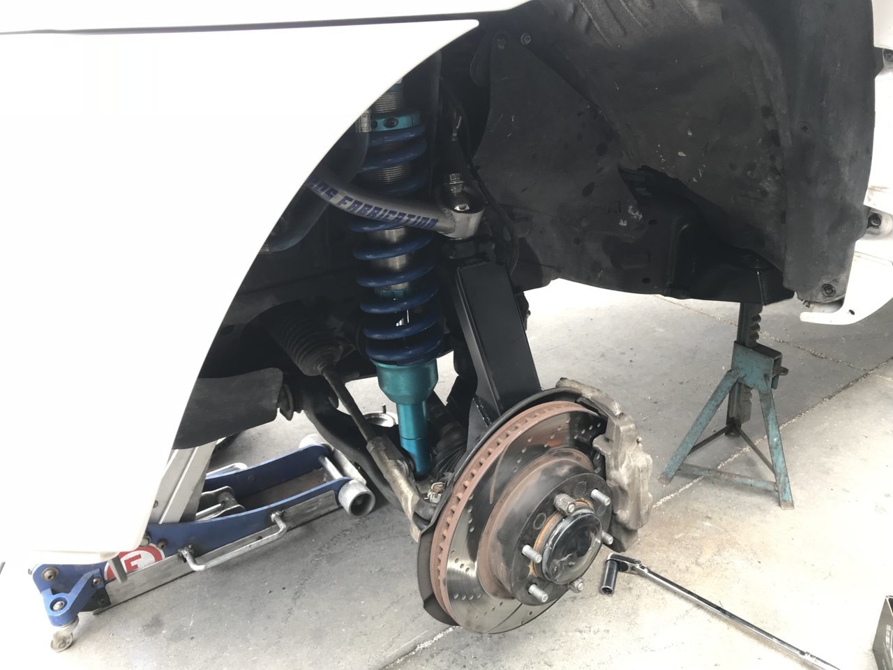

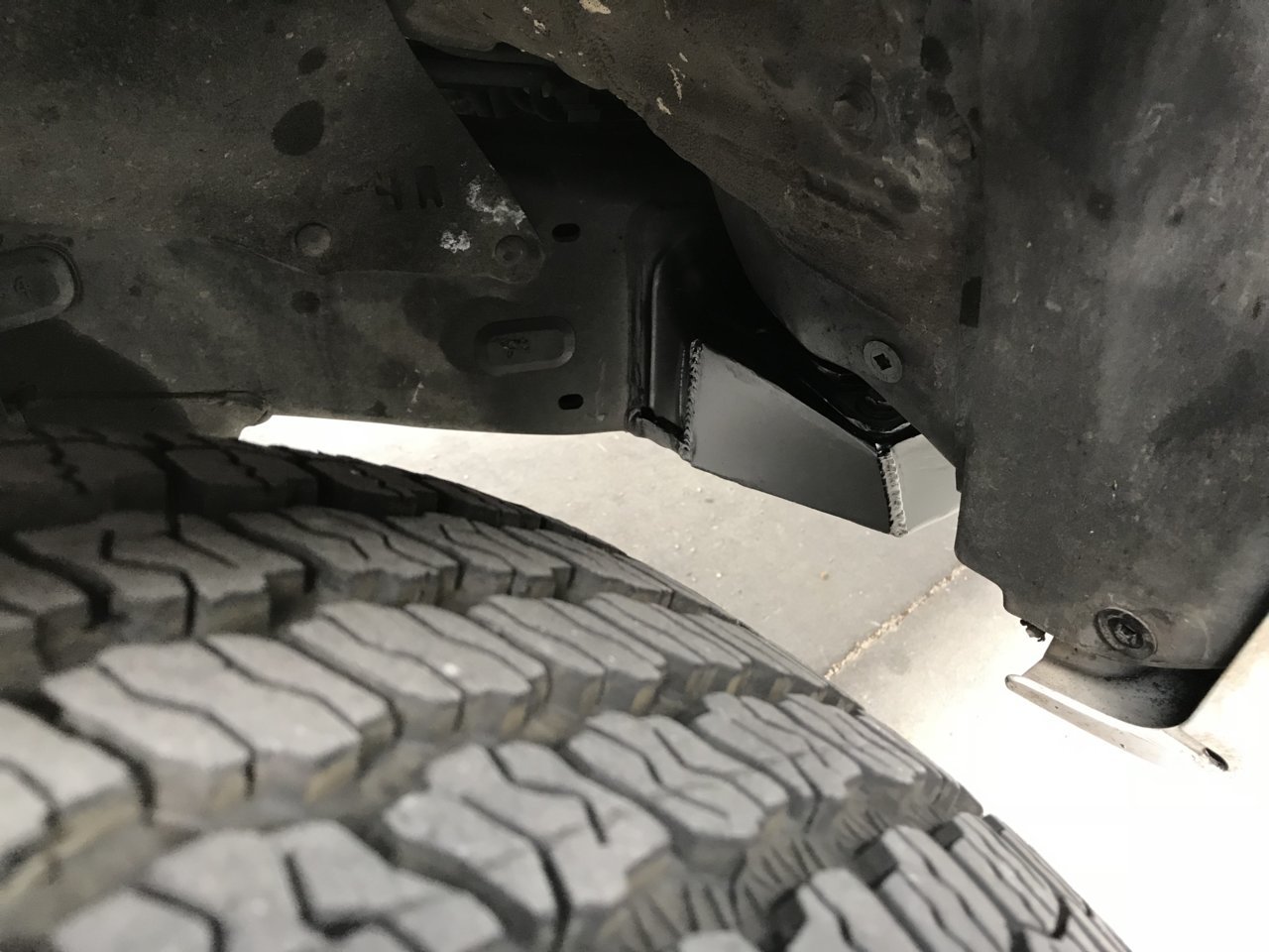

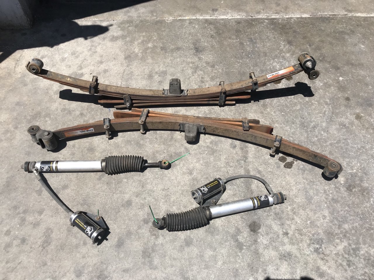

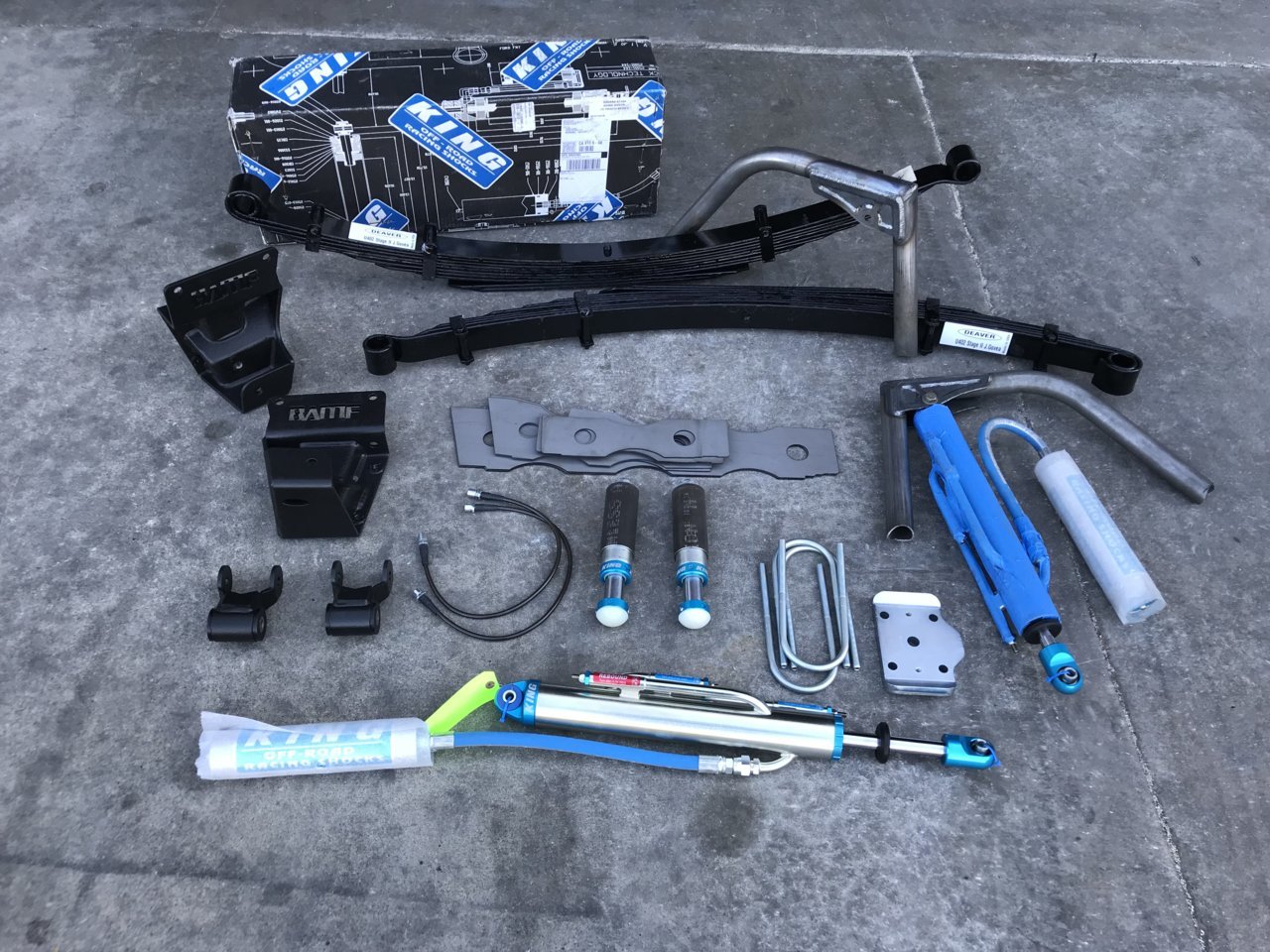

    Super stoked to have @Tyler07 truck back in the shop. Last time it was here we threw a +2 race kit as well all the associated gussets from total chaos and a set of coilovers and bypasses from King. We’ve pieced together parts from a bunch of manufacturers to get the rear dialed in and closer to on par with the front.
    Front end
    Out with the old
    In with the new

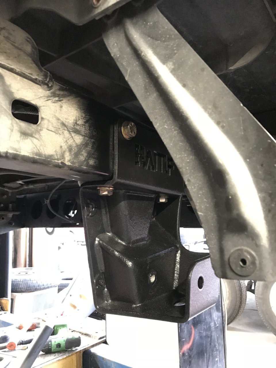

    Bamf rear hangers installed
    Cycling suspension to set up bumps

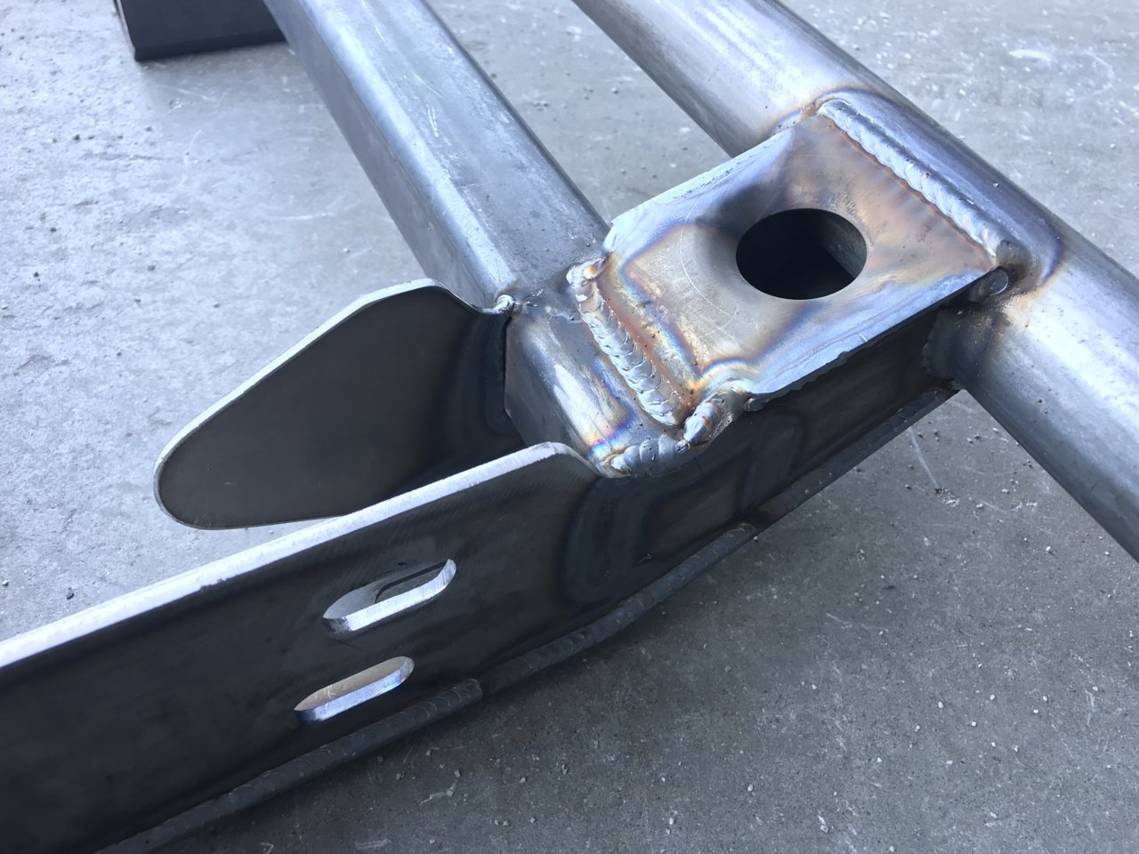

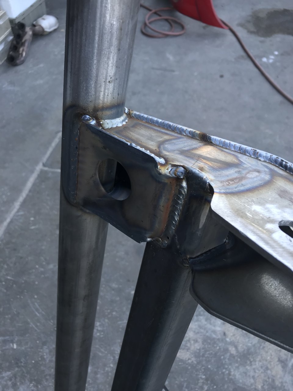

    After many hours of building components for @Tyler07 truck, we’ve cycled and flexed the suspension, now we’re finally welding things to the truck.
    Here’s some weld on bump stops mounts we designed. Bolt on mounts coming soon.
    Got all the mounting pads welded on
    Hoops mocked up
    Hoops pulled for full weld
    Hoops welded to frame
    LOLLY, inesshell, SonnyBones and 12 others like this.
