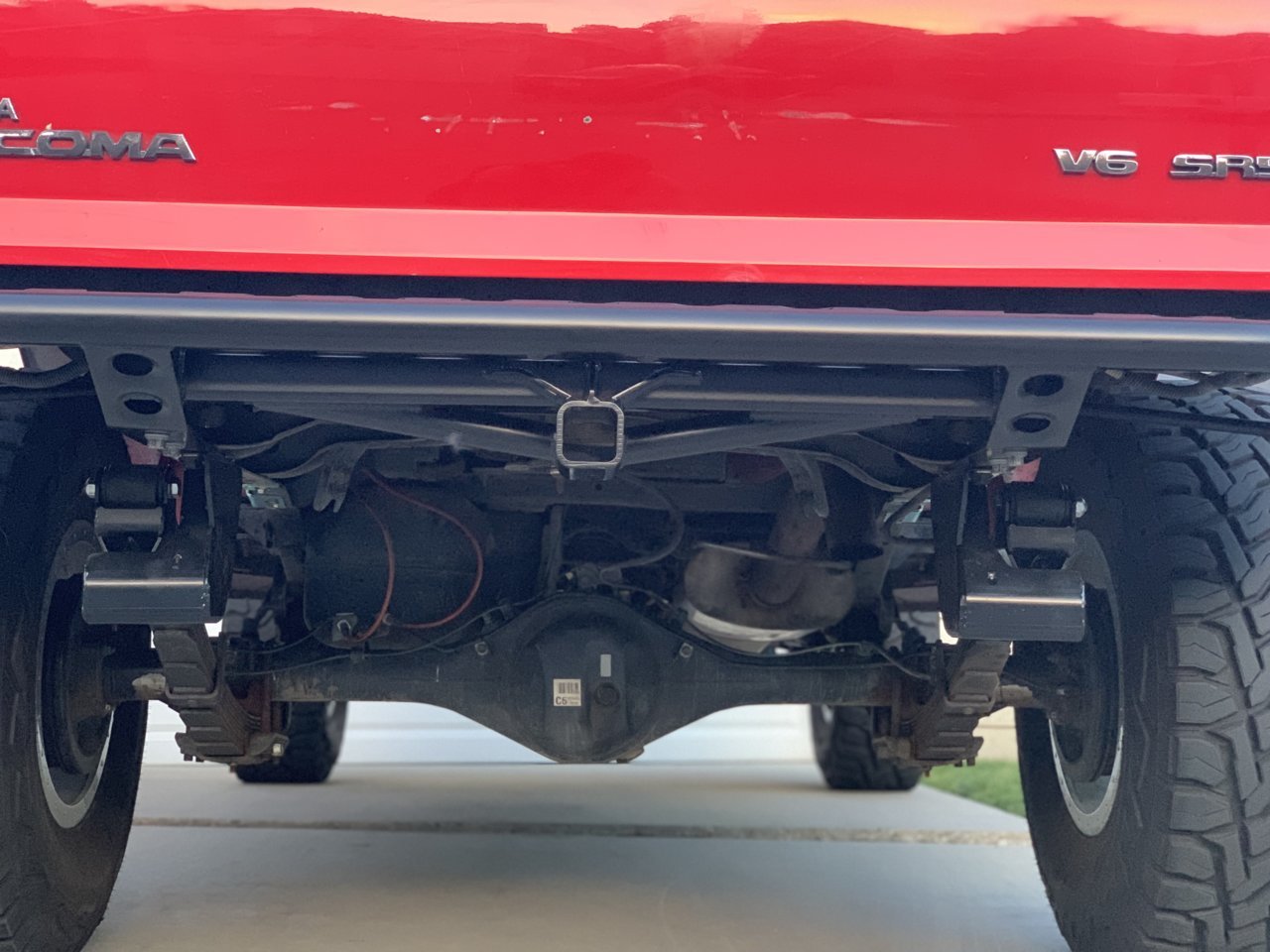

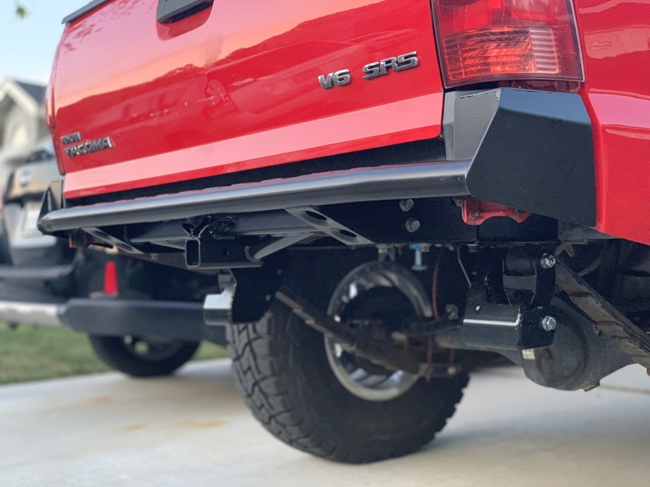

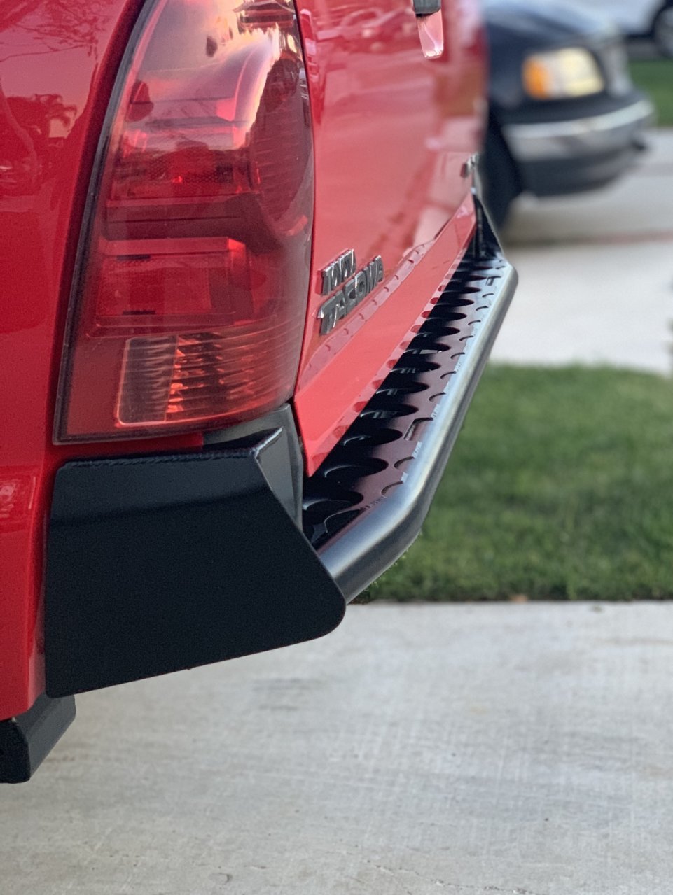

    Haven’t been posting here much since I’ve been super busy, but here’s a few things we’ve been working on.
    Another set of archive hammer hangers installed
    Installed Kings new bump stop kit, hit us up if you want one
    Dust light bracket

    That rear bumper looks so sick Jason!!

    this changes the high clearance game. fantastic design. *totally not regretting JUST installing a heavy ass HC bumper and cutting the besides* sigh

    Thanks Ryan
    Thanks. I definitely think HC bumpers still have their place, it just doesn’t make a ton of sense for how I use my truck. I’m really trying to keep everything light and as always form follows function.

    How much does it raise the hitch?

    I don’t have any exact numbers but the top of the hitch on my bumper sits approximately 1/2” above the bottom of the frame rails

    Bumper looks great! Super clean.

    Damn that rear bumper is clean!

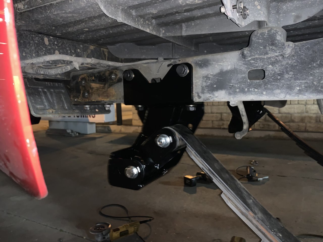

    @ceedless third gen was back in to get the rear suspension upgraded to perform closer to the total chaos +2 race kit we previously installed. We installed a set of deaver u402 stage 1 leaf springs, king 2.5x12 shocks, and archive garage relocation kit, as well as a few various bits and pieces from wheelers off-road. All parts were purchased thru me.
    Also installed a set of archive hammer hangers and built a low pro crossmember to tie them together.

    I like how that cross tube ties in with the stock cross member. :thumbsup:

    Thanks, at least you already got all your chaos purchases out of the way
    I like to incorporate the crossmember, it’s definitely not as strong as it could be, tying into it helps stiffen it up. Pm replied

    Need to incorporate a support bar into my hanger setup. I have some ideas in the works but I'm cutting out the factory cross member and boxing the frame this weekend. We shall see how everything unfolds and what direction I go.

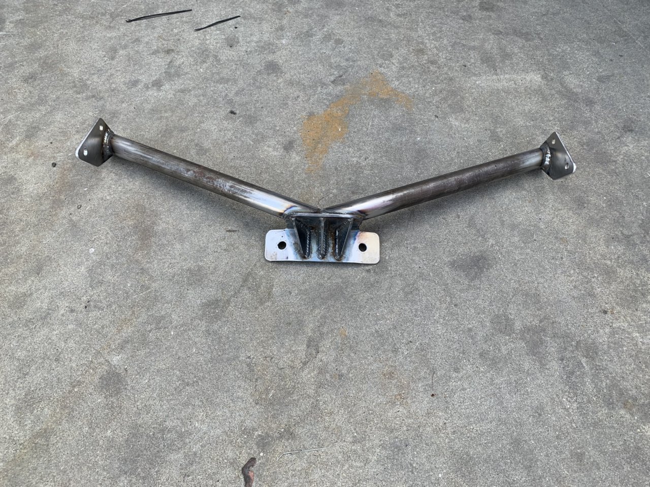

    I still have a few gussets I need to add to mine, but it just a temp setup. Hopefully I’ll have time to install my perm rear suspension in the next 6 months or so. I probably would of gone a little heavier on the crossmember if it was for a customer, but when it comes to my own build I’d rather not over build everything so I can keep the weight being added on to a minimum, that also requires a lot more light weight gusseting to keep the strength where it needs to be. That’s where most of the tig welding has been coming into play. Really can’t build quality parts using lightweight materials without it.

    This was my first experiment in trying to replace parts normally made out of plate with thinner sheet metal while adding extra gussets to make up for the thinner material.
