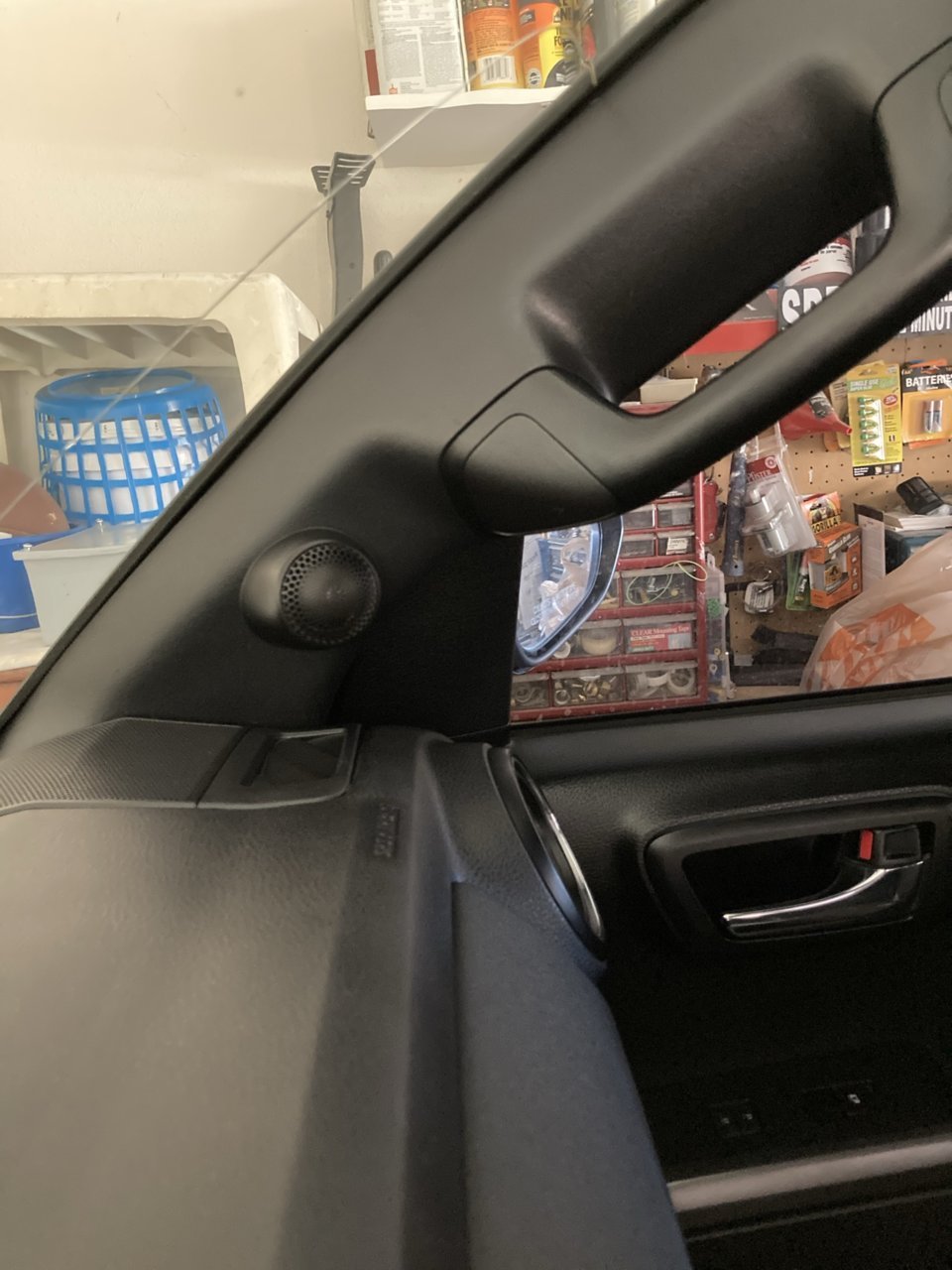

    Morel 3.5 mids fit no problem. I also mounted the tweeter in the A pillar.

    the Morel 3-1/2" mid range in dash location, are they mounted in place with screws? or are they stuffed in there somehow?
    also the a-pillar pods, did you use a drill hole saw?

    i set the mids in the location just to see if they fit. I put the grills on and just ended up leaving them without screws. It does not move around as it is a very snug fit with the grills on the mids. The pods come with the morel tweeters. Used two screws to hold the pod in place and 1/4” drill bit to pass the wire through the a pillar.

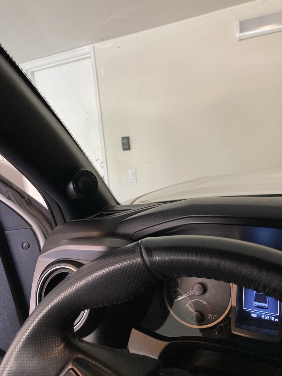

    moved my tweeters from dash to a-pillar although limited in adjustments, it seemed to have improved the tweeter response. I gave up the stealth stock look for sq and don't mind.

    i noticed a difference also. Morel tweeters need to be mounted on axis
