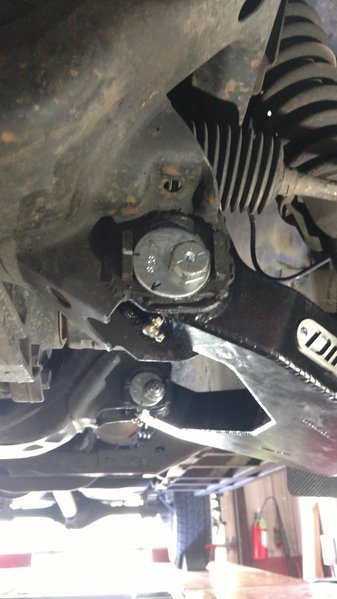

    Yes
    Quite a few shops sell 2nd gen motors mount gusset kits, I got mine from Solo Motorsports. Just an FYI - to weld in motor mount gussets you have to pull your front axles, completely remove the front differential and disconnect the steering shaft from the rack. Also make sure that you tack the drivers side gussets in place then reconnect the steering shaft and turn the wheel lock to lock to ensure that the steering shaft clears the gussets before you fully burn them in.

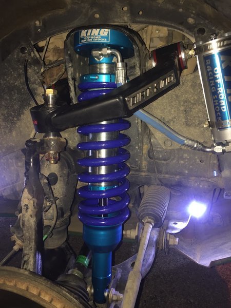

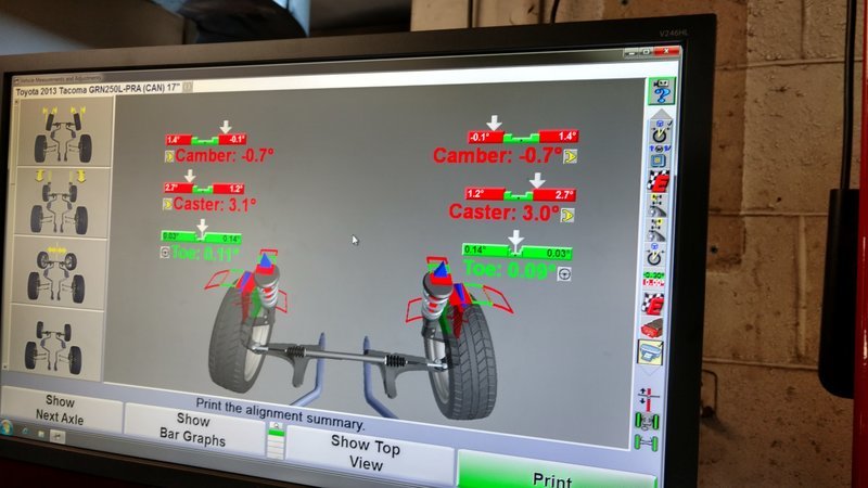

    Dirt King uppers and lowers, alignment achieved.

    Do the LCA's come with new cam bolts or did you install new OEM ones?
  10. May 16, 2016 at 5:57 PM
    #2410
    Arcticelf
    Arcticelf Well-Known Member
    Jul 18, 2015
    #159735
    7,664
    Gladiator
    New Moog grease fitting bolts. I need to screw in the zerk fittings.
    Then I need to fab up my solid mounts and get rid of the cams.
