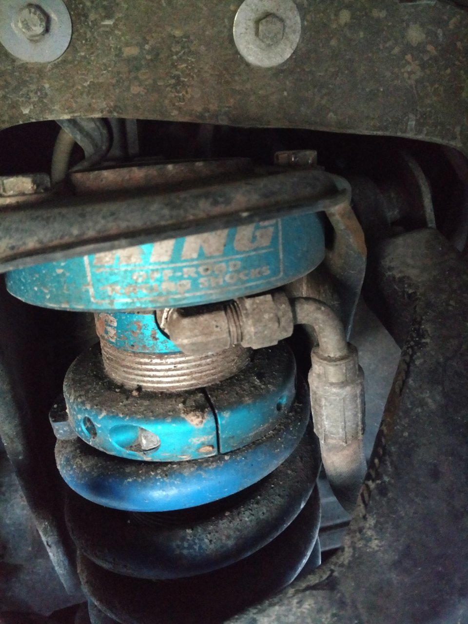

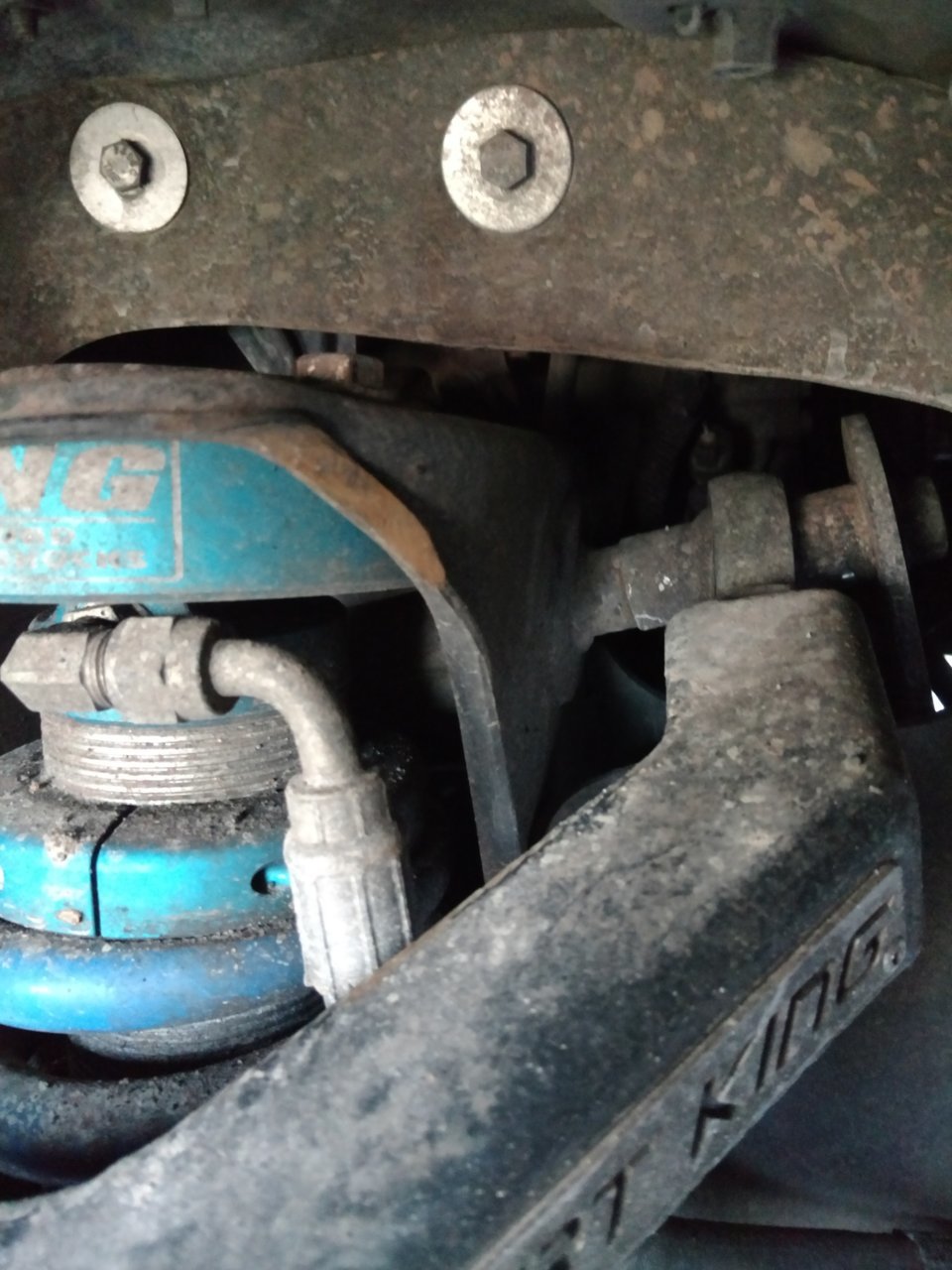

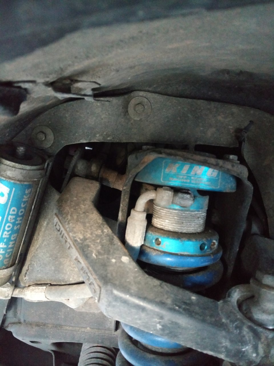

    IMG_20180404_191859343.jpg IMG_20180404_191846068.jpg IMG_20180404_191834581.jpg
    This is why Saint @jberry813 tells us to cycle suspension before putting in the shocks.
    I've got bump travel left in the shocks, and I think in the bump stop, which I know (math is your friend) will be metal on metal before the shocks run out of travel.
    But the UCA hits the shock tower somewhere in there, cycling and adjusting the UCA would have prevented this.
    Bentrodder, jberry813 and IronPeak like this.

    My understanding is it is a design issue with the Boxed DK.....atleast I read some other posts about it, that you end up having to install those straps or some shit to make it all work.

    Not quite enough clearance at full stuff. Didn't happen until I put on the 12" rear shocks, and got extra travel out of the back, which translated to additional travel up front. Oddly i never touched the front bump stop until I got the 12" rears.
    I think they tested it with a stockish rear, and/or they dialed in less camber to make it clear. I'm running -1deg for better cornering.
    My solution will involve clearancing the shock tower.

    Where are your lca's in regards to alignment? Are you able to push the uca out more with the heims and be able to get the alignment in spec still with the lca's?
    And were your shock towers bent before this, or did this bend them?
