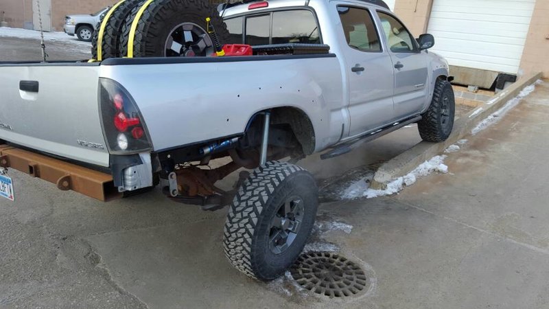

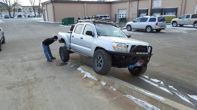

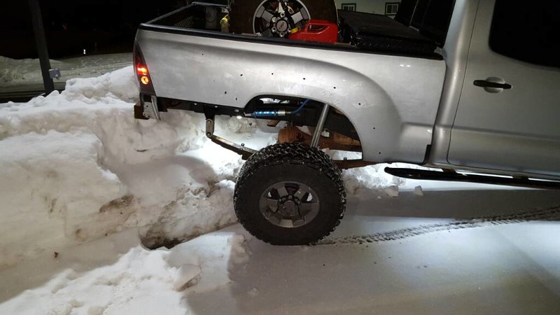

    Bamf shock relocation King 12"s
    shackle flip made by a new shop on here called archive garage a new fab shop i found on tw
    Ome dakars and allpro ubolt flip with timbrens uploadfromtaptalk1453613396915.jpguploadfromtaptalk1453613404729.jpguploadfromtaptalk1453613443138.jpg
