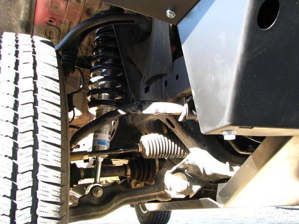

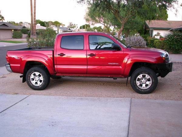

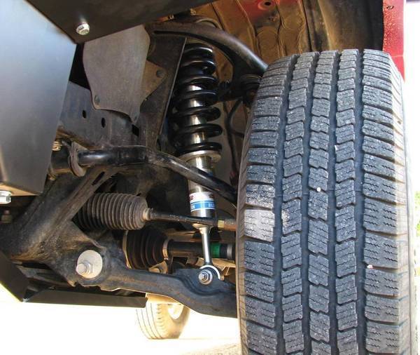

    All Pro Steel Plate Front Bumper| All Pro Light Bar| All Pro IFS Skid Plate| All Pro E-locker guard| PIAA 510 Fog Lights| Hella 700FF| Fox 2.5 Coilover| Bilstein 5100 on the rear| BHLM| Grill Craft MX Series insert| Added two D-rings to bed|AVID Off Road sliders| AFE Dry Flow S| Gibson Cat Back| Custom Bedbar with hilift mount| Camburg 1" Uni-Ball UCA's| Hi-Lift 48" Extreme
    I want your wheels and grill!:D
    Pics for OP, I'm set at 1.75

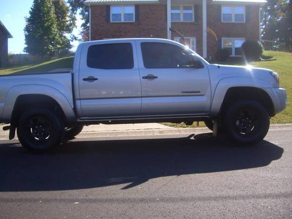

    1.75 and rear TSB. Parked on an incline.
