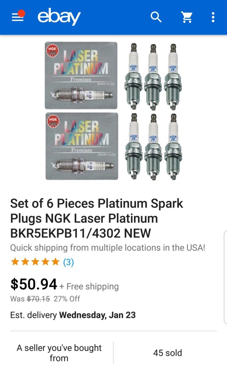

  14. Dec 19, 2019 at 4:02 PM

  15. Dec 19, 2019 at 4:04 PM

  17. Dec 19, 2019 at 4:05 PM
    #17
    frenchee
    frenchee Favorite Member
    Aug 4, 2015
    #161024
    2,131
    Oceanside CA Area
    2003 Tacoma TRD Double Cab 4x4
    Converted to 4WD DD VW MK6 TDI
    Is there a good thread on plugs?
    I looked a while back and couldn't come to a conclusion on what I should order
  18. Dec 19, 2019 at 4:10 PM
    #18
    jbrandt
    jbrandt Made you look
    Feb 12, 2011
    #51038
    17,612
    Justin
    El Dorado, CA (NOT El Dorado Hills)
    '04 TRD Tacoma 4x4 DC
    Kings, J59's Total Chaos UCAs Custom skids Sticker mod
    I'm sure a lot people have some sort of magic plug with "diamondfire technology" (lol) that supposedly gives them like 40 more hp or whatever, but just get whatever your manual says to get.
    This is a sticky on the first gen main page:
    https://www.tacomaworld.com/threads/how-to-replacing-spark-plugs-and-wires-on-5vz-fe-3-4-v6.261034/
    I think Denso or NGK

  20. Dec 19, 2019 at 4:17 PM
    #20
    El Taco Diablo
    El Taco Diablo Professional Pinstriper
    Nov 6, 2017
    #235223
    13,979
    Matt - KN6DZP
    Hughson, CA
    Impulse Red DC, 5vz-fe, 4wd swap, LT, dual case, F/R locked
    Just 3 tons of fun!!!
    I did these... and NGK wires, around 30,000 miles ago. I've been happy with them. Seemed to make a difference.
    I wouldn't say they are magic... but they seem to work well for me.
