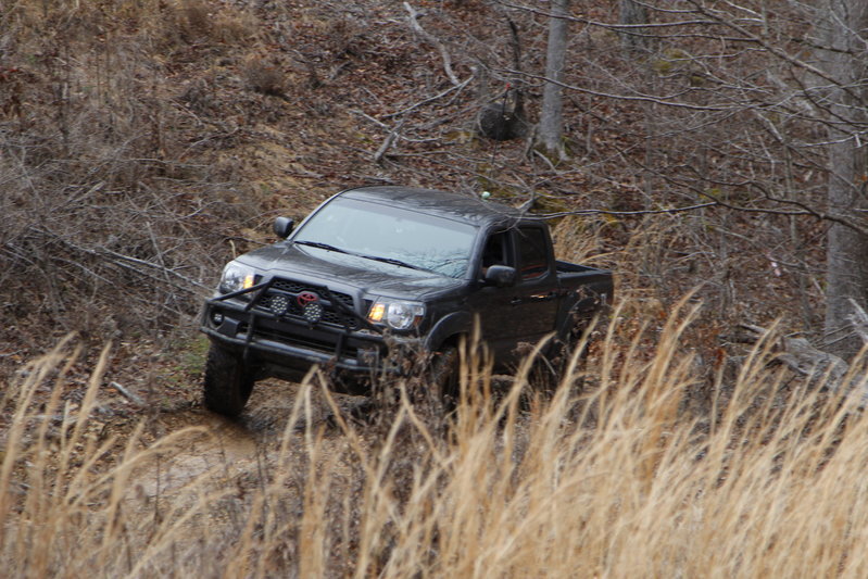

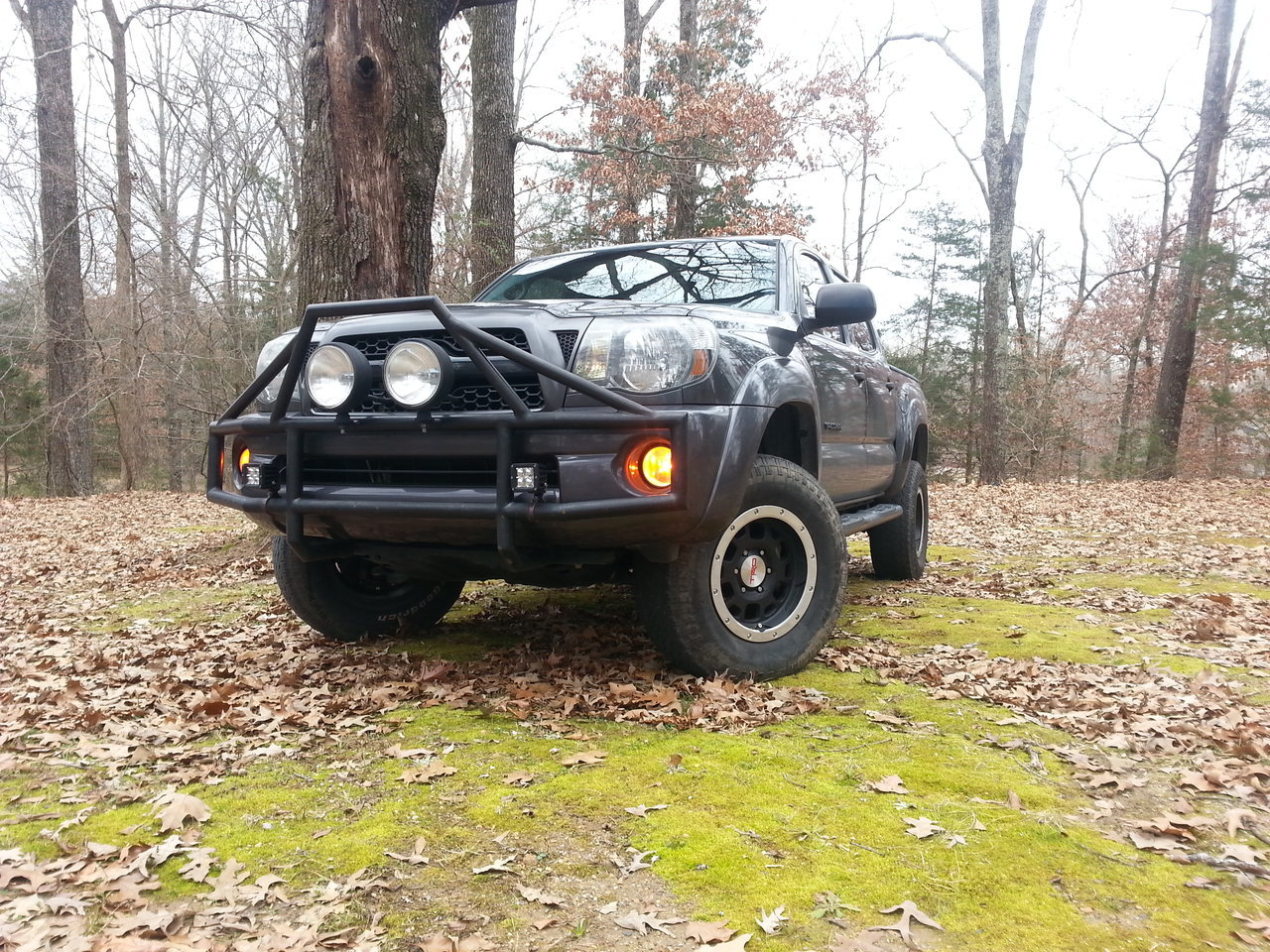

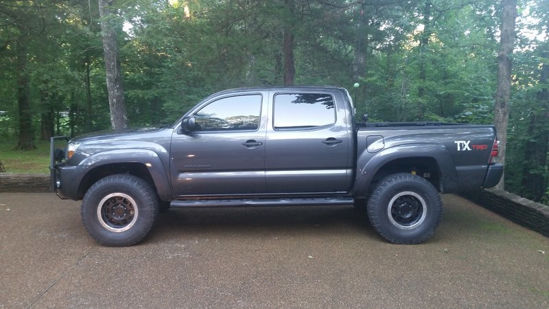

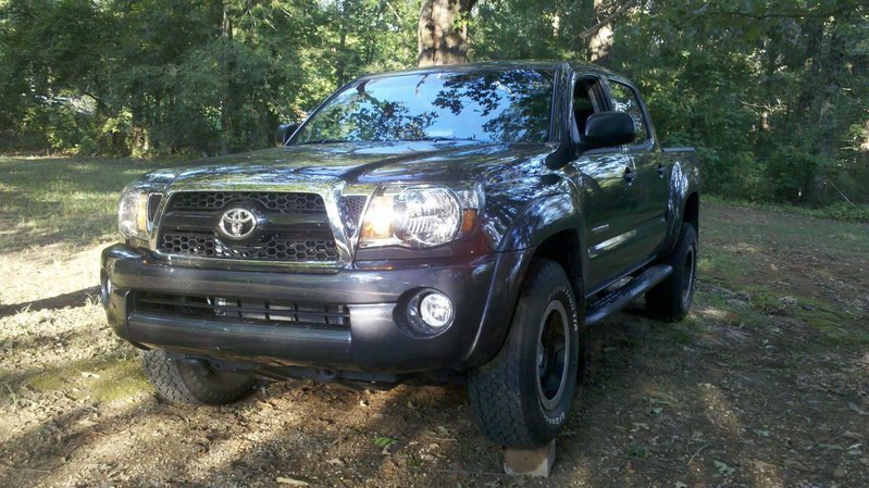

    This is it's first time "offroad" a couple weeks after I got it

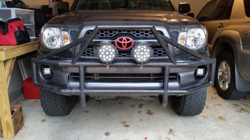

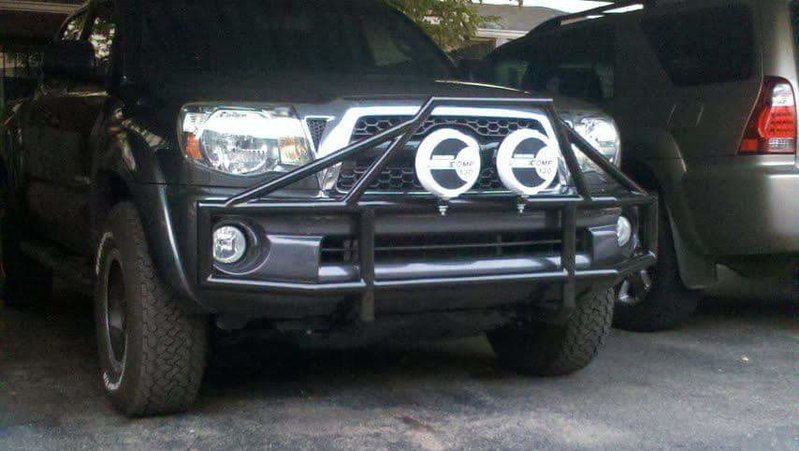

    This was the day I put the bumper bar on. I designed it on paper, and a friend of a friend welded it up for me. He didn't have a pipe bender, so he had to weld all the pieces together.
    March 2014 was my first real wheeling experience. I learned alot this trip..... including learning to just follow the ruts, being confident in my truck, and how/when to use my locker :anonymous:
    don't try to straddle, just follow the ruts because you end up there anyway.

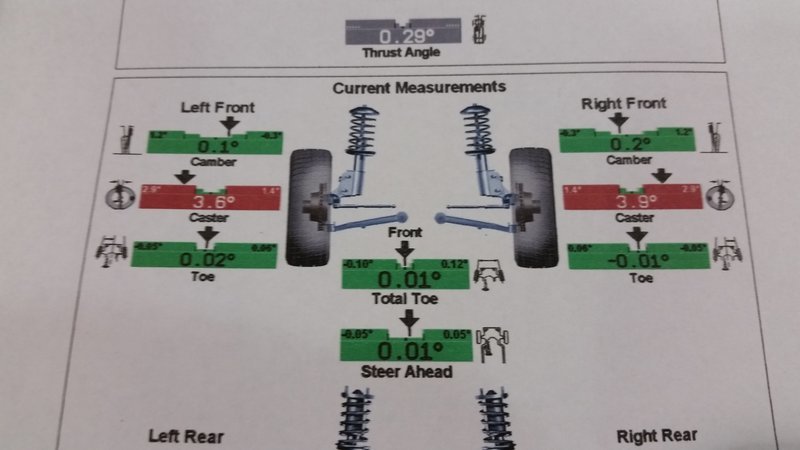

    Then I finally pieced together a lift! I installed it in January of 2015. 5100's set at 2.5" with stock coils. No install pics, but this was taken shortly after. Still had stock 265/70/16 Rugged fails :rolleyes: ....got some half used 285/75/16 BFG KO's about a month later from a TW member in the Tn thread.
    Ran it that way until August 2015 when I got new coils, used SPC LR uca's from another TW member, 3 degree rear shims, and the u-bolt flip kit. I cut out the old uca bushings, cleaned the uca's up, repainted, and rebuilt them with new spec ride bushings and new ball joints... so essentially had brand new uca's. I actually took install pics the second time around :)
    ditched the swaybar and aligned it.

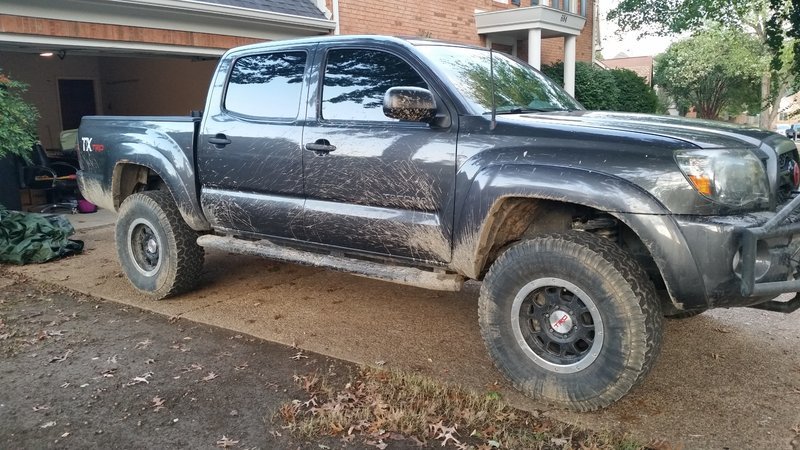

    Dirty Driveway shot at my new house (Oct '15)

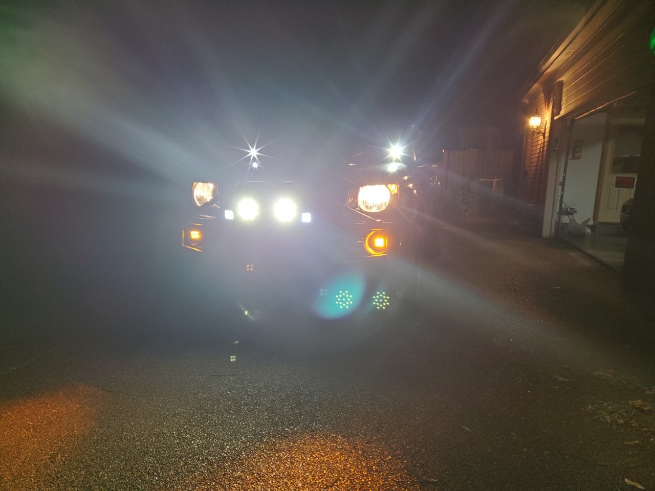

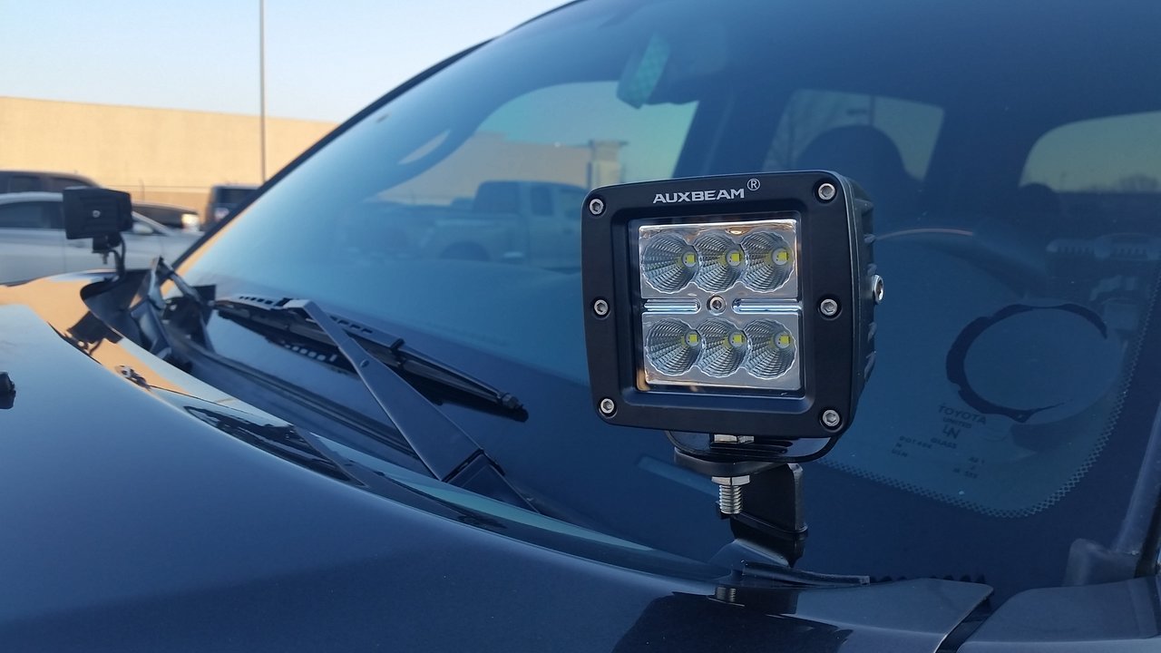

    Ditched the outdated Prochump 130's for some better, brighter 51 watt Tuff LED spots :cool: (May 2015)
    Added some Auxbeam 20W hyperspots in (late Dec 2017)
    And Auxbeam 18w flood pods on Relentless Fabrication hood hinge brackets (early Jan 2018)
    Lighting Comparisons:
    Low beams and duallys
    High beams with duallys
    The 2 7" Tuff LED spots only
    All front lights

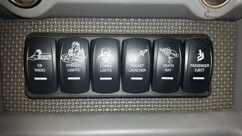

    and my switches
    left to right: Cb, rear lights, ditch lights, front hyperspots, 7" 51W spots, and air compressor

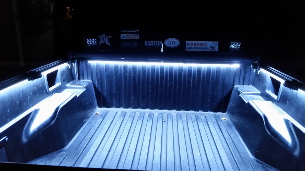

    Bed lights
    Interior floor lights

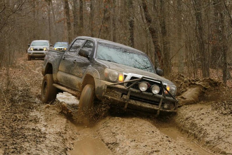

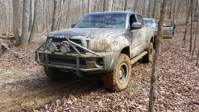

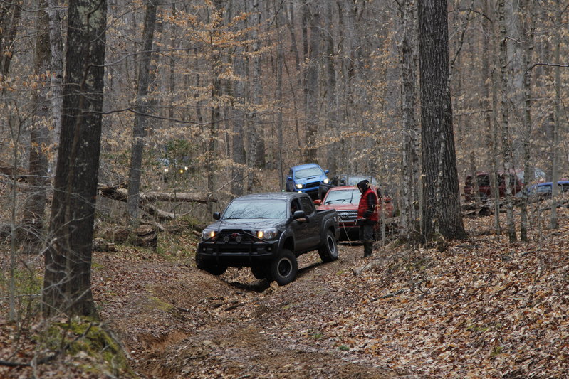

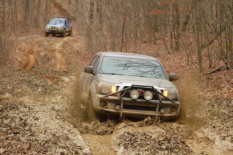

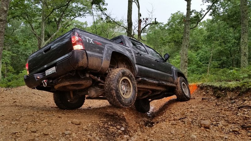

    wheeling pics :mudding:
    March 2014 - Land Between the Lakes, Ky (stock)
    March 2015 - LBL, Ky (lifted & 285's)
    June 2015 - Turkey Bay, Ky
    March 2016 - LBL, Ky

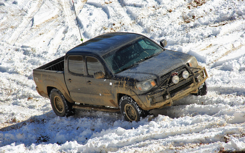

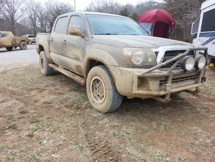

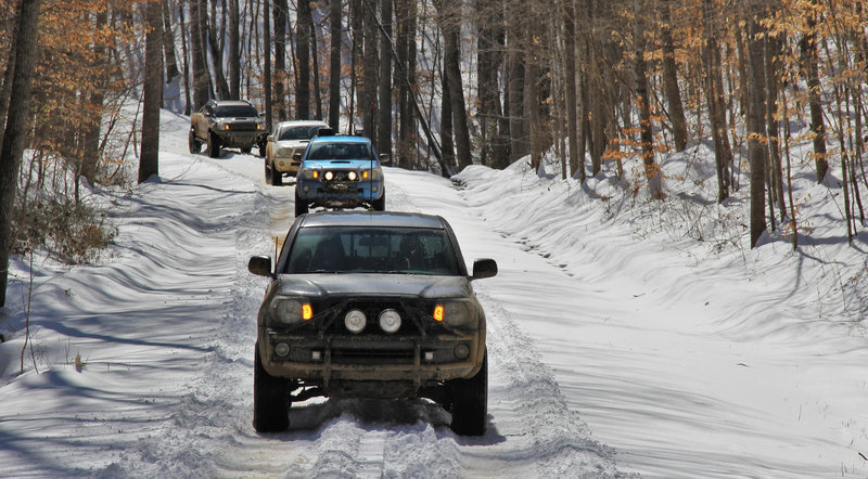

    March 2017 - LBL, Ky
    November 2017 - Adventure Offroad Park, Tn
    March 2018 - LBL, Ky
    March 2019 - LBL, Ky (I showed up late and didn't take any pictures. the following is not my picture, but proof i was there :rolleyes:)

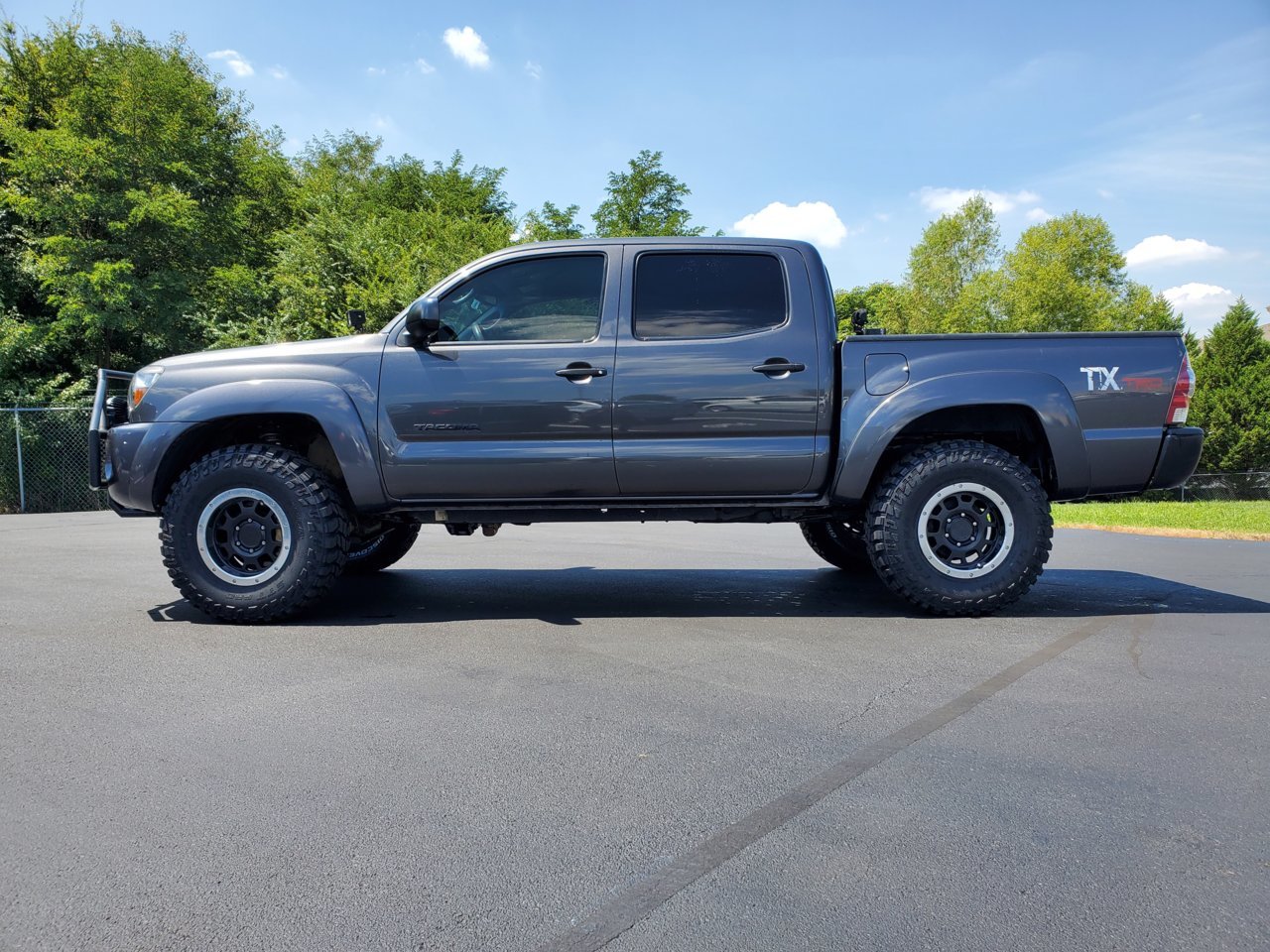

    Lift, 285's, mud, and scratches

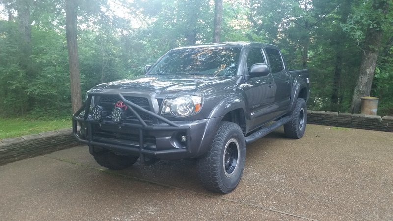

    Scenic driveway picture while visiting my parents. I realized that i don't really have a full shot of my truck while it's actually clean....ish.20160605_192426.jpg 20160605_192457.jpg
  19. Jun 5, 2016 at 6:13 PM
