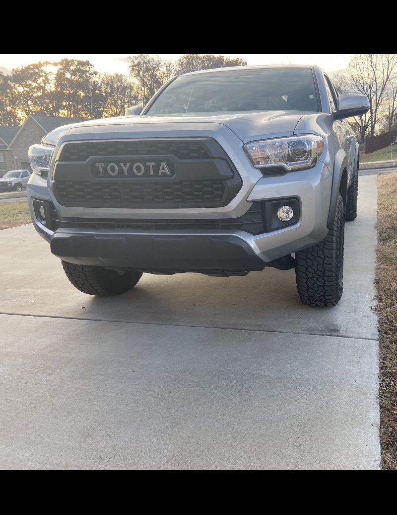

    Hey guys I was thinking about purchasing a mild lift for my TrdOR RWD..
    I don’t take the truck off-roading that much and if I do, it’s maybe some light stuff (i.e- gravel/sand trails mild-moderate hills) to get to a fishing spot, launch my yak or do a little exploring. And surprisingly, even when I got into mud, the diff lock did the job!
    I was also thinking on adding 1.25 spidertrax spacers as well.
    Thoughts on a spacer lift/block combo for around $120-130 (rough country 2” FR-1” block rear)?
    Or
    If you guys have any other suggestions..
    thanks

    OP I did the same and it works great. Avoids diff/cv issues and brings the truck up. I have full skids and sliders so it helped me gain back what I’d lost then some.
    personally I’d skip the spacers and go with 255/85’s

    I am running with 265/75/16 wildpeak at/3s, which is slightly larger than the original tires.
