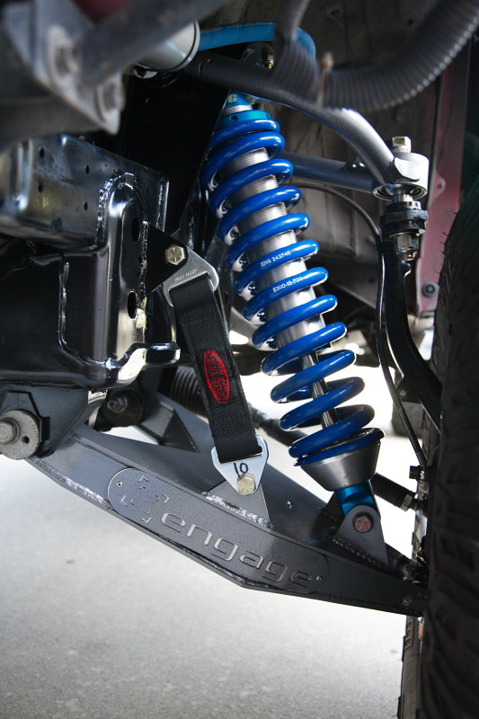

    Engage Offroad long travel front and rear with some fat tires.
    if from L.A., your best bet is to meet up with those of us in the area who wheel in the terrain you are likely wheeling in...
    even for mild wheeling in the so cal desert, you will want to invest in something a bit higher end than the budget stuff...
    whereabouts are you wheeling at?
    i am up in the Glendale area and i hit mostly Lucerne, Barstow, and the Mojave...
    you are more than welcome to roll with our crew sometime out there... we just went out for the M.O.R.E. Balls Out 250 this past Saturday and we are planning to do the Mojave Road run from Barstow/Calico to Stateline in the dirt this coming weekend... that will be a 2 day trip...
    our next day trip will be Saturday 4/4 for the MDR race in Barstow...
    here is the suspension on my truck...
