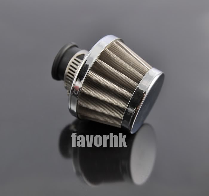

    X2 I did a valve cover filter for my breather in the engine bay No no vacuum can be created in my setup.
    It way like 6 bucks on Ebay

    Putting a 2 way breather in place of this one way one in your picture (up higher at the end of a hose), is what eliminates a vacuum that would cause water to get it. Why does Toyota do this on the front diff., if not true? (of course, why don't they do it on the rear??!!):eek::rolleyes:

    Water is not getting in through the factory breather... Relocating is only a waste if you put the same one way breather on the end of the tube... You must use the same breather that Toyota uses on the front (or a filter)... to allow 2 way air movement.
    The purpose of the different breather, re-located, is to break the vacuum so water doesn't suck into the diff. past the axle seals.
