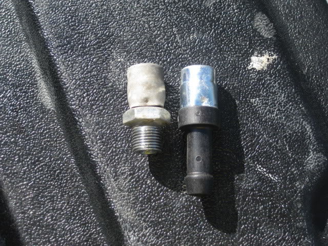

    Thank you for explaining it in better words than I used... I may have tried to over-simplify it (or made it more complicated).
    Blue, thanks also... and I wouldn't hesitate to back you if I see someone mis-understood you when you are correct, either.
    I posted my way of understanding the action of what happened to my differential in Baja on our Mision Santa Maria run in 2010.
    Obviously, our gears were extremely hot after 3 hours of mostly low range/ locked or A-TRAC type of road... then we had the deep water bog to drive in. This was my 4th trip to Mision Santa Maria, and the water was never close to being that deep before, so it was a surprise.
    When I got back home and took the Tacoma in for service, they reported the rear diff. was contaminated with water. In reading about the breather mod., it was TW posters who explained what the process was... that the water enters at the axle and not the factory stock rear breather, which is a one way (out only) check valve. I didn't make it up...
    When I did the mod, I confirmed by blowing on the breather that with some pressure I could unseat the spring loaded valve, but at 0 pressure, it is CLOSED in both directions and is impossible to force air/ water into the diff. past the rubber seat. The only way that check valve could let water into the diff. is to remove the spring and or the rubber seat... or if the seat is damged.
    Now, instead of a dirty rear breather taken apart... here is what my breather looked like, next to the new 2 way breather used in the mod (which is what is used on the front diff.!):
