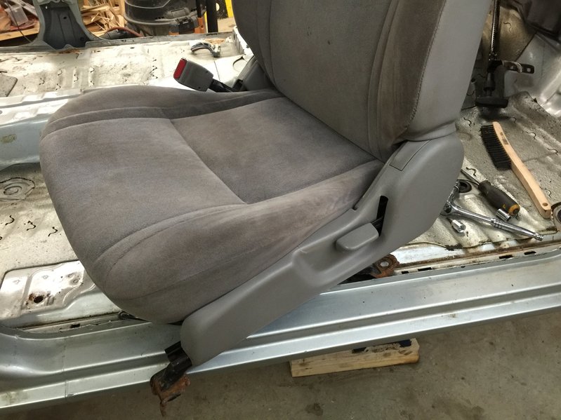

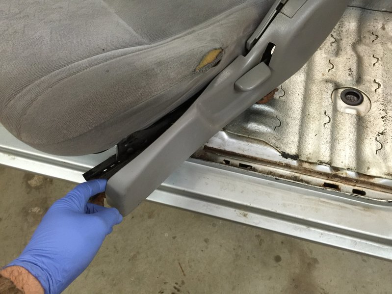

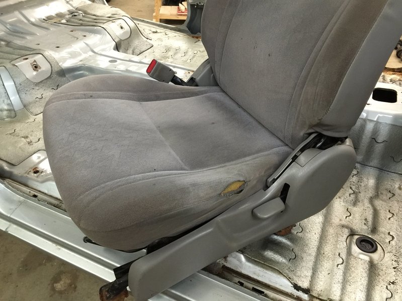

    Among other things today, I replaced my drivers seat bottom as it was ripped. The side plastic was no longer staying in place because the back tabs had been broken by a short person getting in a lifted truck and not sitting on the seat but on the side plastic.

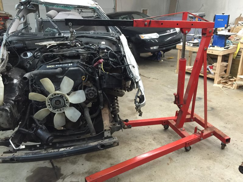

    Not too much has been happening in the shop lately. However I plan on putting a big day in the shop tomorrow and hope to have the engine, tranny, transfer case and a few other parts off the parts truck and ready to go in my truck asap.

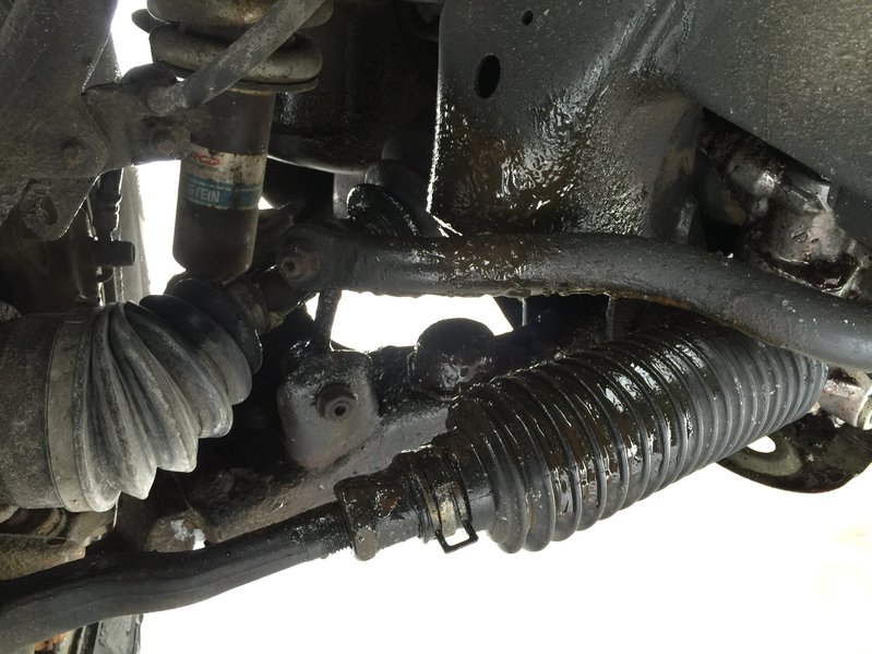

    Does anyone know what could cause both axles to vomit grease all over the place?
    The previous front diff/axles did not do this.

    Torn boots?

    Boots look good.
    Strange

    They're blown bro. Need to rebuild (messy but that hasn't seemed to slow you down) or buy some new ones. Lots of generic brands that offer lifetime warranty for under $100. They're not as well built as OEM but unless you are off-roading, they should be ok.

    By blown do you mean they need to be disassembled, cleaned, regreased & rebooted?
    Any idea what could cause them to go pretty well immediately after installing them from the parts truck?
    My truck is lifted but the parts truck was not, could the different usage angles have caused them to go?

    Yes on all accounts. Dry rot reared its ugly head when those boots were forced to stretch and bend to new and likely greater angles. Happened to me too, pretty darn common really. New neoprene boots for all four (both sides inner and outer) can be had for about $60 on rock auto from the brand Moog. Then the special crimping tool for the clamps is another $9 on eBay. The hardest part is cleaning and regreasing, because you have to pop the tulip joint off to get the boots on.
