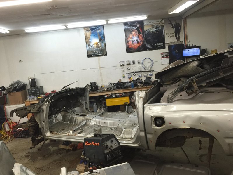

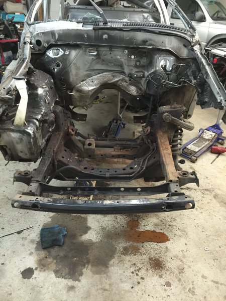

    After spending much of the day in the shop I find myself not much closer to having that engine and tranny out.
    The engines I have experience pulling and installing are out of honda civics and integras.
    The engine/tranny/transfer case combo in the tacoma is a lot larger and different.
    I've done some research in the service manual to help me overcome some issues I was having and will give it another go tomorrow.

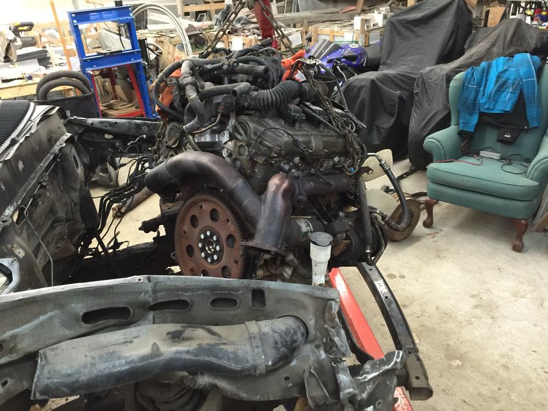

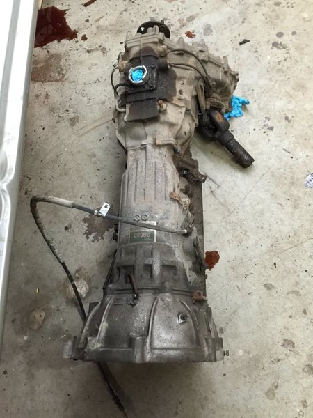

    It has been accomplished!

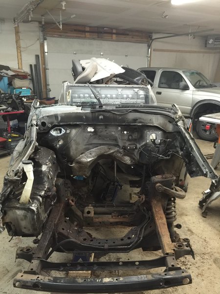

    And immediately after removing the engine and tranny I thought, "lets make this thing a convertable!"
    This seems like logical thinking no?

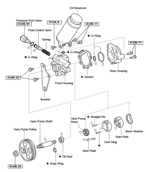

    Your bearing in the pump could be shot...same thing happened when I had a Subaru. Hopefully Toyota's different, but Subaru doesnt offer a ps pump rebuild kit. New ones were like $400 US and it didn't sound like off brand ones were up to snuff. I had fun taking it apart, and a new bearing did the trick for me.

    Breakdown of PS Pump

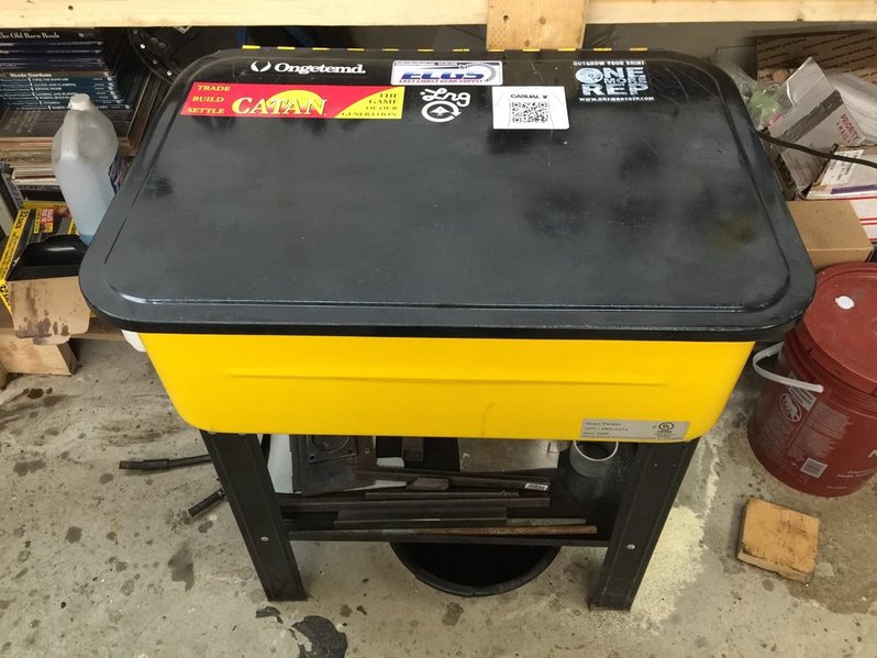

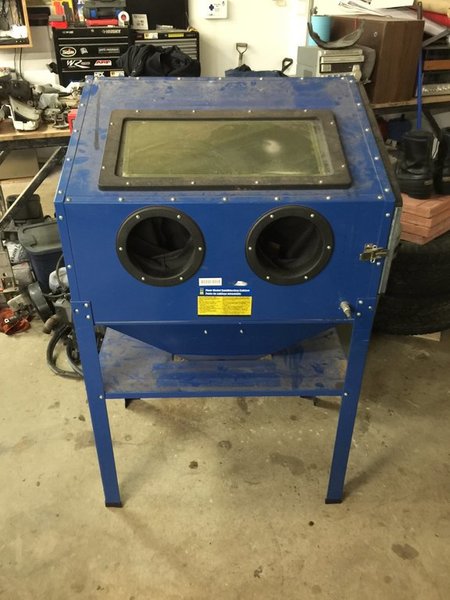

    I have a couple of new to me toys for the shop. Looking forward to cleaning up some of the parts I pull off the parts truck!
